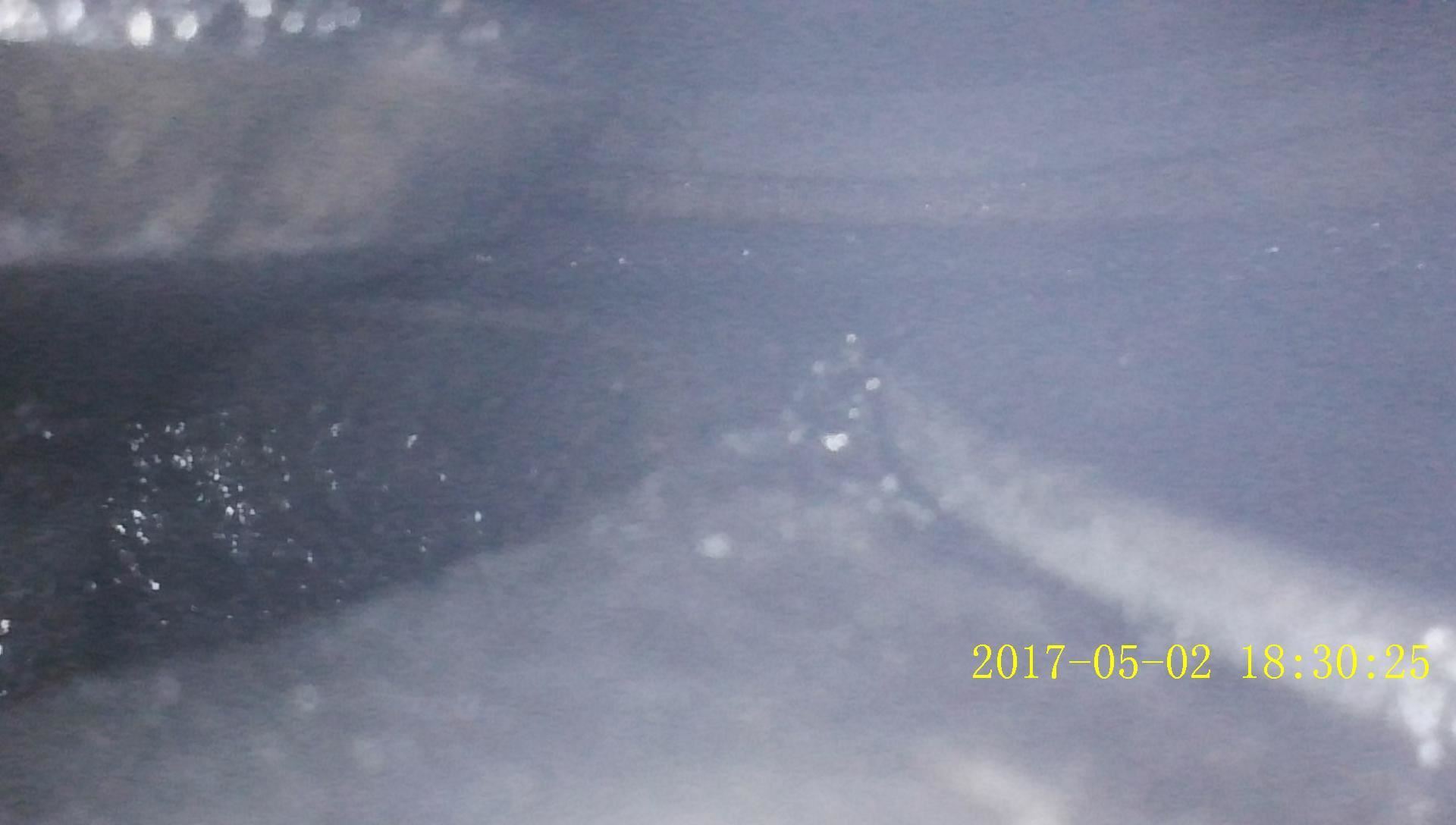

I looked at the andoscope camera and the cylinders seem to be in good condition.
I did not adjust the valve clearances, I did not want to touch them at this time until I have done all the necessary tests
The spark at the plugs is clear and white/blue
Tonight I will try to film the position of the valves in operation in the cylinder with the andoscope camera

I'm sending you a video and photos, in the photos when the valves are at their highest it is their closed position

It is really hard to tell much with that much magnification. It looks like some pitting on the valve faces and maybe some debris or rust pits on the seats. If there are loose pieces of carbon or rust on the seats, it would account for low compression. You might try staking the valves. That would require removing the rocker shaft and tapping the valve hard enough to cause it to come off of the seat using a soft lead or hard rubber hammer. Or just pull the head and have it serviced.
