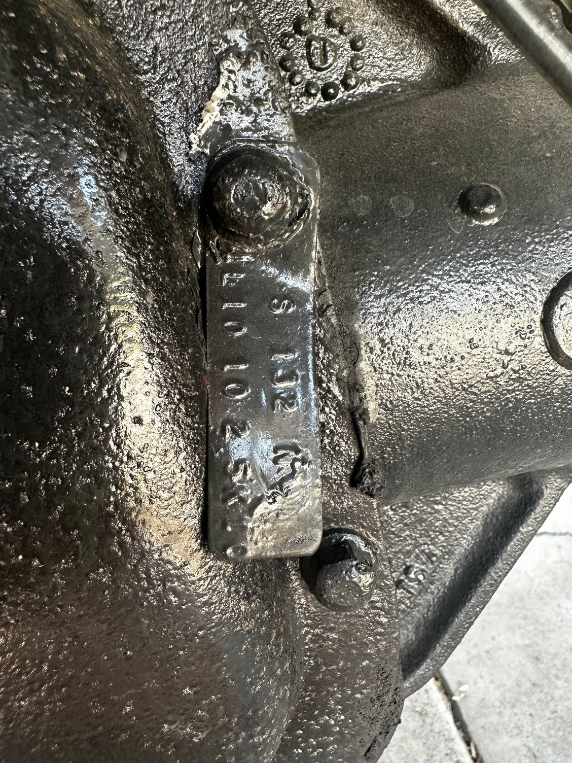

Curious if anyone can give me more information about this Sterling in my 1996 F250 7.3
Tag Reads
S 132 N
L 10 10 2 5K 10
Thanks!

4L10 = 4.10-1 with Limited Slip.
The "S132N" Comes up as F-250 '85-'98 or F-350 '93-'96
4L10 Is 4.10 gear ratio with limited slip
Identified as sterling 10.25

S132N Ford F250 Pickup '85-98 over 8500 GVW
Ford F350 Pickup 93-96 4.10 10.25 L
https://www.fordification.com/tech/rearends_ford10.htm
