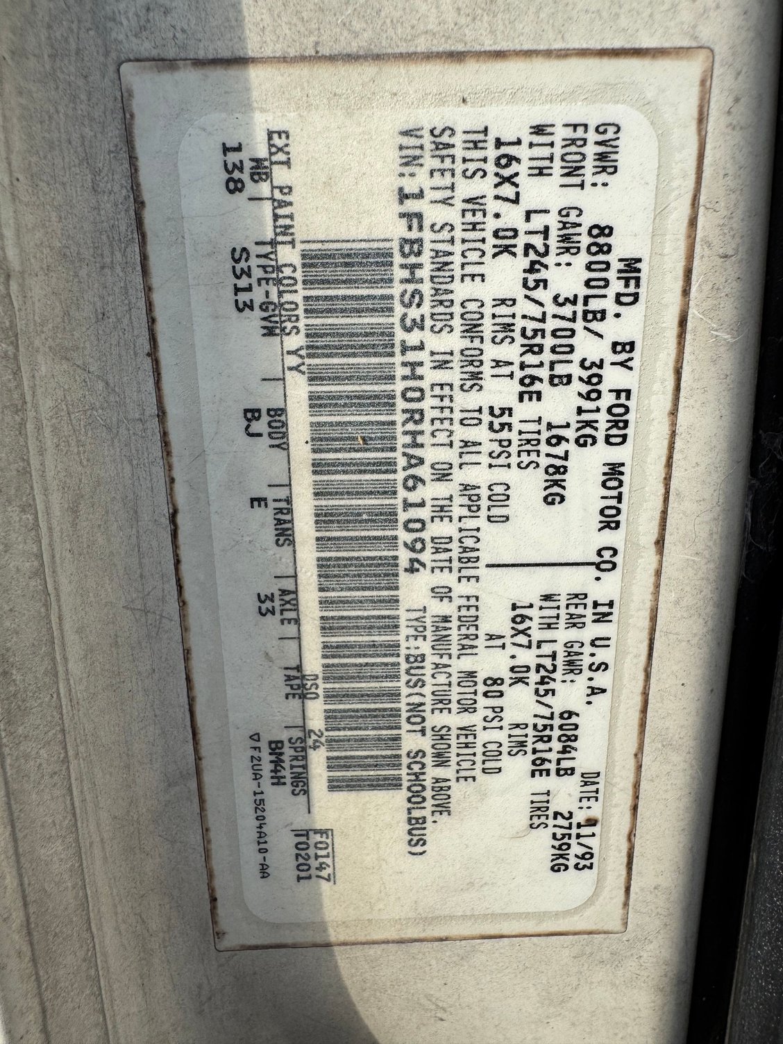

Hello to everyone here I appreciate every member here and all of your comments very helpful. I have a 94 super club wagon. I cannot identify what type of transmission is in this vehicle. I need to replace it ASAP. Can anyone help me or let me know what would be a suitable matching replacement. I have an 03E 250 but I don’t believe that transmission will mate. God bless and appreciate any help.

trans code "E" is for the E4OD automatic trans

thank you I thought that was the E4 0D I have a 2003 5.4 with the E4 0D will it mount to that 94 E4 OD if not, do you know what transmission possibly would thank you so much for the reply

The last year for the E4OD was 1998. The 2003 has a 4R100. And a 1994 van won't have a modular engine, so this trans won't bolt to the engine.

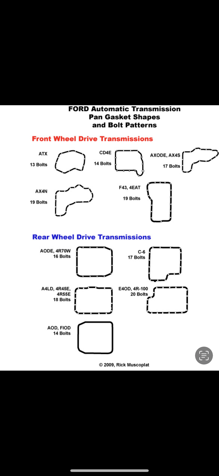

Hi,
maybe this pic I found on another thread will help

you need an E4OD off a 5.8, 5.0, or 4.9 in line six cylinder 1989 to 1986

Yes, the E4OD. Anything else is going to need a lot of modifications to make it work.
