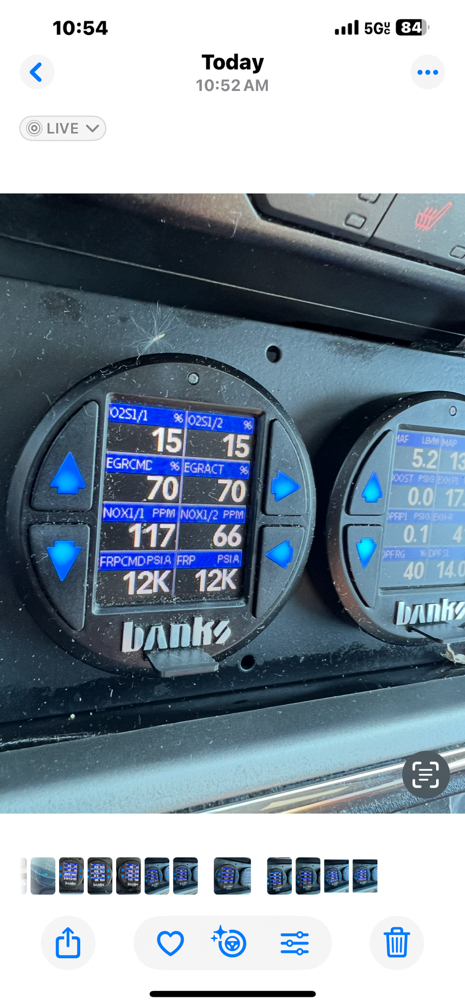

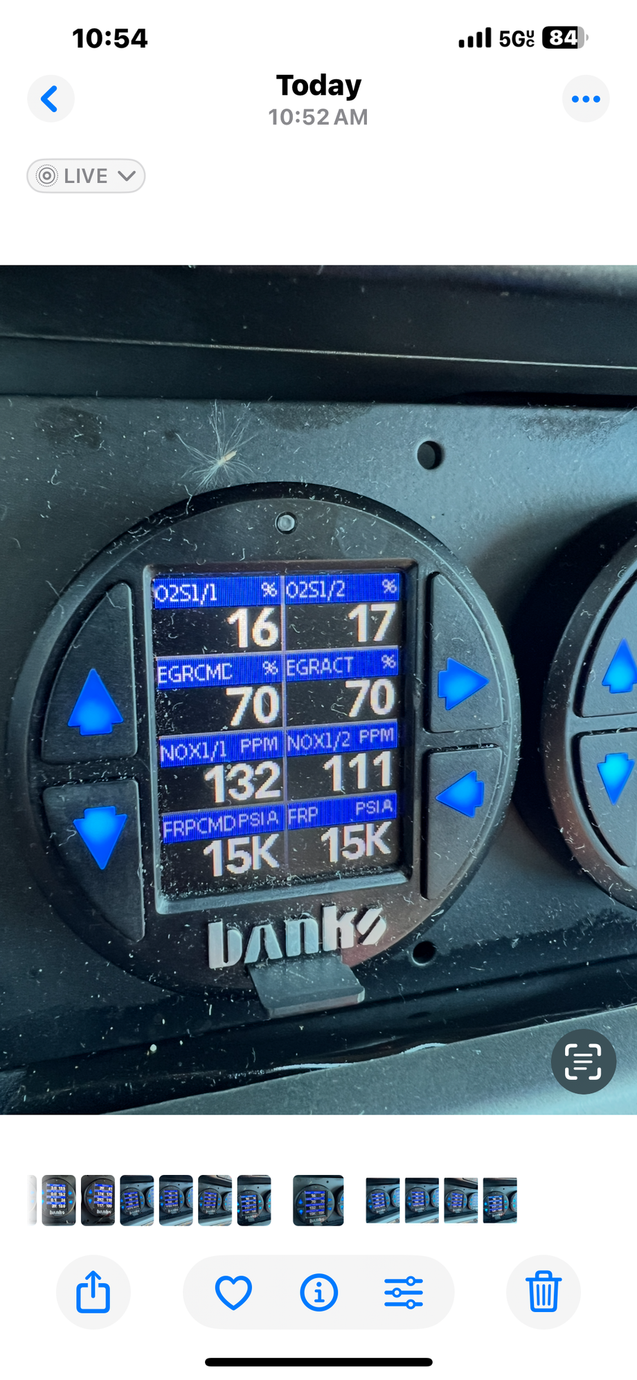

Here’s some is and box numbers to compare
warmed up engine
37 degrees out
O2 is the first row
nox is the third row
bank1 / bank 2
at idle
at 1000 rpm
at 1500 rpm
at 2000 rpm
at 2500 rpm
vehicle is stationary in all cases above.
For the folks having this trouble code, i would be curious of your O2 bank 1 / bank 2 numbers at different rpms .
