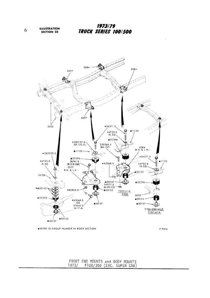

Thinking about what is next up for my 1975 F250 highboy and I am contemplating swapping out the body/radiator core mounts.
Any suggestions/recommendations to accomplish this.
More importantly does anyone have the appropriate tool made up to pull the old mounts off?

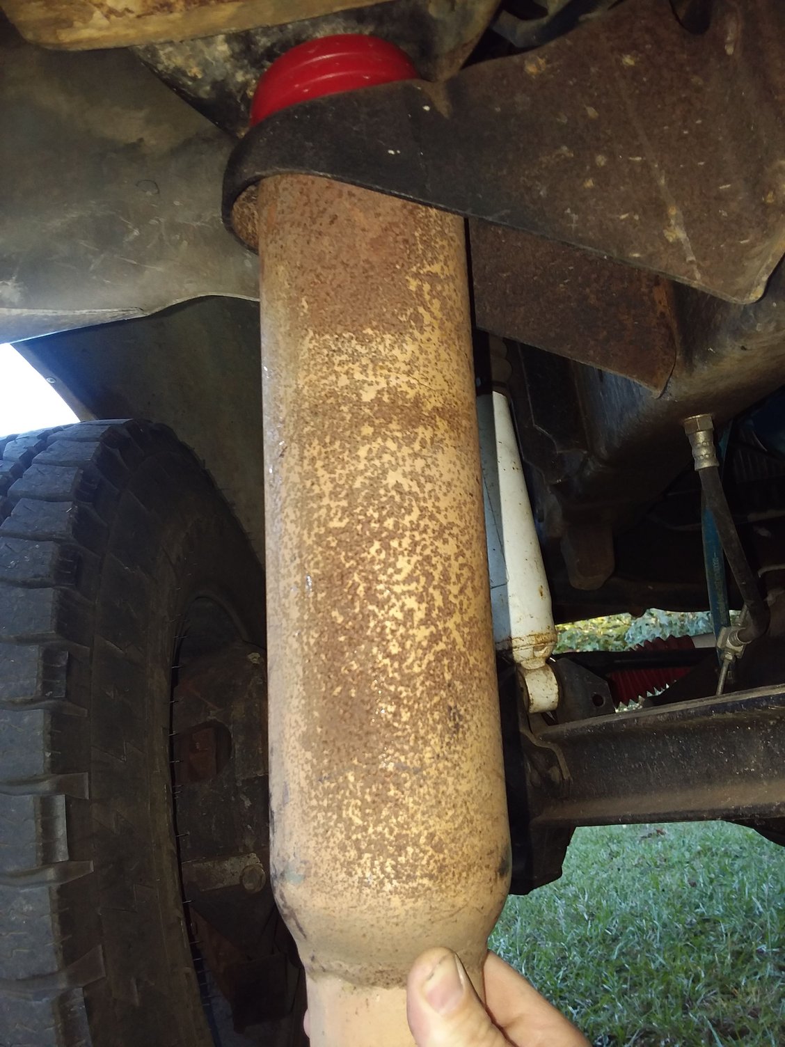

Here is the set up some one on here made to pull the body mounts apart. I hope they chime in and explain.

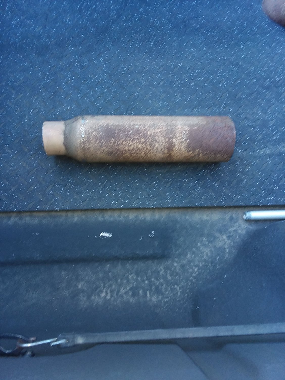

I used a piece of an exhaust tip and made this puller.
Even though it is pricey, I would also get the kit from the link above. I got the lower retainers from LMC, but had to re-use the uppers. It looks like the kit above has everything.
