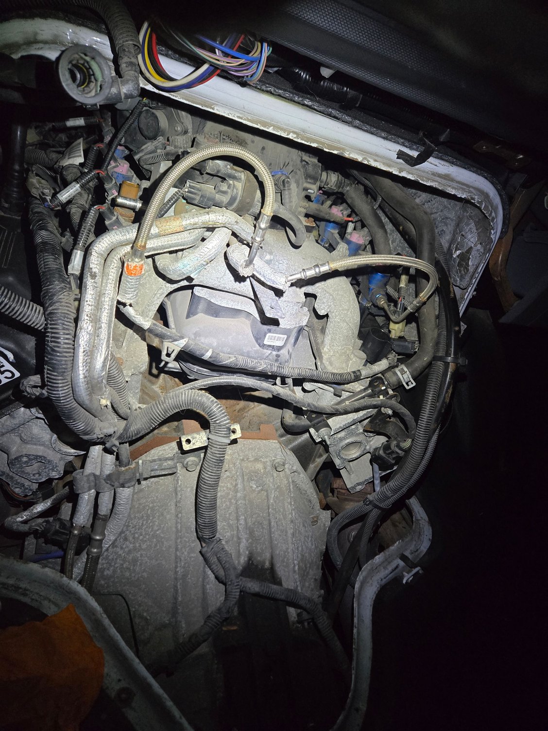

Hey guys,
New here, looking for some guidance. Couple months back i bought an old u haul service truck for cheap, 15 e350 with the v10, it was an offer i couldnt pass but heres the catch: it runs on propane lol. It has the Roush Cleantech system and although i got it to start, it just keep dying and throwing codes for low fuel pressure and misfires. Long story short, i want to convert it back to gas and wondering if anyone here has done it. As far as I know, its just a different tank, fuel rail/lines, and pcm. also if anyone could please tell me what the 2 conncetorson the pic go to? they were connected to some sort of pressuse regulator? from roush.

You should be able to yank all the propane stuff off it and go back to gasoline pretty easy
Your processor is there, or you would not have codes or even be able to start it
Correct, you will need a gas tank and lines and a new pump
Find a new Ford OEM pump
You might need a new intake manifold and some fuel injectors
All easy to find parts at a junkyard
Good luck
