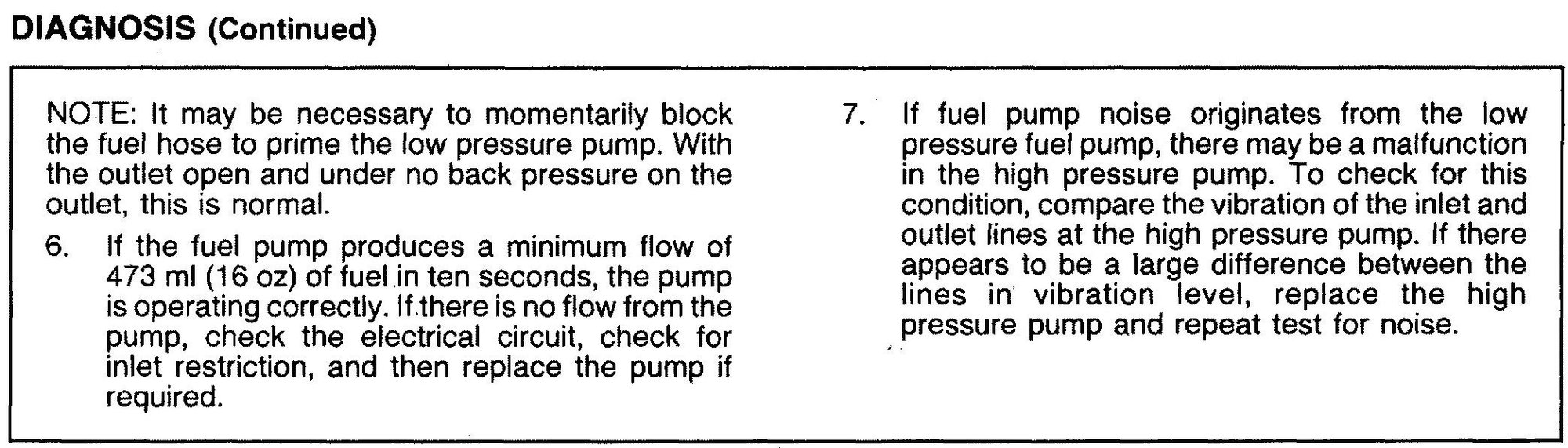

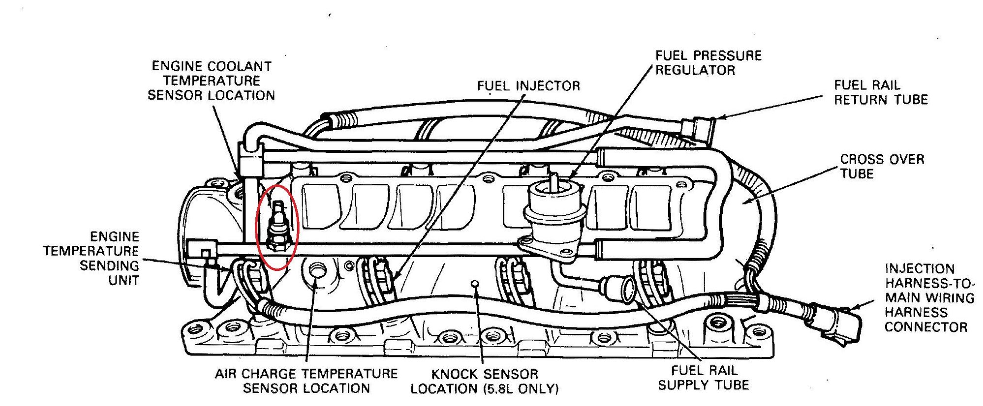

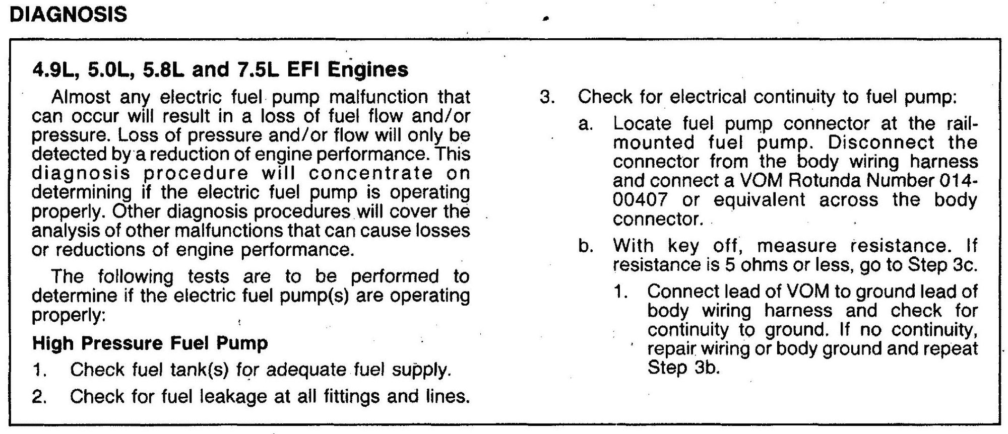

If you need to run the pumps for testing with the engine off then ground #6 Do NOT run the pumps dry as it can burn them up!
The fuel pressure test port is circled in red. Should have a black cap on it unless someone left it off.
This will be a big help. Thank you
