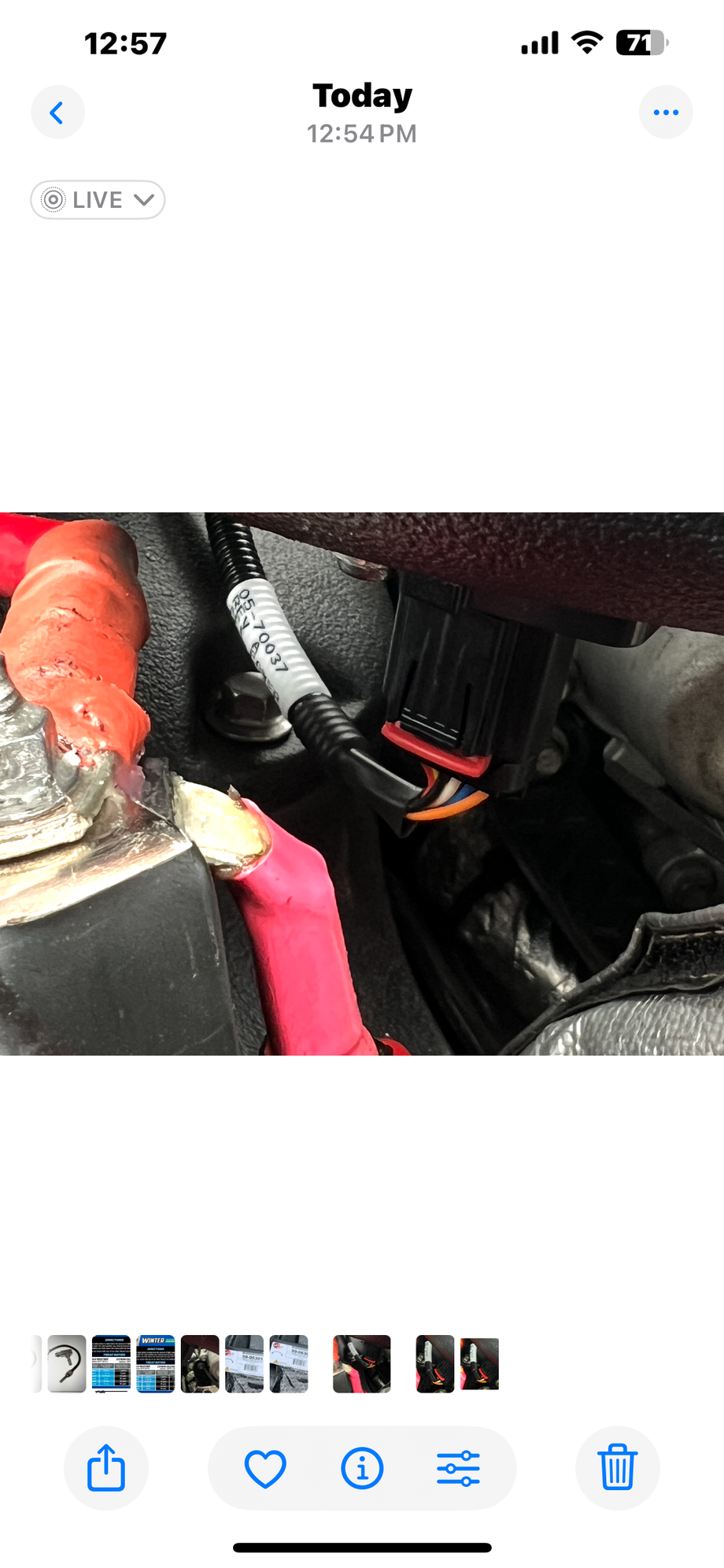

i installed a banks air box and to me it seems like the truck MAF sensor cable lost its slack and opportunity for trying off for stress relief. Seems tight with no slack and in my mind…could eventually break a strand. There are about 5 wires in the bundle. It the best pic but you can see the stock cable pulled almost horizontal to the rear.

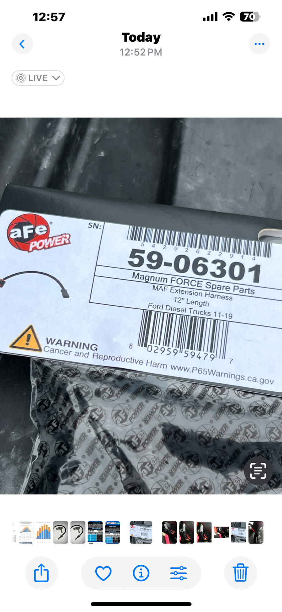

so I looked around for a MAF cable extension and did not find one. A few months later I found this one by accident.
so I just installed it and I’m able to tie it off and leave a little slack in the cable.
tested it and MAF numbers are normal.
life is good again.

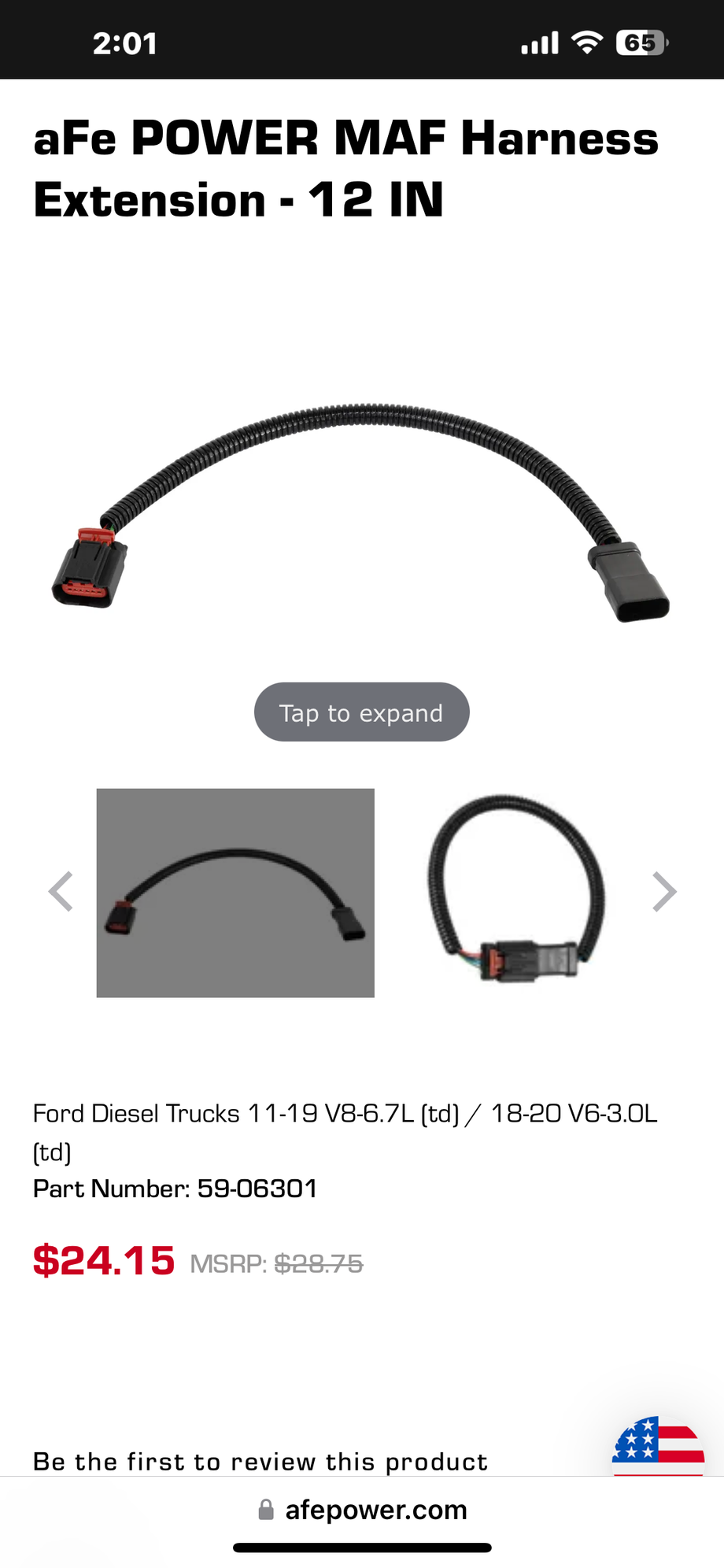

https://afepower.com/afe-power-59-06...qorsEYqdRO4cNJ

Well, I went to the site, but when filtering on 2020+ that cable doesn't show up. I wouldn't think that it would only fit models up to 2019, as that's a pretty generic cable...
Old Nov 20, 2024 | 01:08 PM
speakerfritz's Avatar
speakerfritz
Joined: Jul 2013
Posts: 14,266
Likes: 2,187
Yes, it says 11 thru 19

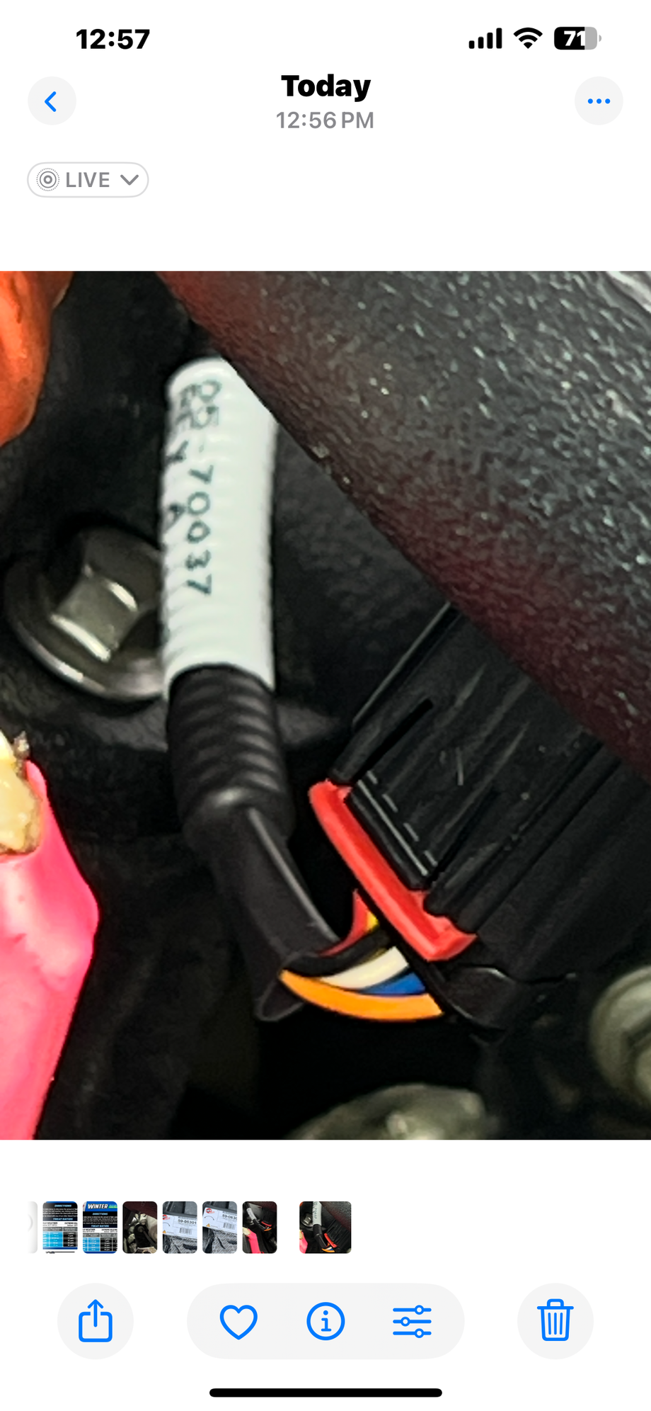

Here’s a pic of the MAF pins
granted the sensor itself on 2020 and up has a diff part number

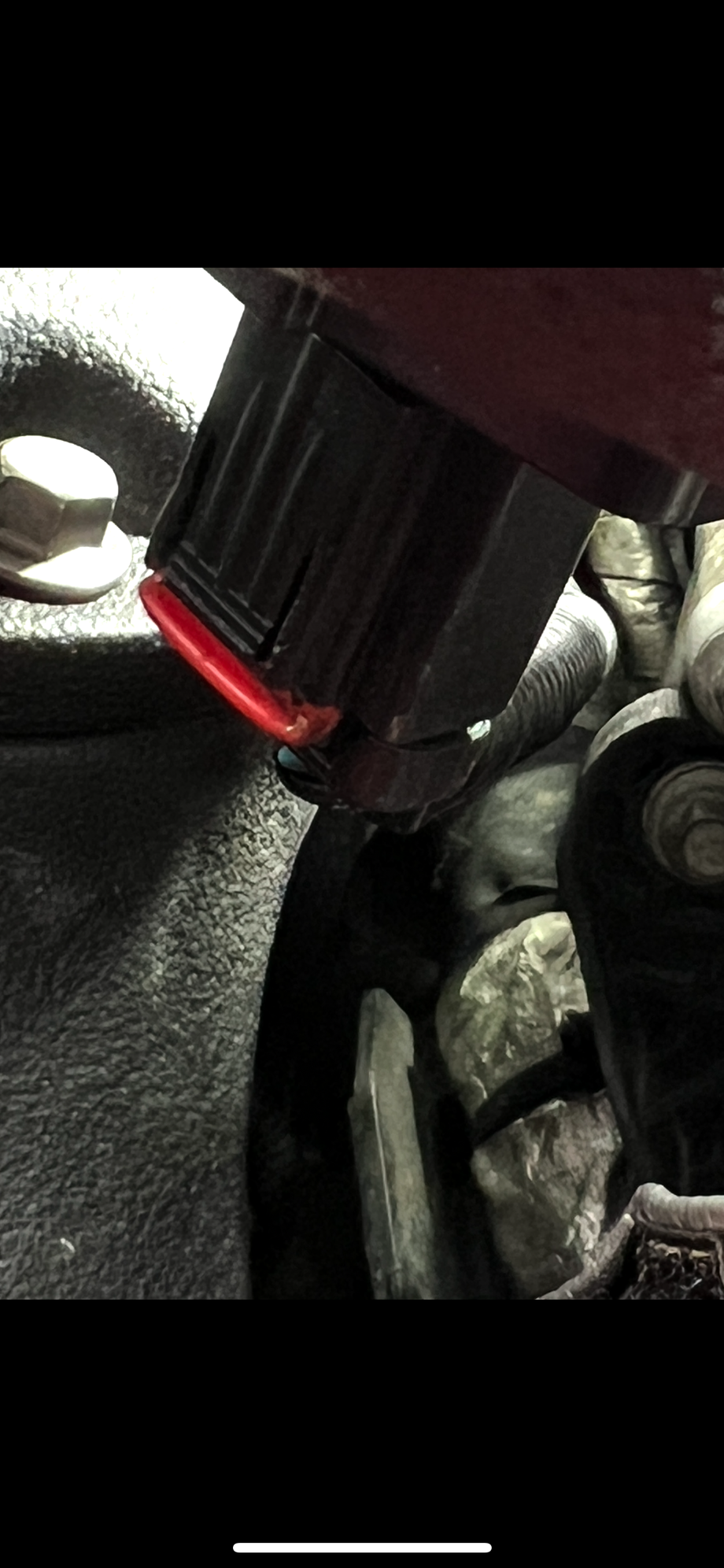

Here’s a 2020
2020 looks to have 4 wires
11 thru 19 has 6
