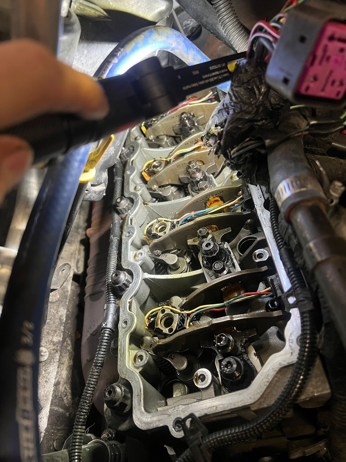

Air tested it found it coming from the passenger side, torn it down tested it again seemed like it was coming right from the middle, pulled stand pipes and dummy plugs all look good, took off rail cannot see anything what else could it be just the injector nipples? Is there any way to see how there broken?

1. A nicked injector Oring when the oil rails were reinstalled...the internal oring inside the top of the injector. It's easy to nick one when the rail goes back on. Did you remove the rails when you did you SP&DP?
2. Ball tube orings. Not hard to replace at all.
3. Failed SP middle oring

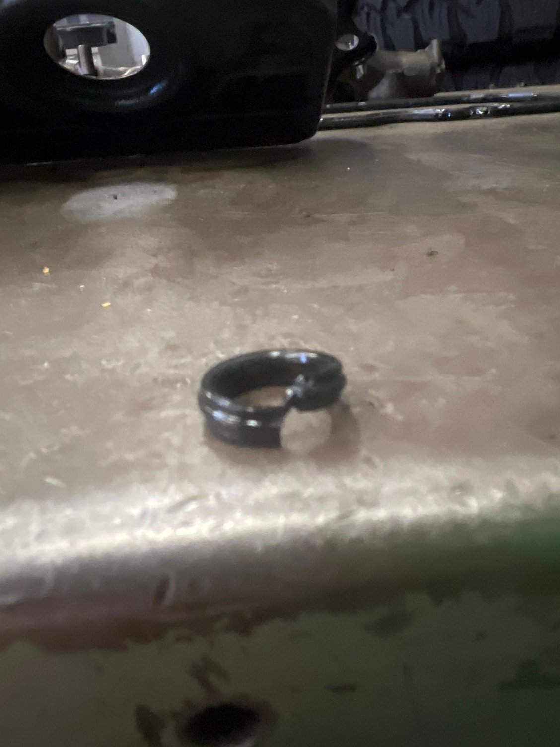

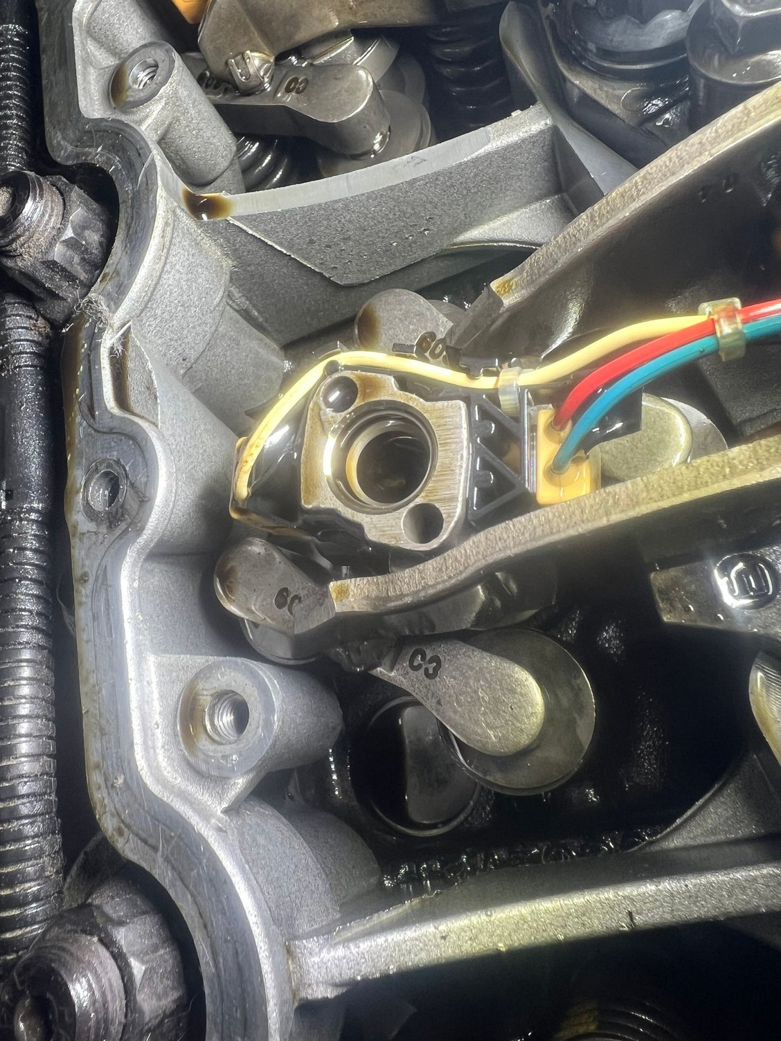

I ended up finding one of the injector o rings ripped can attach photo, but I ended up noticing that on all the injectors when I wiggle the c clip and the retaining thing underneath it all has movement is that normal?there WD 155/30 injectors I’m guessing the ripped o ring is due to the injector nipples

That o ring came from the second I injector,everything else seems to be good i think the next step is putting a new o ring in there and re doing all the nipple o rings aswell I was able to get the injector seal out while the injector was still in without removing the c clip but im kind of concerned why all the c clips seem to have wiggle play in them there brand new injectors with about 8k miles on them

Injector o rings were the biggest problem for me. It looks like that one may have been nicked.

No, the injectors should not "wiggle". They should be tight. When I did my injectors, I saw anywhere from 18 to 30 ft-lbs of torque for the hold downs. I used 28.
It looks like you nicked the injector orings with the ball tubes when you reinserted the oil rail. Do a search on Super Duty Service. He uses alignment pins (3 per side) to perfectly align the oil rail tubes prior to reinstalling it to avoid just this problem. I did the same when I did mine. The link is below. I wasn't happy with the fact the oil rail still wiggled a little when I had it on the pins, so I pulled it back off, and wrapped masking tape around the pins to tighten the fit. This way, there was hardly any wiggle and there's no way I could have nicked the injector orings with the ball tube.
By the way, I'm not a believer in the new and improved ball tubes. I think its just marketing. There's nothin wrong with the original unless they get nicked, burred or dropped. Mine were fine and I reused them. They really should not wear at all. I did not compromise, however, on the orings.

DO NOT put it back together without alignment pins on the oil rails. Photos showing them are in the linked thread.
