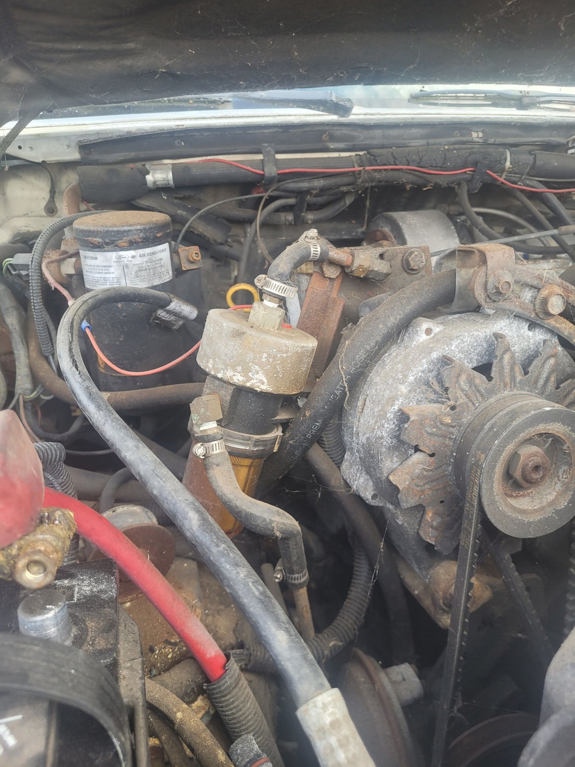

So I plugged the vac line and connected that thing and drove the truck today. Brakes are back to normal, but BRAKE light did not come on, so I guess that thing is not worth tinkering with.

Here we go. I just don't understand why mine is not working. It must be a simple design with diaphragm and a set of contact or switch of some sort behind it. With 0 vac here it should trigger the brake light.
Still would like to hear some recommendations on vac gauge. Not going to do it right away but putting on to do list.
Oh, I'm sure if you wanted one of these, you could use one out of something common and just snip your electric plug off and wire it in to trigger the brake light. It's just a simple little vac switch/sensor, as you say after all.

Just research and find one that sends the warning at the desired low vacuum level you want, that is, if they're not all pretty much standard anyway. Just because Ford no longer makes a plug and play one, doesn't mean you can't just wire in your own. I did loads of things like this to my '68 T-bird. All, lower priced and far superior to what was there from 50 years ago anyway. I never concern myself with oem, especially when it can be upgraded.
