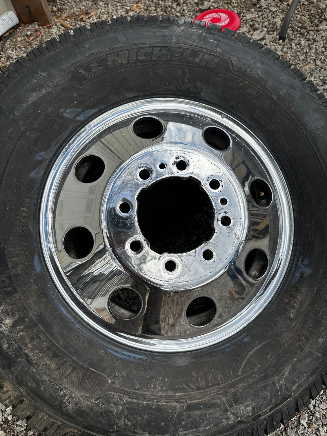

They can be shined up somethin fierce. My brother took mine up to his polish guy (he has a fleet of tractor / trailers) and had them stripped down and polished…. I haven’t seen them in real life yet but in the pic he showed me they look fantastic. I’ll get them back probably tomorrow, I’ll try and remember to post a pic in here when I get them back.

Boy did those wheels clean up nice or what! I would’ve never thought they’d turn out this nice.
