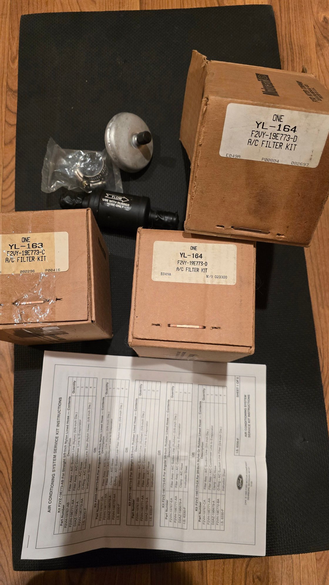

Ford made filter kits
I have a couple
They came in 5/8 and 3/4, straight and 90 degrees, for nylon lined or rubber hose
One type had barbs, the other o rings
We put them in the suction line in front of the compressor Threw the aluminum pancake ones away that came in the kit

These things saved the day back in the 90s when ford made a bunch of trucks and Broncos with no AC oil in them
Every single one of them blew up the compressor in about 4000 miles and contaminated the system bad
We used the 100 dollar a gallon Ford AC flush and then these filters
They are long obsolete, but you can still find them
