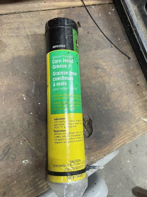

I hobbled out to the garage to take a picture of my used bottle. I used about ¾ of the bottle.
You don't need a zerk. The 00 grease I used is in a plastic bottle that you simply squeezed into the steering box until the box is full.

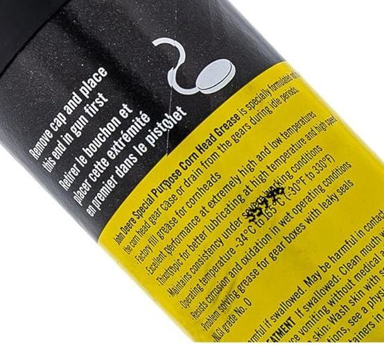

Genuine John Deere "Corn Head" Grease:
