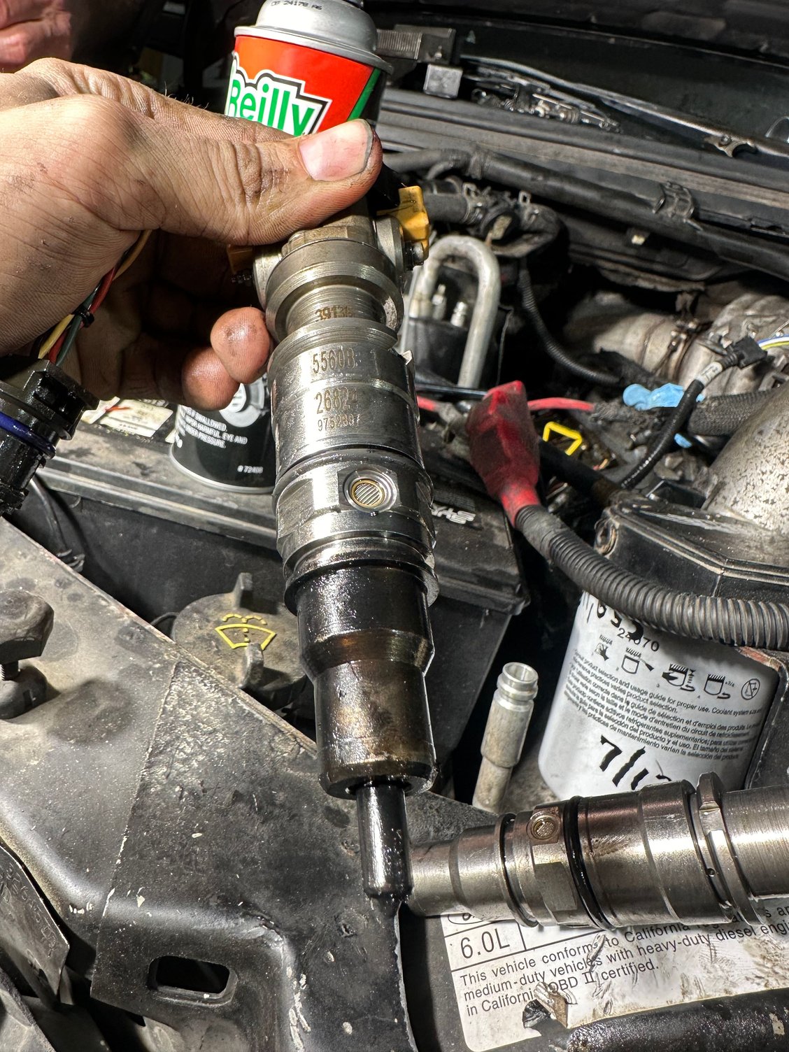

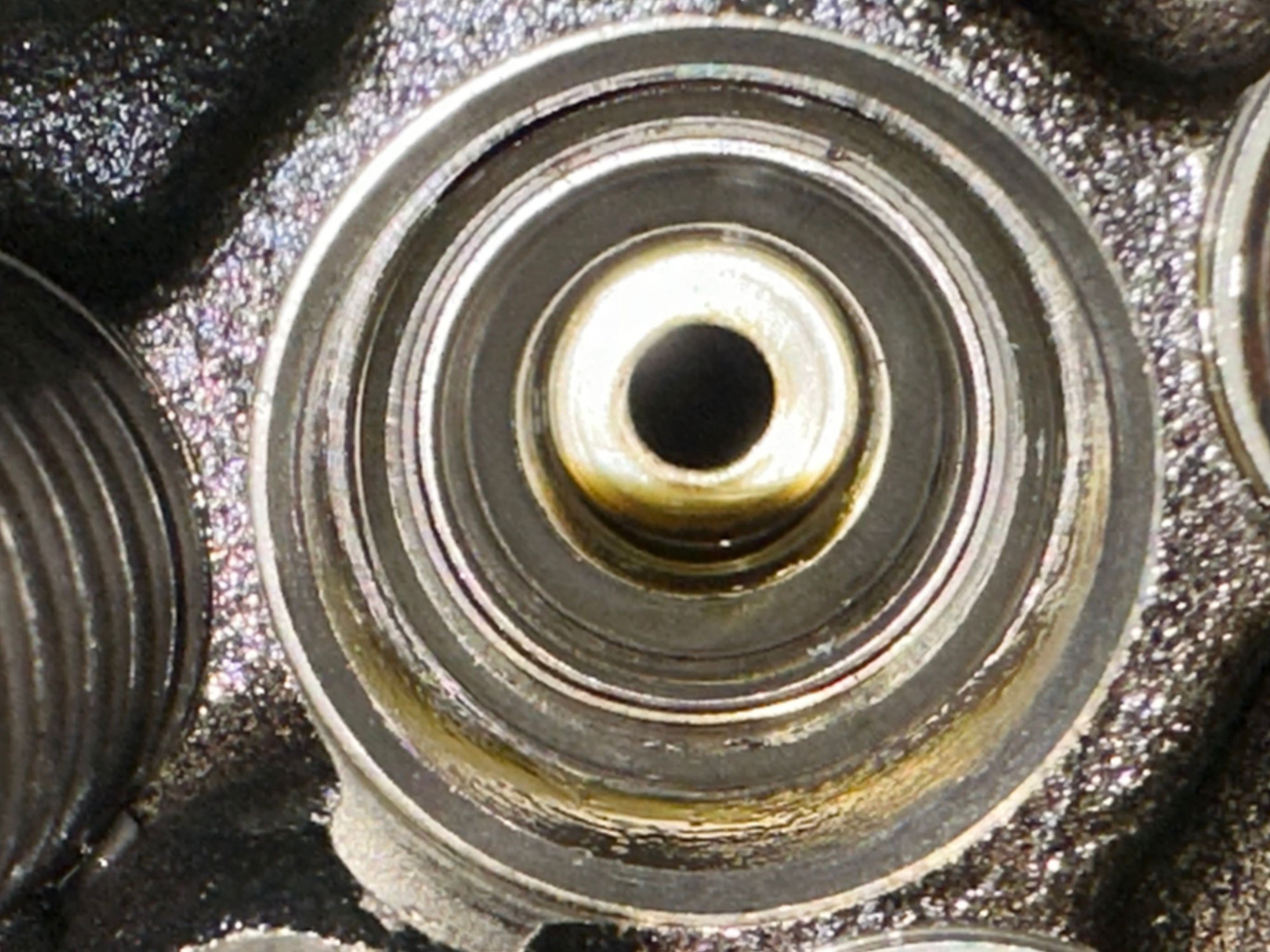

hello, I have been trying to get my 6.0 running for about a month now and I have come to the last remaining issue on this truck. This is the second time it has happened now and I just would like to hear y’all thoughts on a solution for this.
Attached is a picture of the injector on the same cylinder that it blew the first time. and it seems like all of the injectors look burnt on the bottom as shown in the second attached picture. I have a feeling that the crush washers aren’t working even though I am torquing down to spec (26ft lbs) and cleaning out the holes for hold down and the cups.
What could be causing this to happen?

A bad injector sleeve in the head. Please post a picture of injector seat in the head.
This is what it not should look like

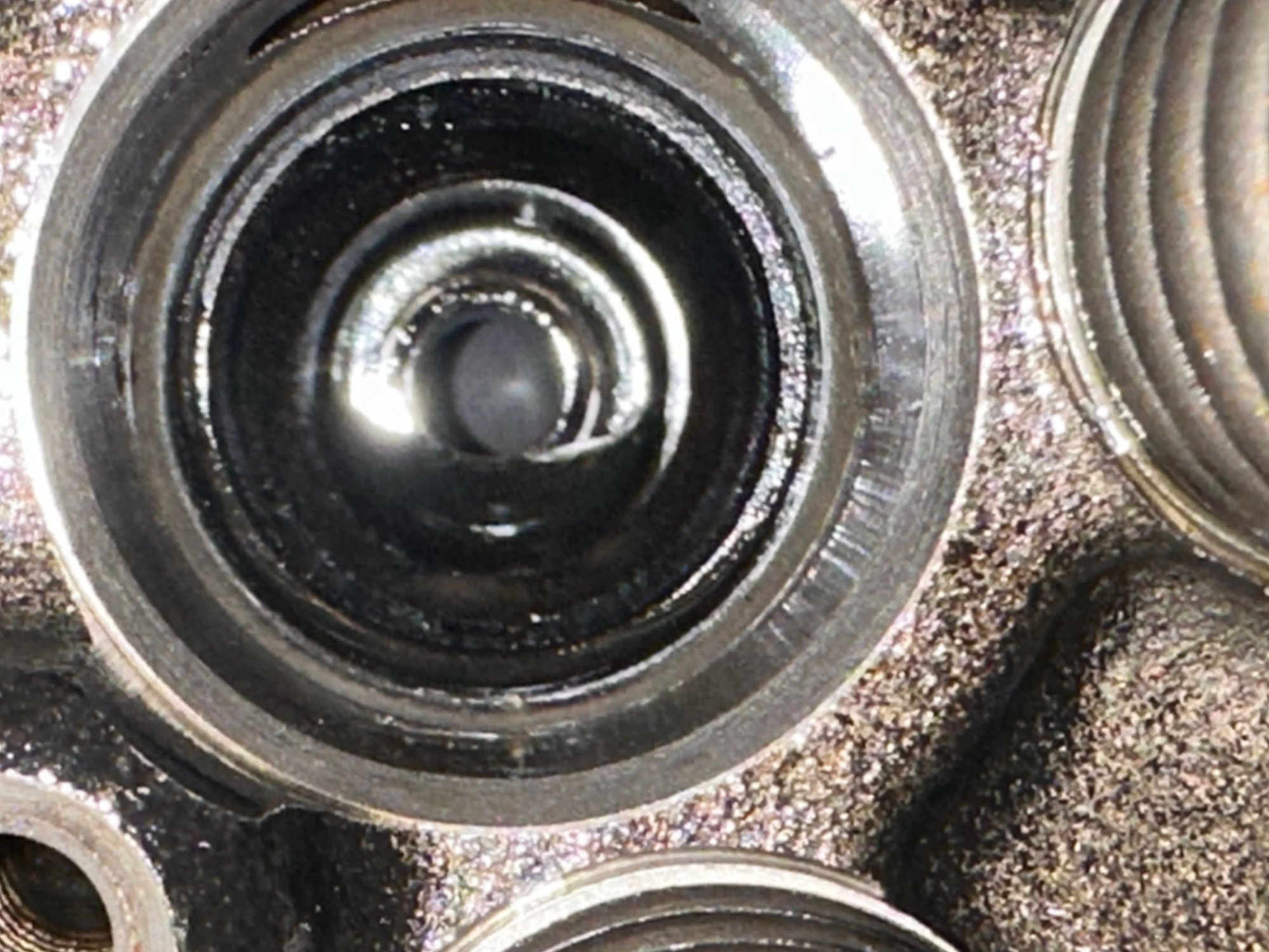

These are a couple i took earlier trying to get a better look for myself
It seems odd that a new machined heads and rebuilt motor would have this issue not even 100 miles into being put in.

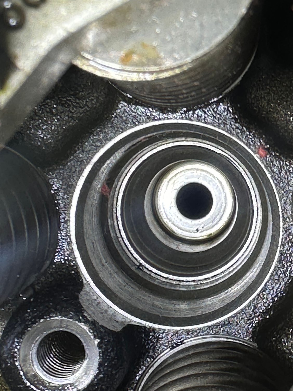

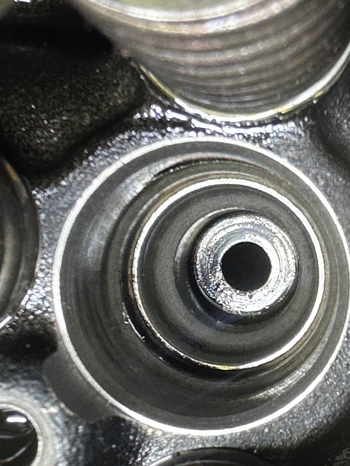

These are the same 2 after i cleaned them up, these pictures are the best I can take.

The first sealing surface appears to be damaged at one point (red circle). The second sealing surface is unusable. Both are caused by improper injector assembly.
I would not replace the sleeves with the head installed.
