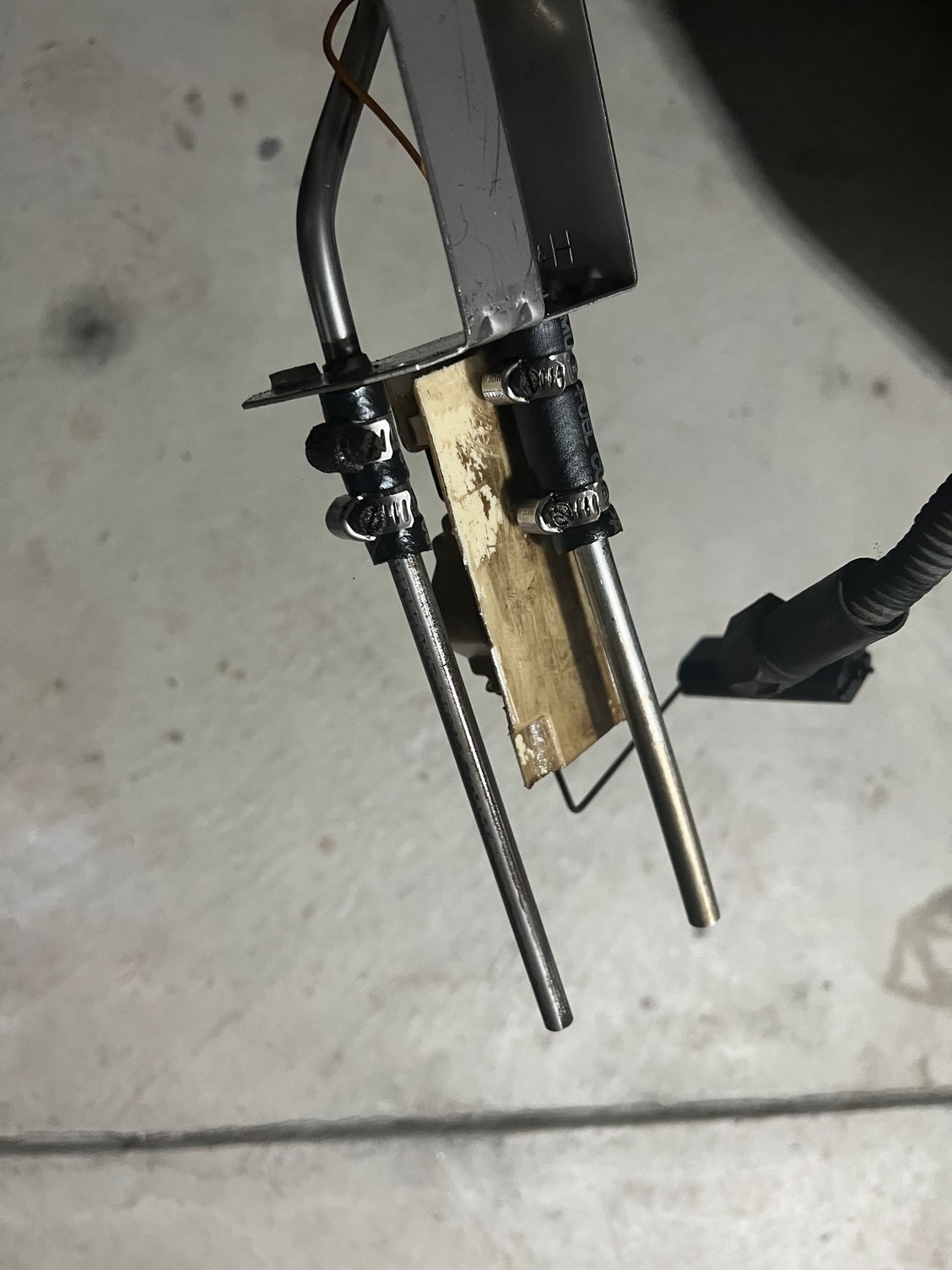

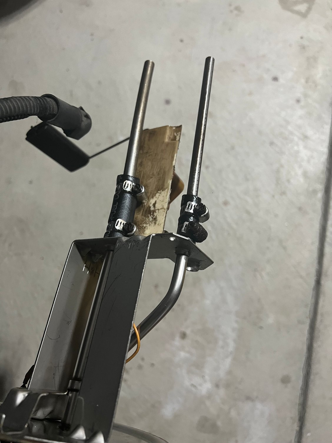

Got started on the work yesterday but pulling the driveshaft, followed by the fuel tank.the tank was rusting and pitted on the inside so fuel permeation through the steel was causing the sweaty tank. I then took the sending unit out and this is what I found.
do I leave it as is? My plan was to put the umbrella pickup back in but I’m reading that those are undesirable. TIA

I replaced my shower head units. On trucks at least, that is how you suck up the last 1/4 tank

tjc transport's Avatar
tjc transport
i ain't rite
Joined: Mar 2005
Posts: 65,465
Likes: 5,534
either replace the shower head, or put a piece of diesel rated fuel hose on the pickup pipe with a "V" notch cut in the bottom end on both sides that goes down to the bottom of the tank.
either work, but i prefer the shower head as it has a screen built in to keep crap in the tank from getting sucked into the fuel system.

How far off the bottom of the tank should the shower head be?
Old Dec 9, 2024 | 11:51 AM
tjc transport
i ain't rite
Joined: Mar 2005
Posts: 65,465
Likes: 5,534
i try to go 1/4 inch.
