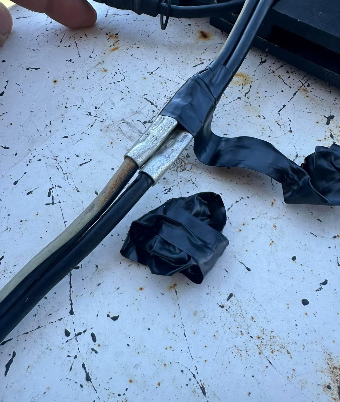

Originally Posted by Pikachu
A bolt or butt splice and some heat shrink tubing works just fine.
that’s right make sure to insulate the bolt as well or you’ll magically have similar issues the guy had in the photo lol. there wasn’t a fuse from the factory adding one is one more piece of gear to carry might as well addd a circuit breaker at that point for reliability. My truck is the same year countless miles with a stainless bolt did have to redo the ring terminal as they were corroded.
Hey now, this deviates from the well established fact that anything worth doing is worth overdoing. It's the American way. What are you some kind of commie?
I definitely voted to loosen environmental regulations lol
although I guess when person was slapping the electric tape binding the non offset positive and negative uninsulated terminals together they felt they were over doing it and proud 😭😂🤣

From: Ponca City, OK
I noticed that. I just wrote it off thinking they were both hots but even in that scenario that wouldn't exactly be ideal. The fireworks show that'll give will be patriotic at least.
