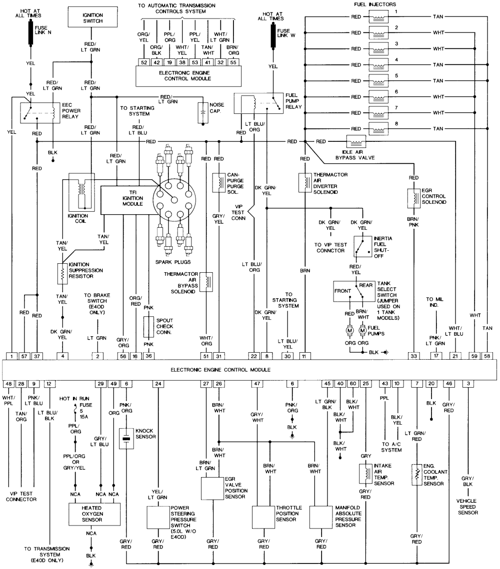

Agreed. I am going to the various Mechanics shops local to me and using some of there test equipment. I already had to borrow a starter motor for the truck as the original was toast. (I assume last owner just let her spin trying to get it to start) I am planning on going out and testing for power at the injectors later today. I found this schematic that looks like it is correct for me. I noticed that the EEC relay Powers the Fuel Pump relay in that diagram and as I have fuel pressure at the rail and can hear the pump cycle, The EEC relay must be functioning. That will lead me down the rabbit hole of wiring issue from the EEC to the Injectors, Power to the Injectors or a Bad EEC. I am hoping it is not the latter.

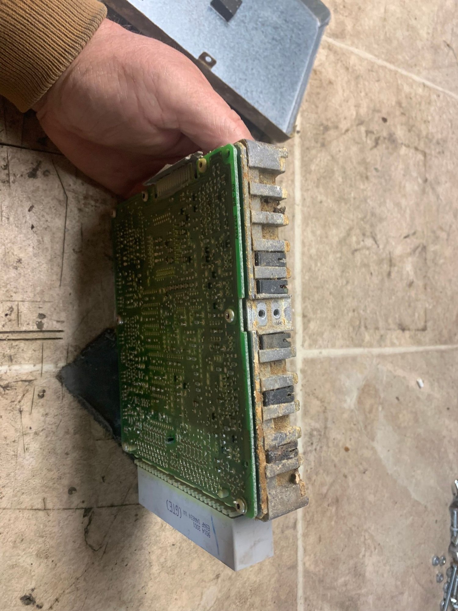

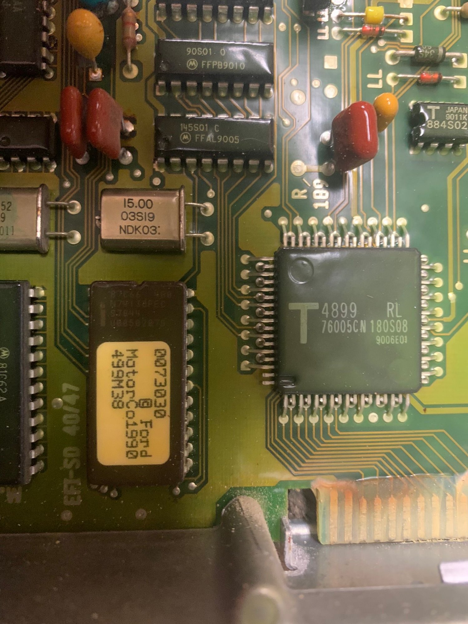

well here Is what I think is the issue.
BAd cap and a busted resistor for sure. along with mouse urine ect...

Yup. Toast. You may be able to repair the components and revive the ECU, or just order a rebuilt unit and use yours as a core.
To answer your question: When the engine is cranking, the Ignition Control Module doesn't look at the computer and fires the sparkplugs purely off the PIP sensors raw signal coming from the distributer. After the engine starts, the ECU modifies the timing signal from the PIP to control the timing and spark. I've never tried to start an EEC-IV engine without a ECU connected, but I'm guessing it would run, very poorly, on just starter fluid.
