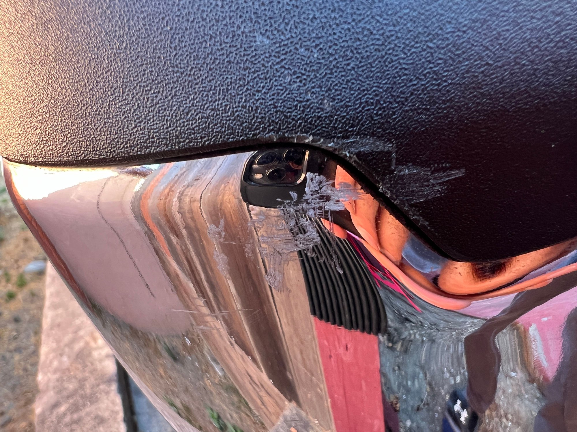

This is the rear bumper, driver's side with a chrome finish. Is there a way I can fix it or at least make it less noticeable?

In general, not really. You can #0000 steel wool pad with a strong polish and rub it..... the steel wool will not scratch it and will help soften the sharp edges and remove the finer scratches. Then spray the area with clear- this will keep it from rusting.

They make 1/2 side replacements.
