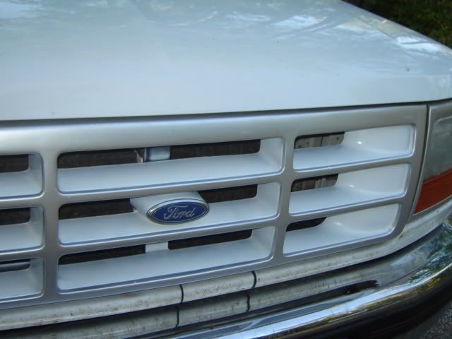

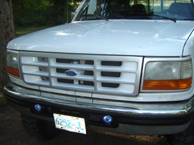

I used Krylon chrome in a can spray bomb. Looks like a satin finish aluminum....it shines pretty good in the sun but it looks nothing like chrome...I guess you could get it to shine better with some more work, like multiple layers, clear coats and wetsand and polishing, but it still wont look chrome.
Heres pics:

NICE job on the grille pud!
It may not be chrome but it looks good.

Yea, Man that looks great espically for coming out of a spary can!

I was impressed. $6 for the "chrome in a can" and $2 for the white. Not too shabby at all, thanks guys
