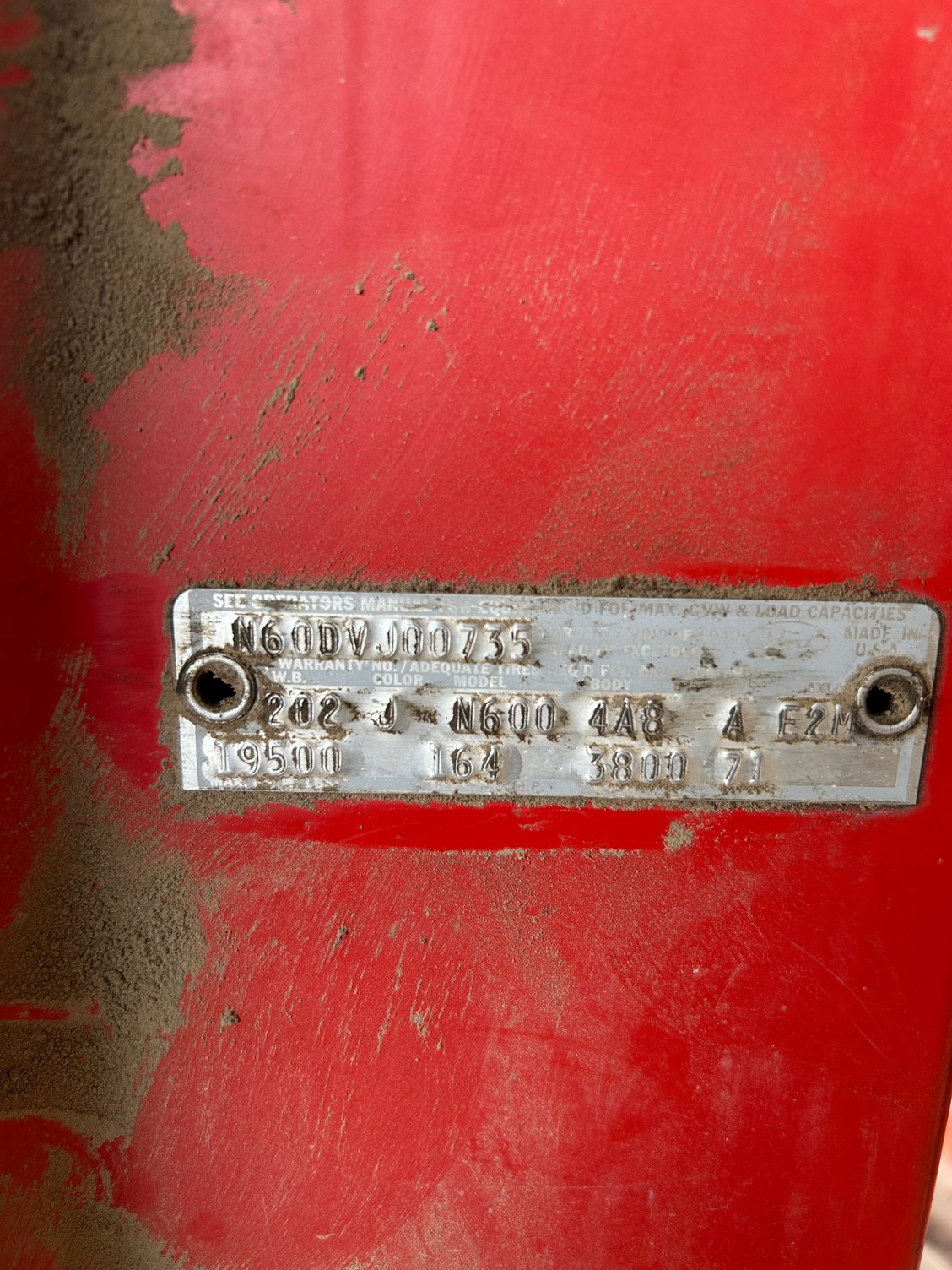

1970 LN600 decode
Need this vin decoded if possible thanks
N60DVJ00735

N60 = LN600 gas
D = 330 2V HD FT gas V8
V = Kentucky Truck Plant
J00735 = 1970 numerical series, April 1970 production
202 = 202 inch wheelbase
J = Red
N600 = LN600 gas, 19,500 lbs GVWR
4A8
4A = Black with Blue/Parchment/Black/Red/Ivy Leather grain HD Vinyl
8 = Standard Cab without butterfly hood. Cab and chassis vehicle.
A = New Process model 435 four speed transmission
E2M
E2 = Eaton model 16244 Two Speed Rear Axle / 6.17/8.58 / 17,500 lbs. Rear Axle Capacity
M = Ford 7,000 lb. Capacity Front Axle with power steering
19500 = 19,500 lbs GVWR
164 3800 = 164 certified net HP @ 3800 RPM
71 = Los Angeles District Sales Office
No special order

Thanks so much now the work starts
