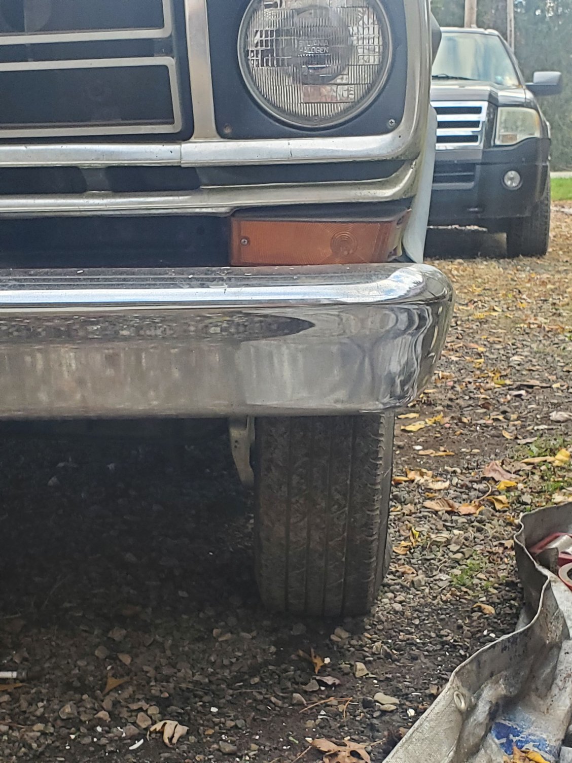

Hi everyone. I'm working on a 72 f250 camper special. I converted the front brakes from drum to disc, put all new steering components on and a new cab mount and bushings on the driver's side. There are a couple things. 1. That body line is off on the driver's side. The bump lines up but the whole thing angles down from the front fender to the door. I replaced the cab mount cause it was gone but it didn't fix it. 2. The driver's side tires camber is angled more than the passenger one is. I put new springs on it. Is this something I should be concerned about? Thanks in advance

It looks to be 1/2 to 3/4 inch low at the front cab mount.
Perhaps the new cab mount wasn't installed correctly.
Maybe you could add a spacer in that mount to keep it at correct height.

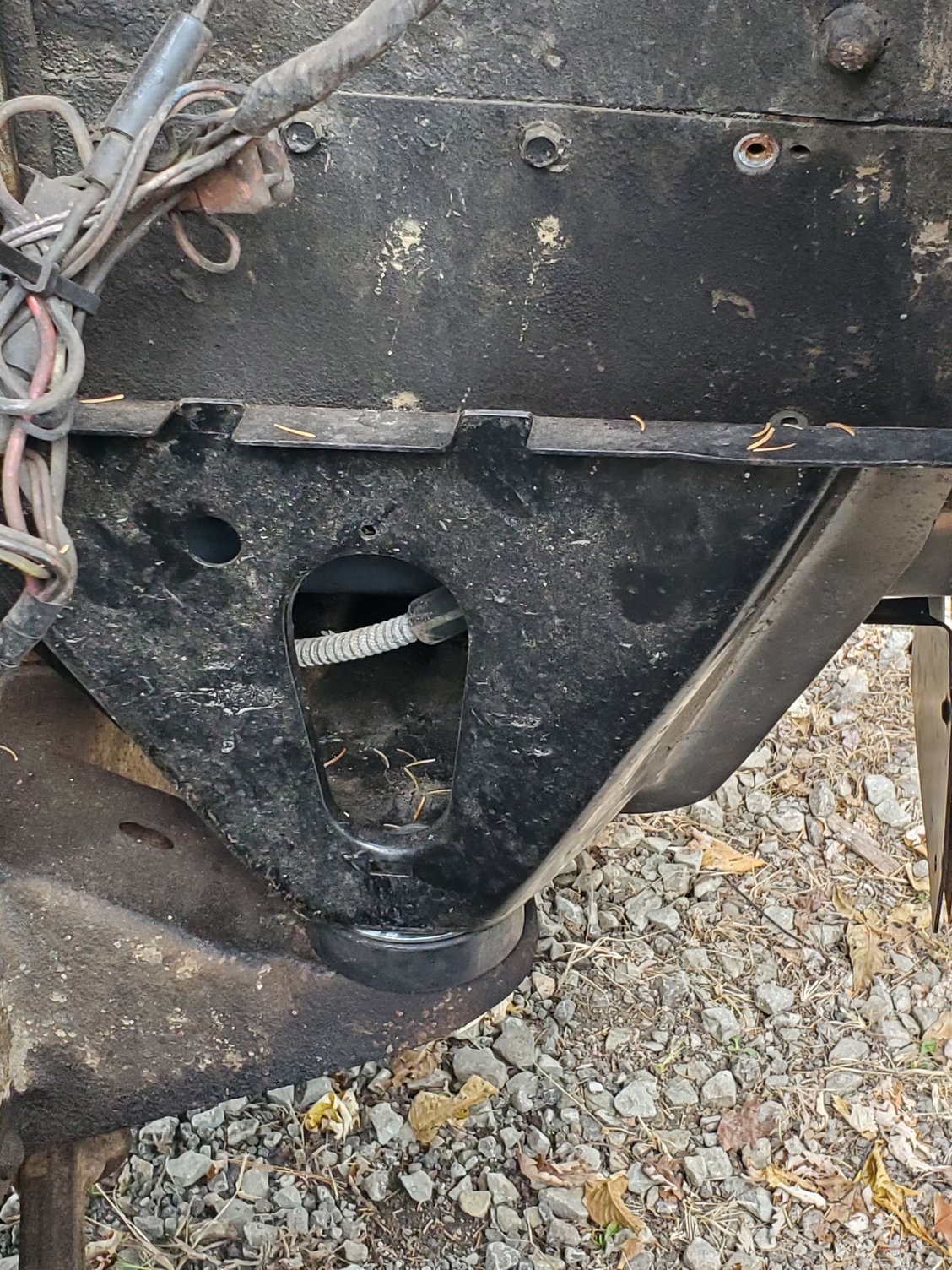

Old Oct 30, 2024 | 02:29 PM
timduvall's Avatar
timduvall
Joined: Aug 2014
Posts: 64
Here is a pic

Looks like you are missing the fire wall lip that the cab mount is supposed to sit under and help line it up. I would guess that the cab mount is too high and causing the problem.

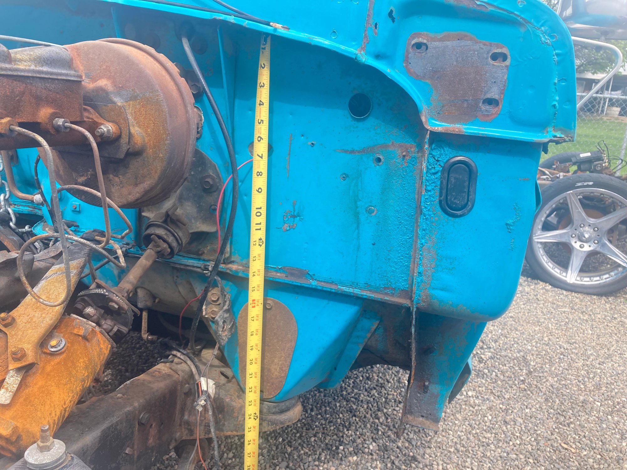

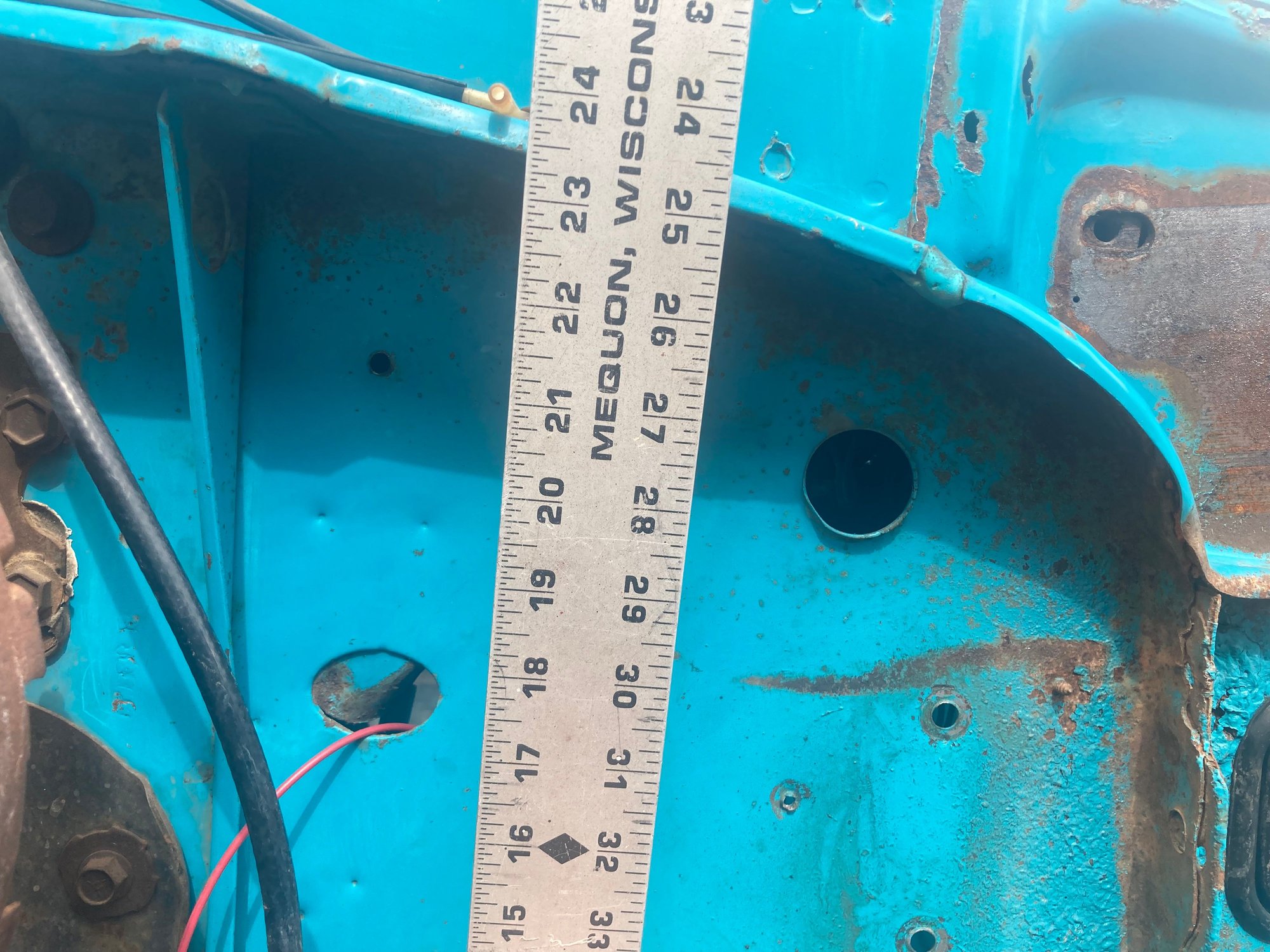

I took some measurements off one of my trucks a while back for someone else and still had the pictures. So here you go I hope this helps you sort it out.
I've replaced a number of them and recently just did another one on this thread here... https://www.ford-trucks.com/forums/1...72-hi-boy.html
It might help to see it vs yours and the lip that seems to be gone on yours.
So going straight down from the top lip of the fire wall under the washer fluid tube splitter to the base of the cab mount should put you right about 23-1/2"
I think your going to find that yours is probably mounted a little too high unfortunately.
Good luck

Yep you are correct. That lip is missing off of that side and I'm too low. Now I have to decide how to fix it. Either jack the cab up and weld it or shim it.

I have no idea what was done before. Yes, the other side looks normal. I have a new cab mount on it. The problem is the lip on the firewall is missing. Maybe I inadvertently cut it out when I replaced the floor pans. I looked for it but couldn't find it. I do know the cab mount I took off was screwed into the fire wall so maybe someone replaced it in days gone by and that was their fix. Who knows
