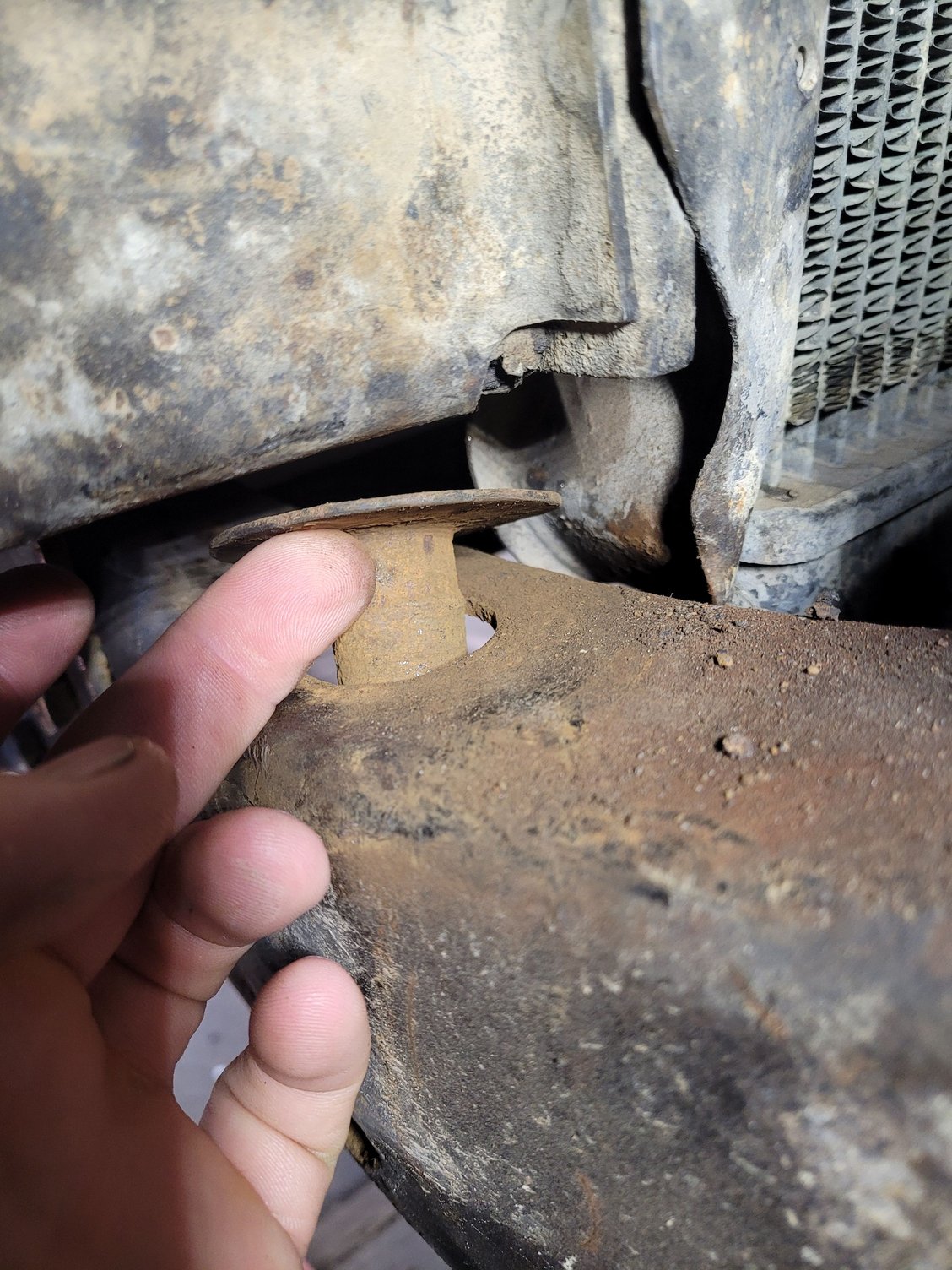

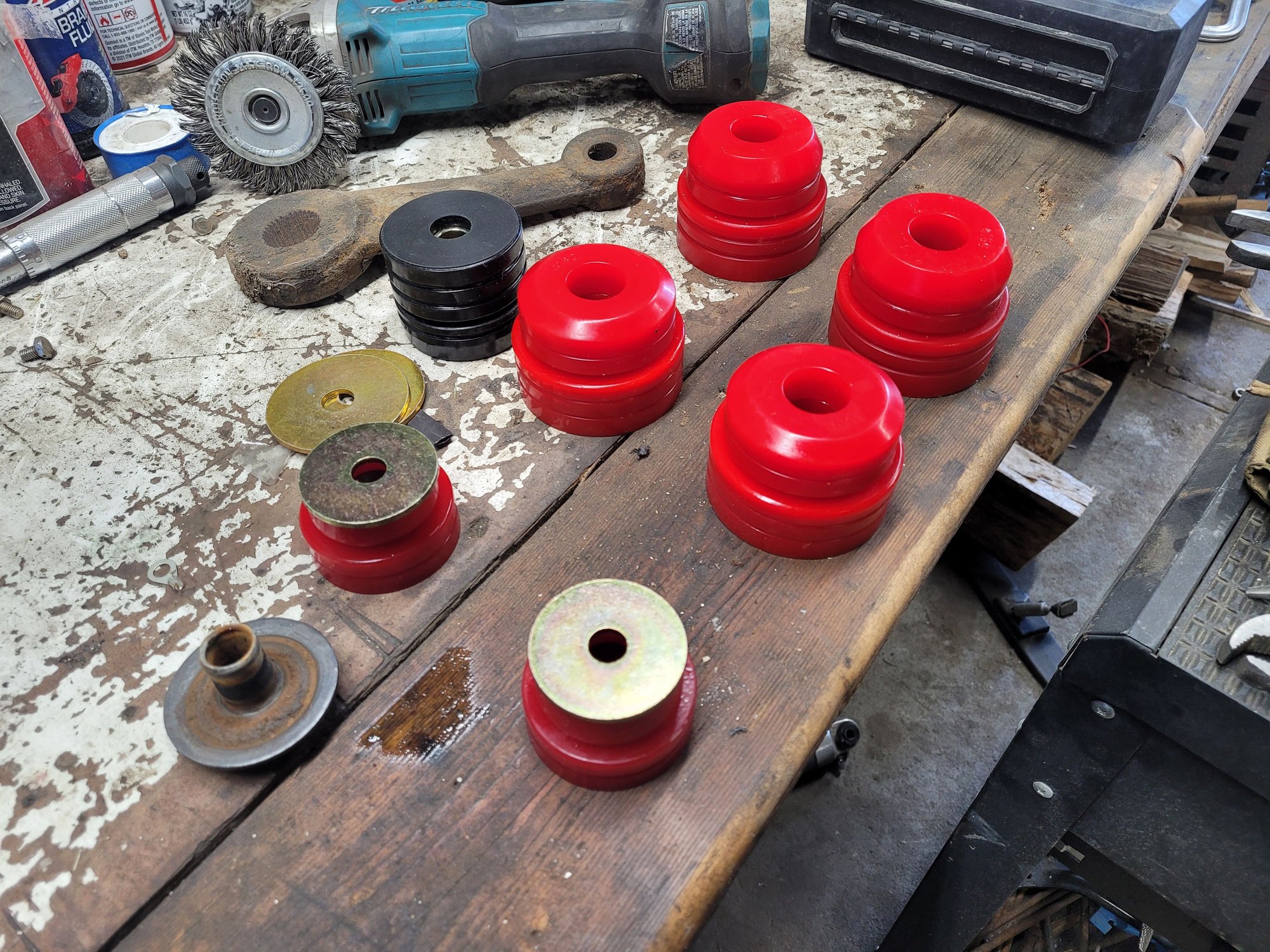

Apparently this isnt going to be the easy project I thought.

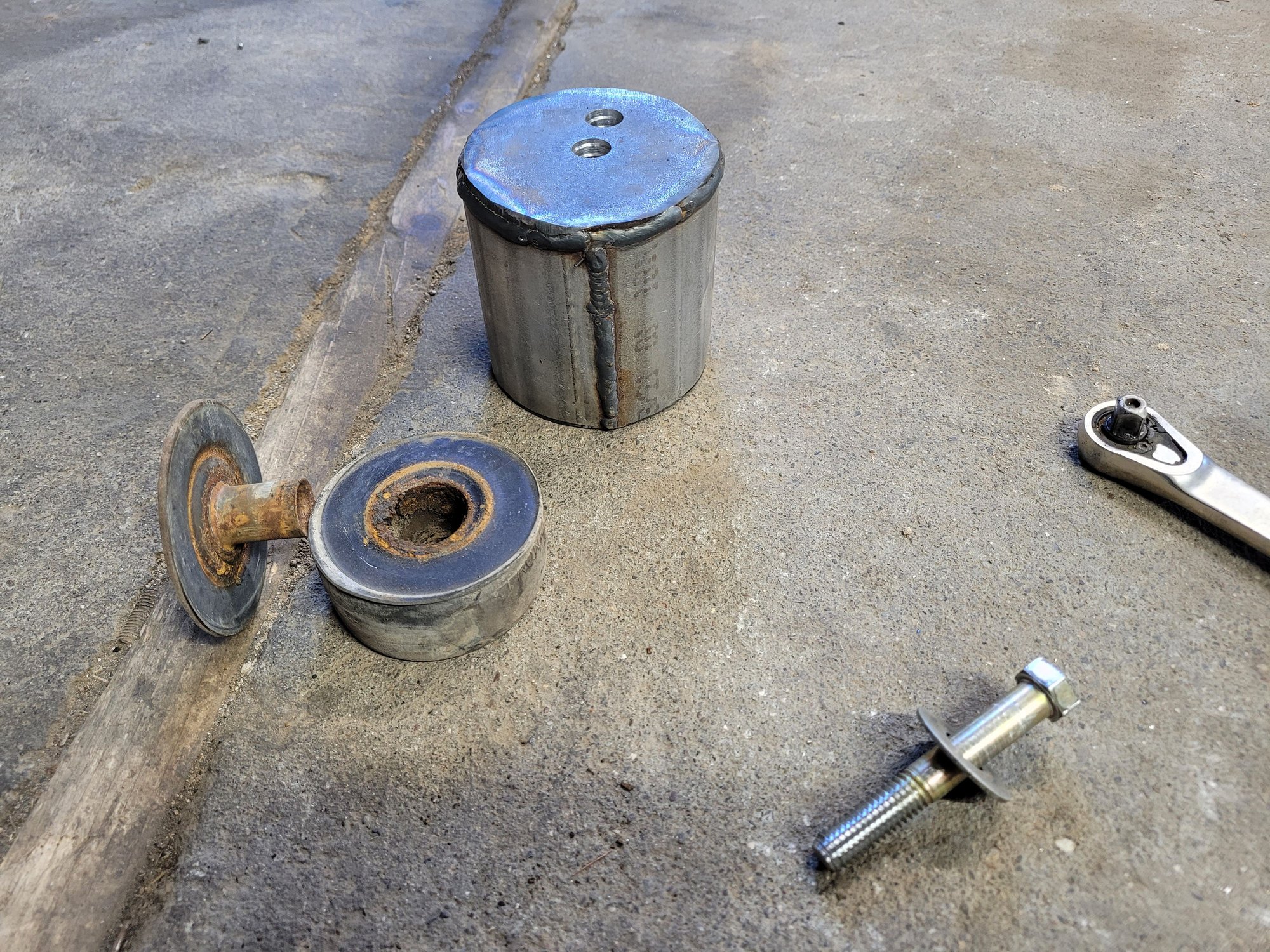

No its not rusted, the sleeves are fused together. One came out in good shape so I think im going to make new sleeves copying it.
The sleeves I think cost 18 bucks a peice.. the energy suspension poly bushings didnt come with Hardware other than a couple washers.
Why cant there just be a DOM bushing through the center with big washers on each side.

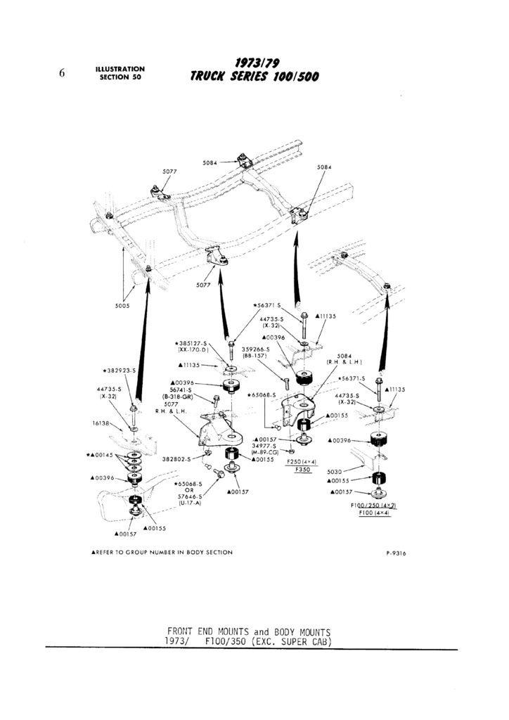

D3TZ-1000155-B.. Absorber (rubber cushion) - Lowerradiator support and lowerfront & rear cab mounts / Obsolete
CARPENTER NOS OBSOLETEPARTS in Concord NC = 800-476-9653.
PARTS INTERNATIONAL in Farmers Branch TX = 888-727-0418.
GREEN SALES CO. in Cincinnati OH = 800-543-4959.
WESLEY OBSOLETE PARTS in Liberty KY = 606-787-5293.
D3TZ-1000396-C.. Absorber (rubber cushion) - Upperradiator support andupperfront and rear cab mounts / Obsolete
PARTS INTERNATIONAL
CARPENTER
NOS OBSOLETEPARTS
GREEN SALES CO.

No it just came apart. Though I was thinking about some kinda of puller to seperate sleeves so mabe they arent ruined. I assumed they had calapsed and rust fuzzed together.

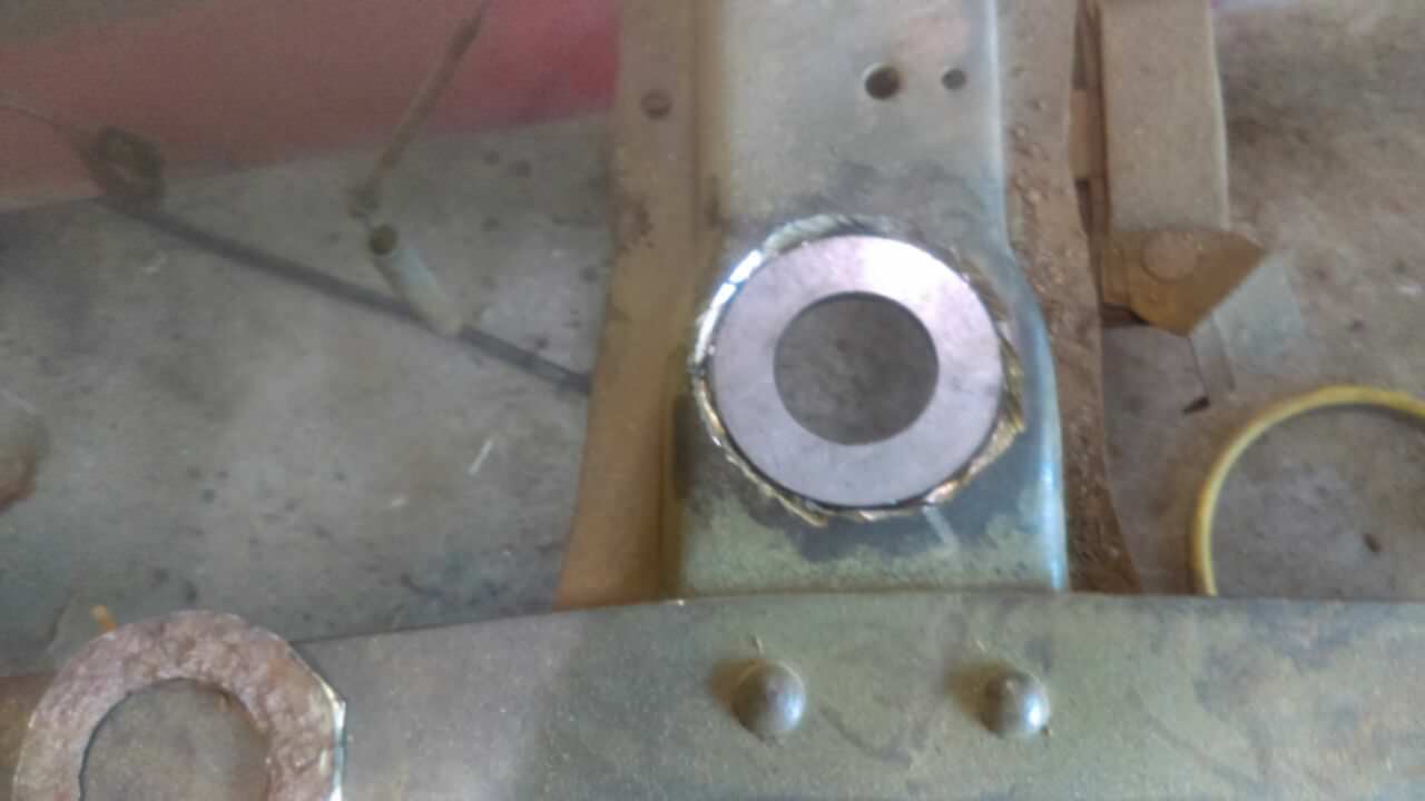

You can buy the bottom part of mount at Bronco graveyard new , I made the upper section , turned out good ,,when I removed mine I cut the top of mount off and then separated the sleeves with heat and welded thick washers to the top to replace , and purchased new lower sections

Yours may be fine nut mine had issues under the bushing but they make pieces for that as well , hopefully yours are good at frame side

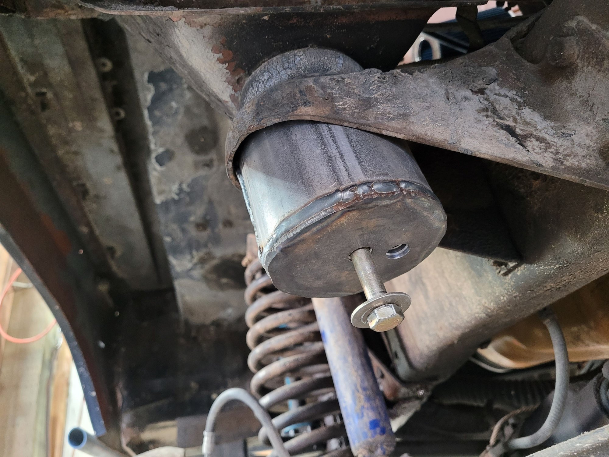

Just finished all 3 on driver side. Core support Was a fight.

I had measured thinking 3" was right, but quickly realised was gonn need to be more like 3-1/4" ID pipe. Looks like you maybe took larger pipe and cut a sliver out and rewelded it?

Yes 4" exhaust pipe

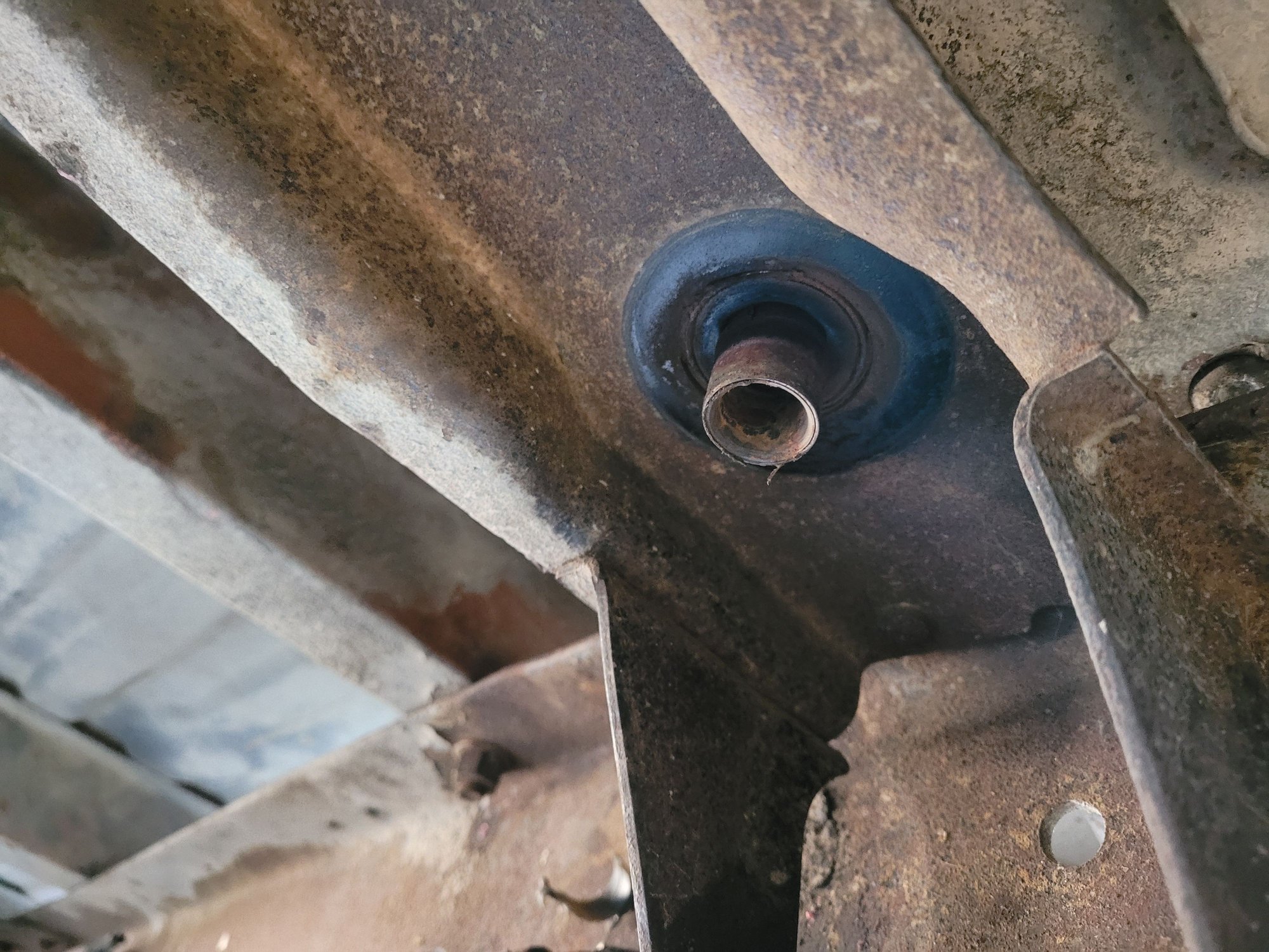

Might do passenger side tonight . The core support one distorted it alittle. Started thinking I was going to have to cut it.
Filling it full of gear oil then heating to boiling did the trick

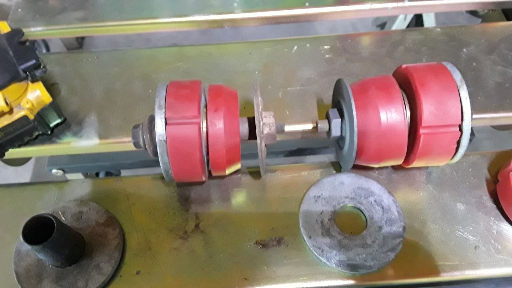

One more to go then setvon the the New poly bushings.
mmonday castor bushings get here thats far easier than these body mounts and will be a dramatic improvement in straight line driving.
Then steering will be tackled with track bar. In another month or two, after steering shocks kinda on the slow rd to new rubber on the ground
Decided to pull the lastvone last night. Welded a grade 8 bolt together to use instead of all thread. Got it pulled but it peddled the upper back like a leaf. Pressed it back straight on the press.
Sittin all new poly now just got button it up at some point this weekend and redo tail pipecsince its off.

Finally finished body bushings
Will be all new bushings ounce decision is made on front axle castor
