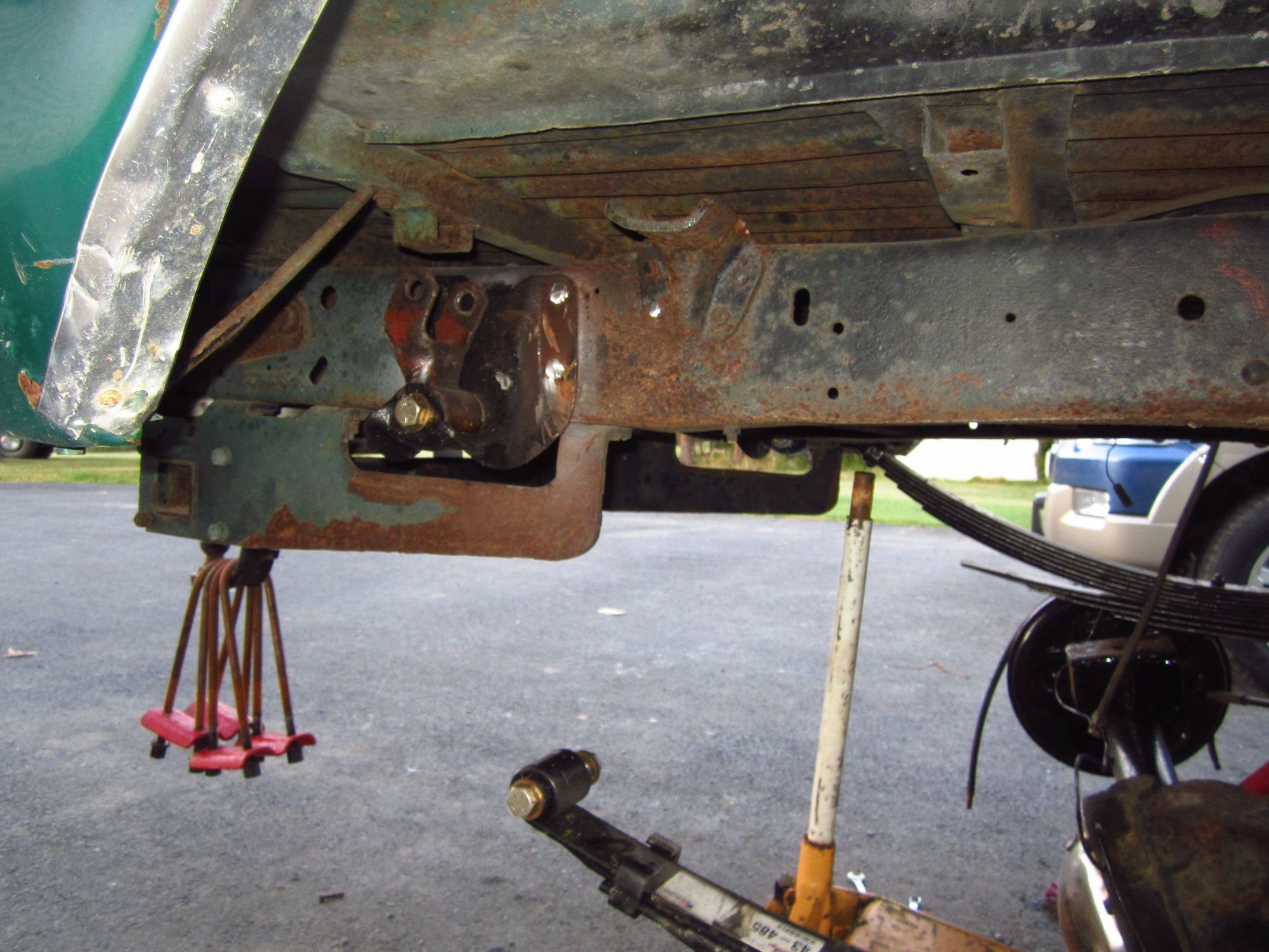

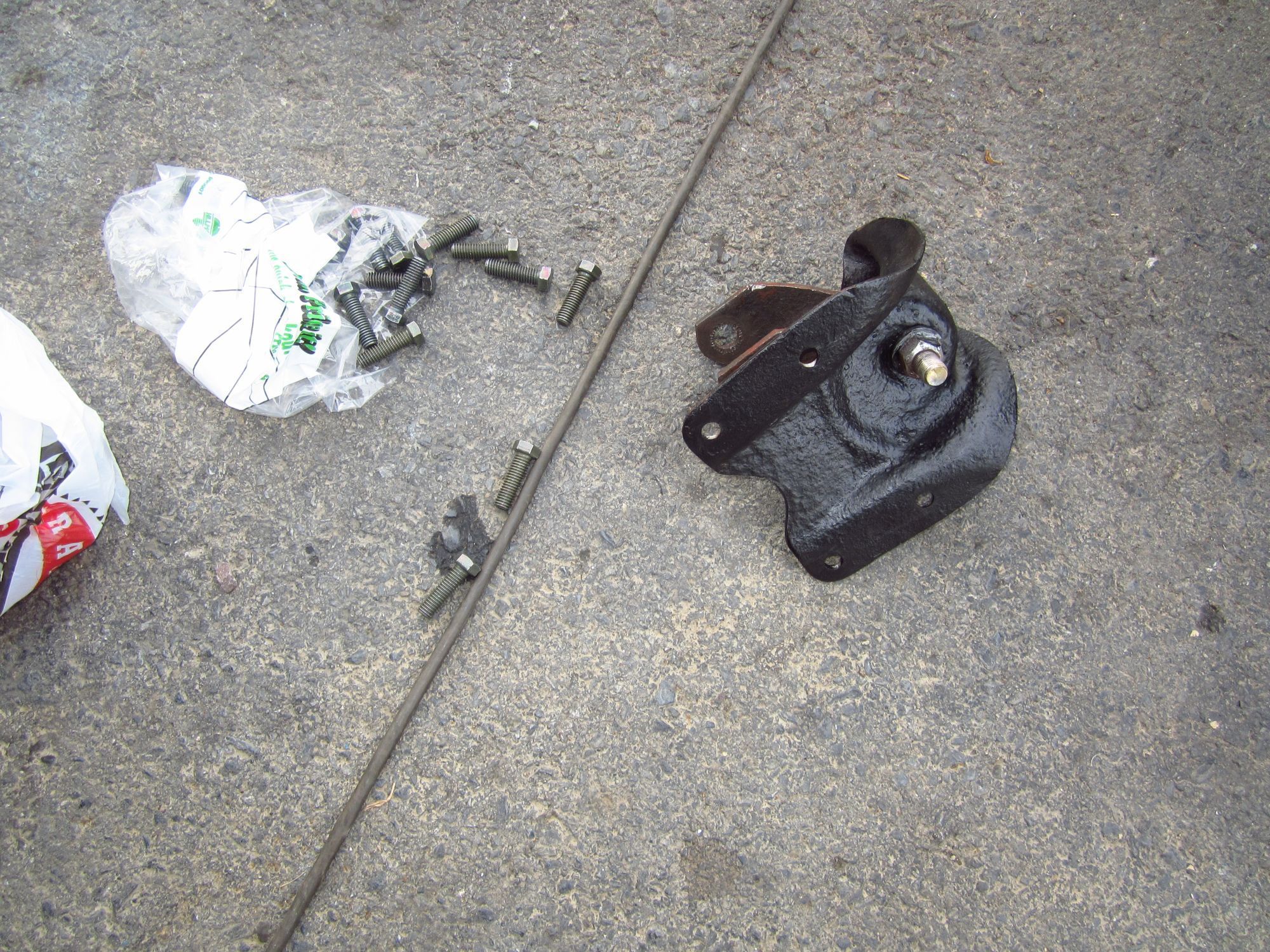

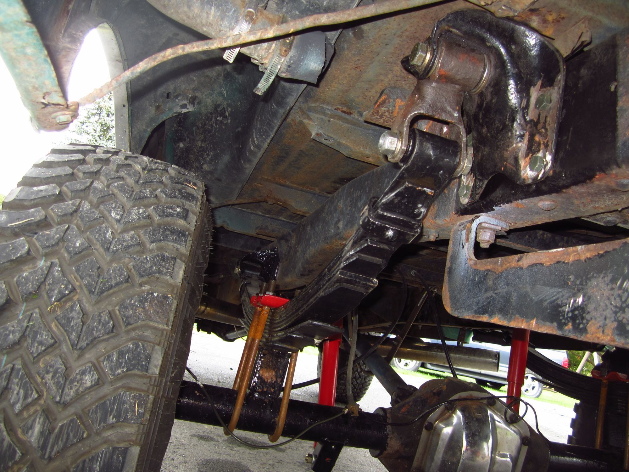

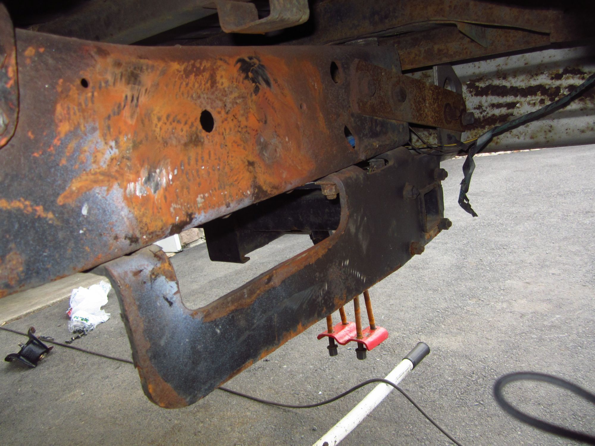

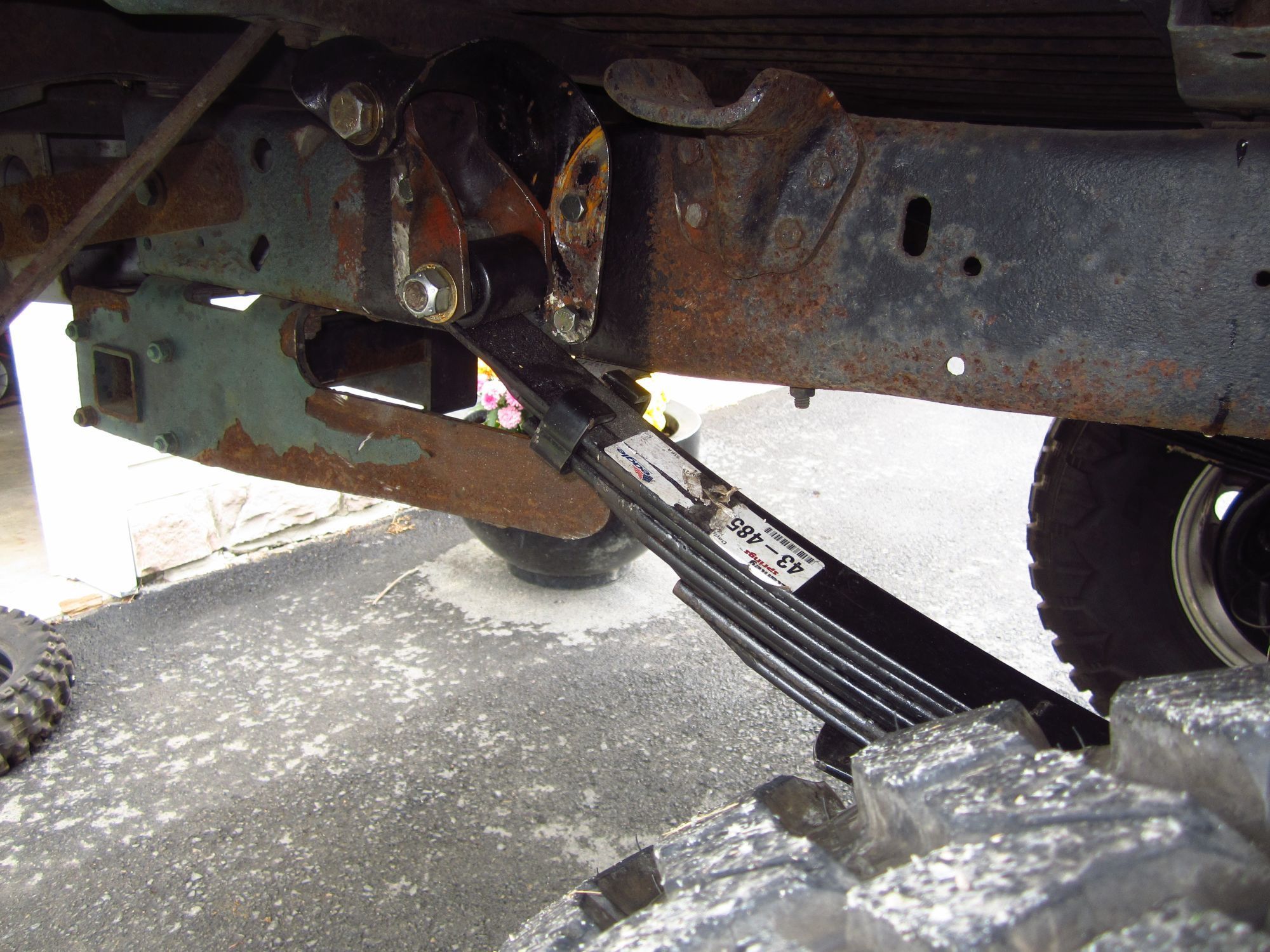

Stonebacon and Mark a, that is a way to get a cheap lift kit....IMO I do not think that all that hard work to grind and remove the rivets makes it worth it. Here is a fellow FTE member that did it and it looks he used the same holes and just cleared the bed.
Oh yeah that looks like its got plenty of room for the bed. I couldn't find any existing threads about doing this really besides a thread about reasons of doing it. What thread is that you got those pictures off of? Eventually I would like to delete the 4" blocks and run some deaver leafs on the truck. Could have a shackle made to raise the truck a little bit as well. I mainly want it to sit at normal highboy height but be able to flex out when I'm offroading it. Kinda de trucking it with making the suspension so soft but I have my Super Camper todo all of the hauling haha.

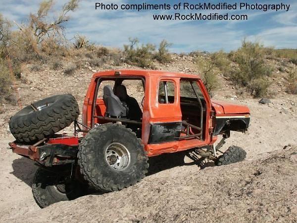

A fellow FTE member (cheeto) built his to flex out pretty dang good.

There are two orientations of shackles, compression and tension (stock).
Flipping the shackle to make it compression will reduce the effective spring rate of the leaf pack. The shackle will apply leverage to flatten the pack, and the effect will increase with compression. So a digressive effect that degrades load handling capacity. It will make the ride a bit softer but isn't better, as it will bottom out easier.
But it is a way to get free lift. I have done it a few times, only to go back to a tension. Ford uses only tension design for this reason.

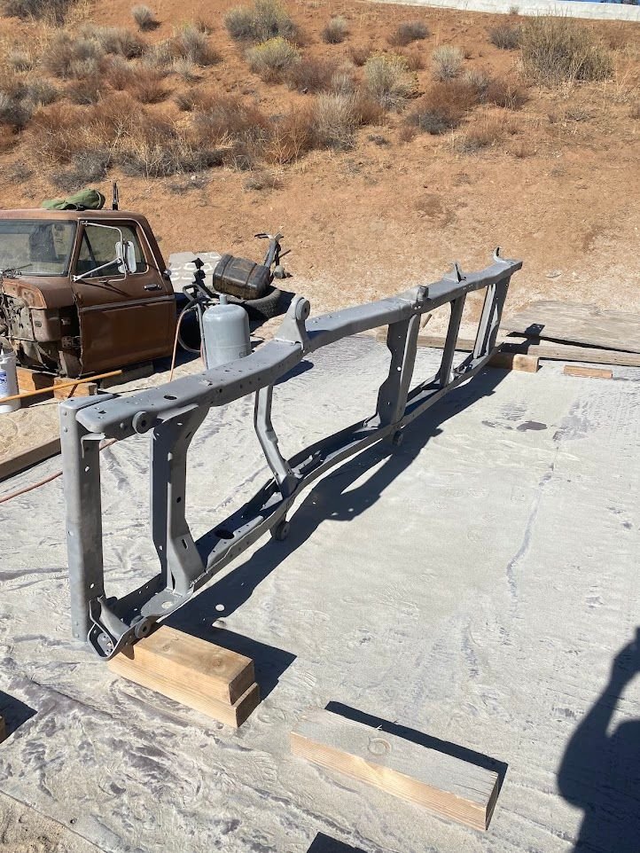

I am basically done with sand blasting the frame now and should be painting it tomorrow. Going to grind off the rivets first thing tomorrow and sand blast where they were.

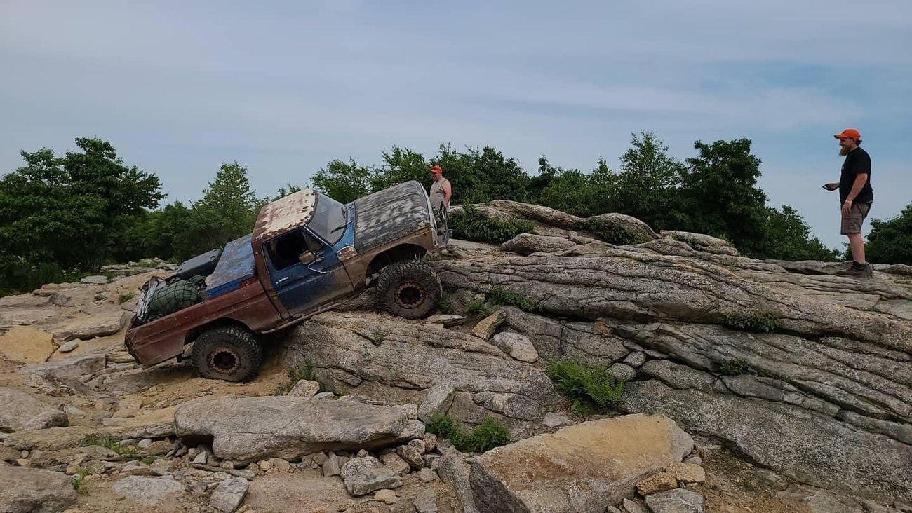

That is killer man! I'm kinda shooting for how this bumpside was setup with my truck. That truck is a big inspiration on this project of mine. His was 4BT powered I believe but I plan to put a 390 or 410 FE into mine with a NP435 and a 203/205 doubler with ARB lockers front and rear. Going to put rock sliders and a belly pan onto mine as well. Really want to run some Humvee wheels and tires on this truck as well but it doesn't seem like I can find any good deals within 150 miles of my house..
Started priming the frame today. The shackles came off super easy. Think I am going to remove the overload leafs from the leaf pack as well.
