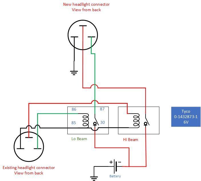

Originally Posted by 52burjes
Thanks for the reply, I should have mentioned 12 volt, but I will add a relay. Larry
I added 2 relays, here’s the schematic I used. Just substitute 12v relays and use - ground.

Thanks Bob, I've ordered a headlight relay kit with 2 relays.
