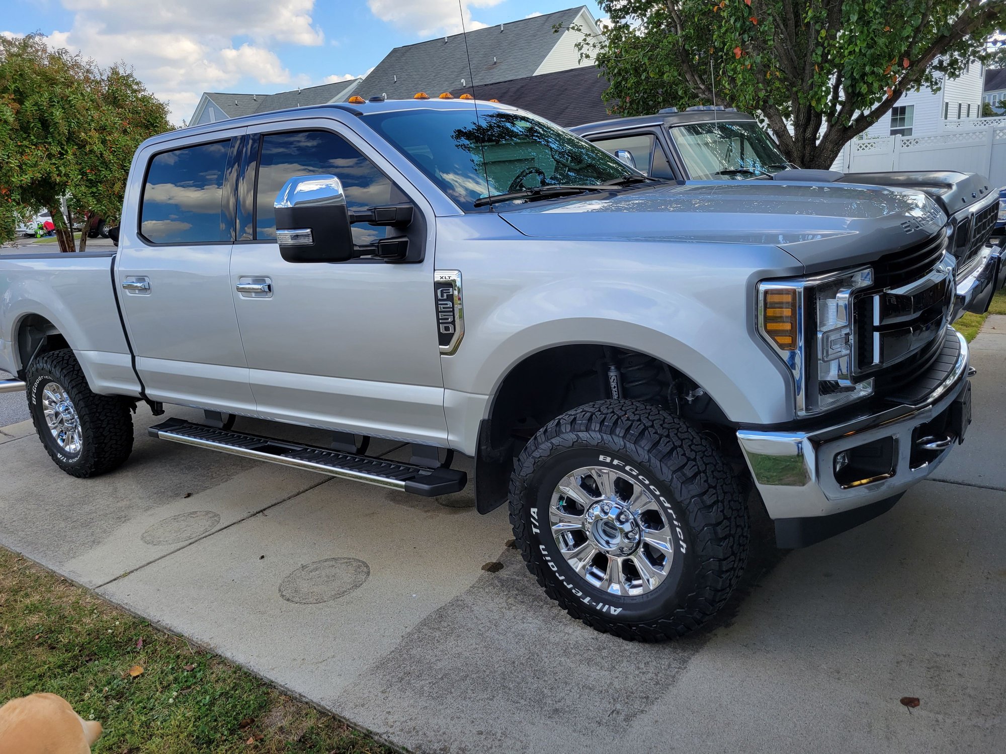

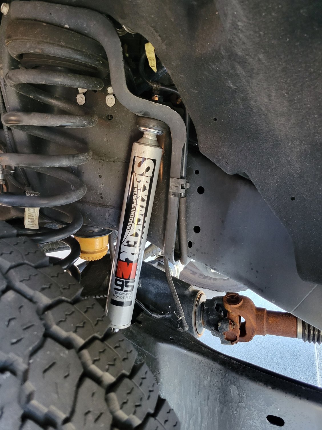

I bought a 2019 F250 with the snow plow prep package new is Feb 2020. That suspension was very harsh. At about 6k miles, I swapped over to Skyjacker N95 shocks and dual steering stabilizer (and 35x12.50R18 BFG KO2s and a one inch level kit). The ride did improve quite a bit but it was still a little rough. Before I swapped the shocks and all, I got death-wobble a couple times. After the swap, no more death-wobble.
So, in your opinion, what fixed the death wobble? The dual dampers, or the shocks... or both?
