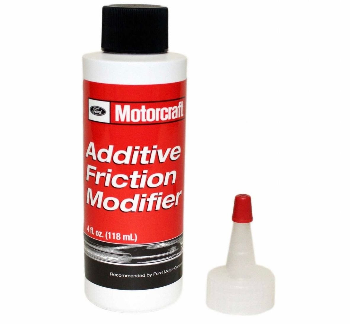

Youn need more friction modifier
Add one tube of the Ford stuff at a time until the clicking and ratcheting stop

As stated add more friction modifier, and that SHOULD help. But I have had personal experience with a gm limited slip that was never happy with synthetic fluid. Tha specific vehicle wanted old Dino sauce 80w90 and a friction modifier in order for it to not chatter in turns.

After adding another tube of friction modifier you take it to a parking lot and do a few figure eights
That will work / exercise the clutch packs, and get the added friction modifier worked into the clutches

The labels always say you need no additional modifier
Hell, Ford says you only need one tube of theirs (the real stinky stuff) which is flat *** wrong
I only use one bottle and never had a problem.
Geez. That is the smallest I could make it.
