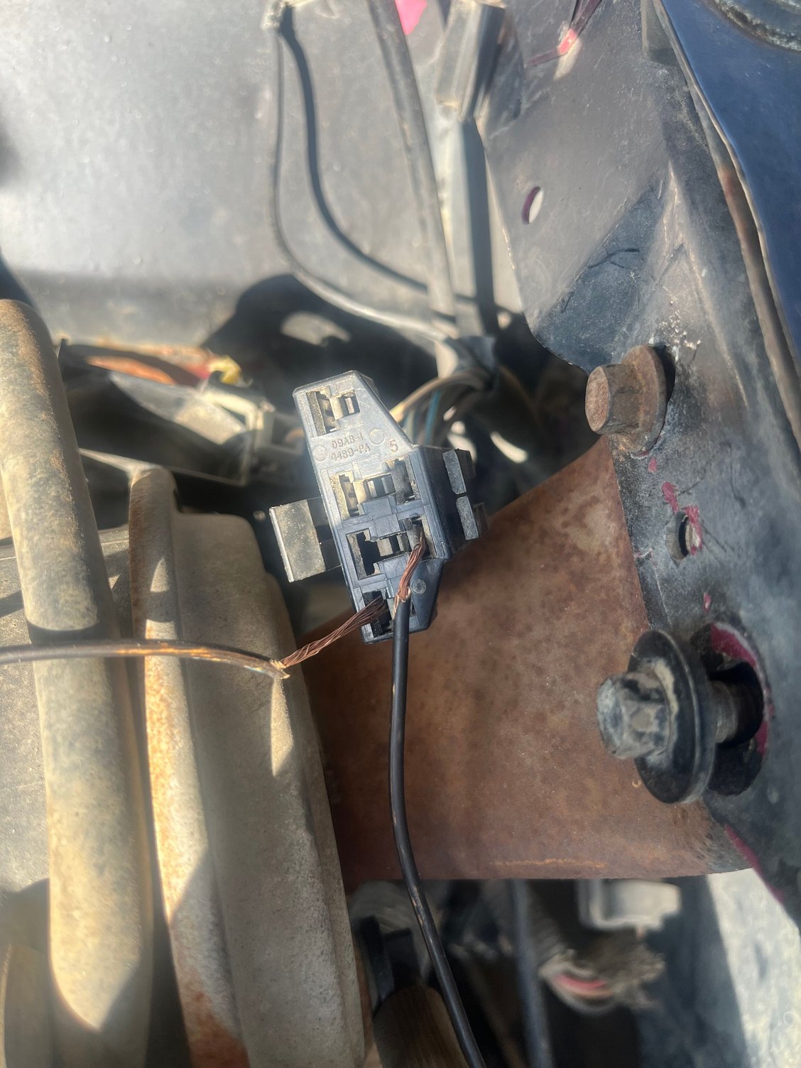

Jumper Pins 2 and 6 on the diagnostic link under the hood, then turn the key to the Run position. The fuel pump relay is supposed to energize and stay on with the jumper in. This is a basic test to verify the fuel pump voltage supply circuit is good. It removes the computer from the equation. Now is a good time to invest in a DVM and simple incandescent test lamp.
Pins 2 & 6:
courtesy of Subford
I did what you said now the pump works but it still only runs on starter fluid

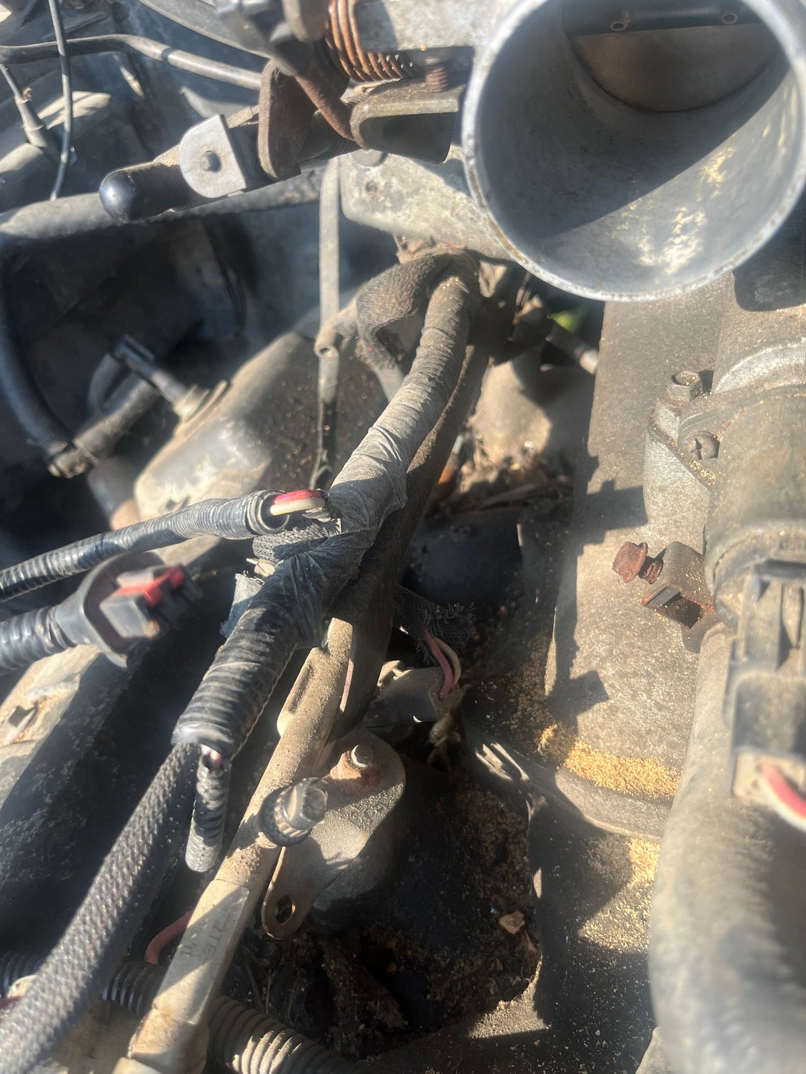

ok I have a wire off the passenger side fuel rail that’s stopping it from running where does it go?
Show us a picture of said wire. You said the rear pump didn’t work so how did the front pump continue to work without this wire?

Once I did this connected the 2 pins together the pump turned on
That’s the wire it comes off of the fuel rail it was off when I got the truck
