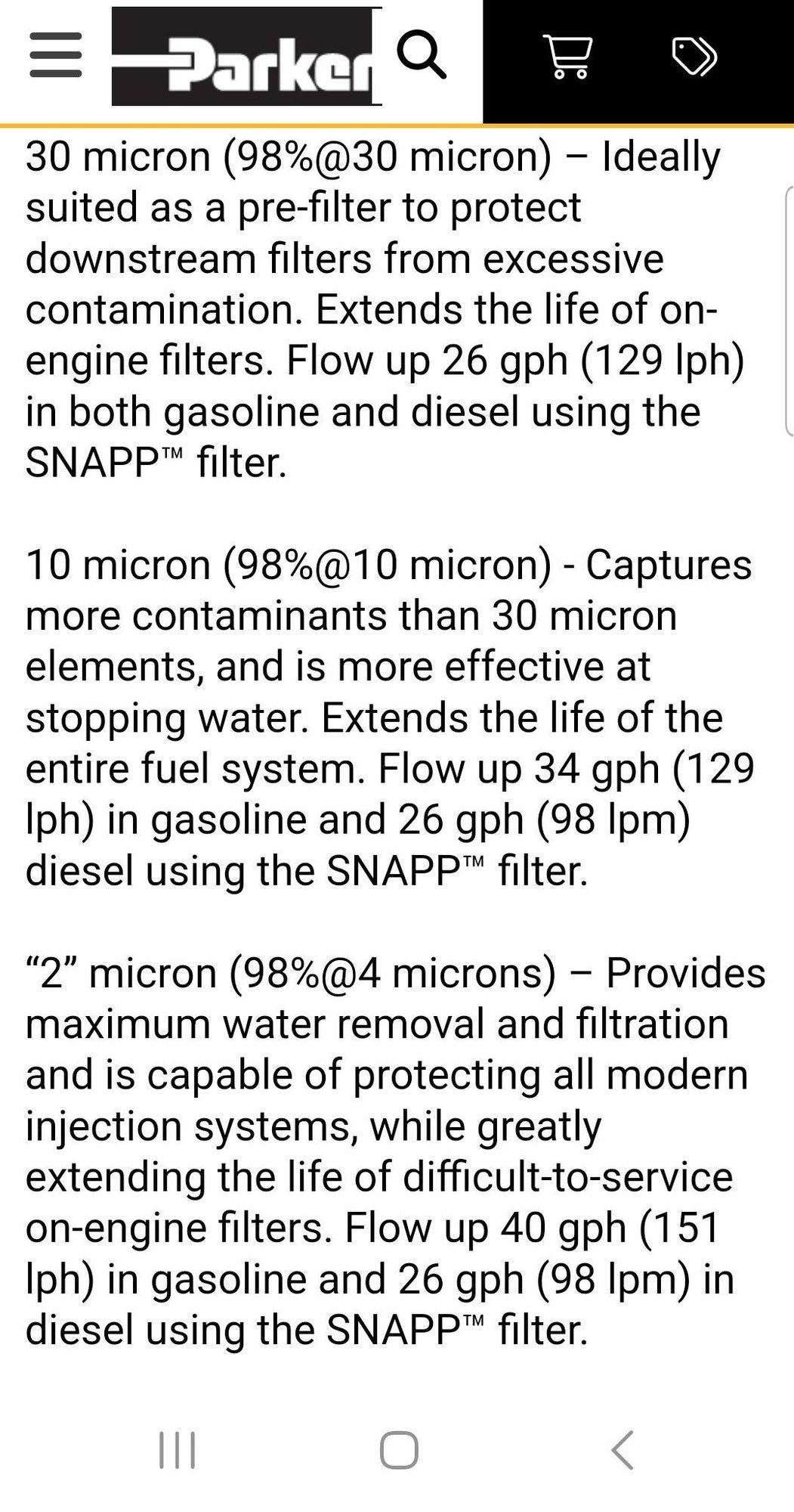

Okay here's the product page link for the Parker SNAPP filter...
https://ph.parker.com/ca/en/product/...acor/r23107-30
They also have a water separation media in them as well.
Screenshot from that link;
Interesting to note that the "2 micron" filter is actually a 4 micron at 98% efficient filter but that's been discussed before about the change in specs due to something... I believe Rufus was the one with that knowledge.
