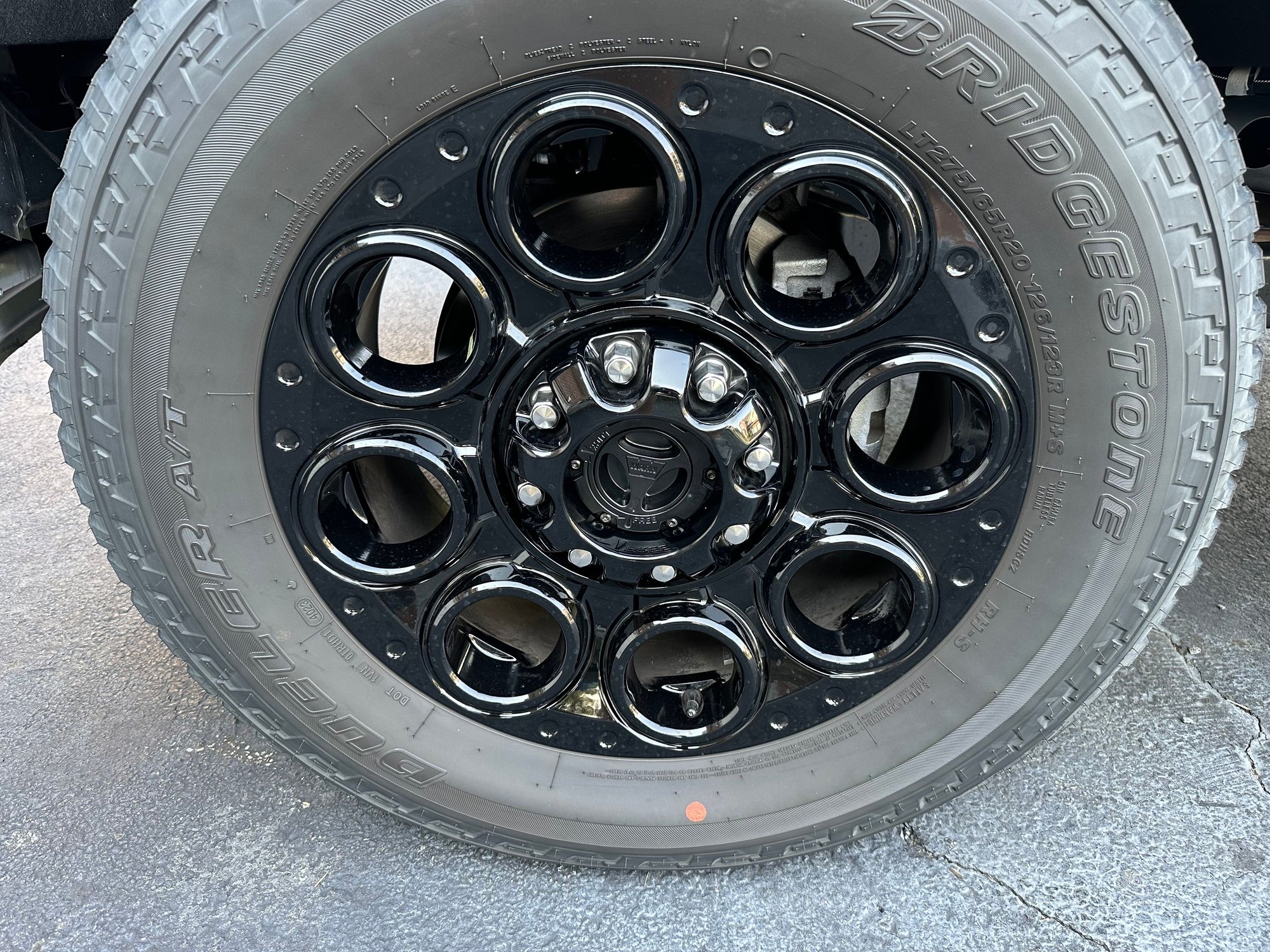

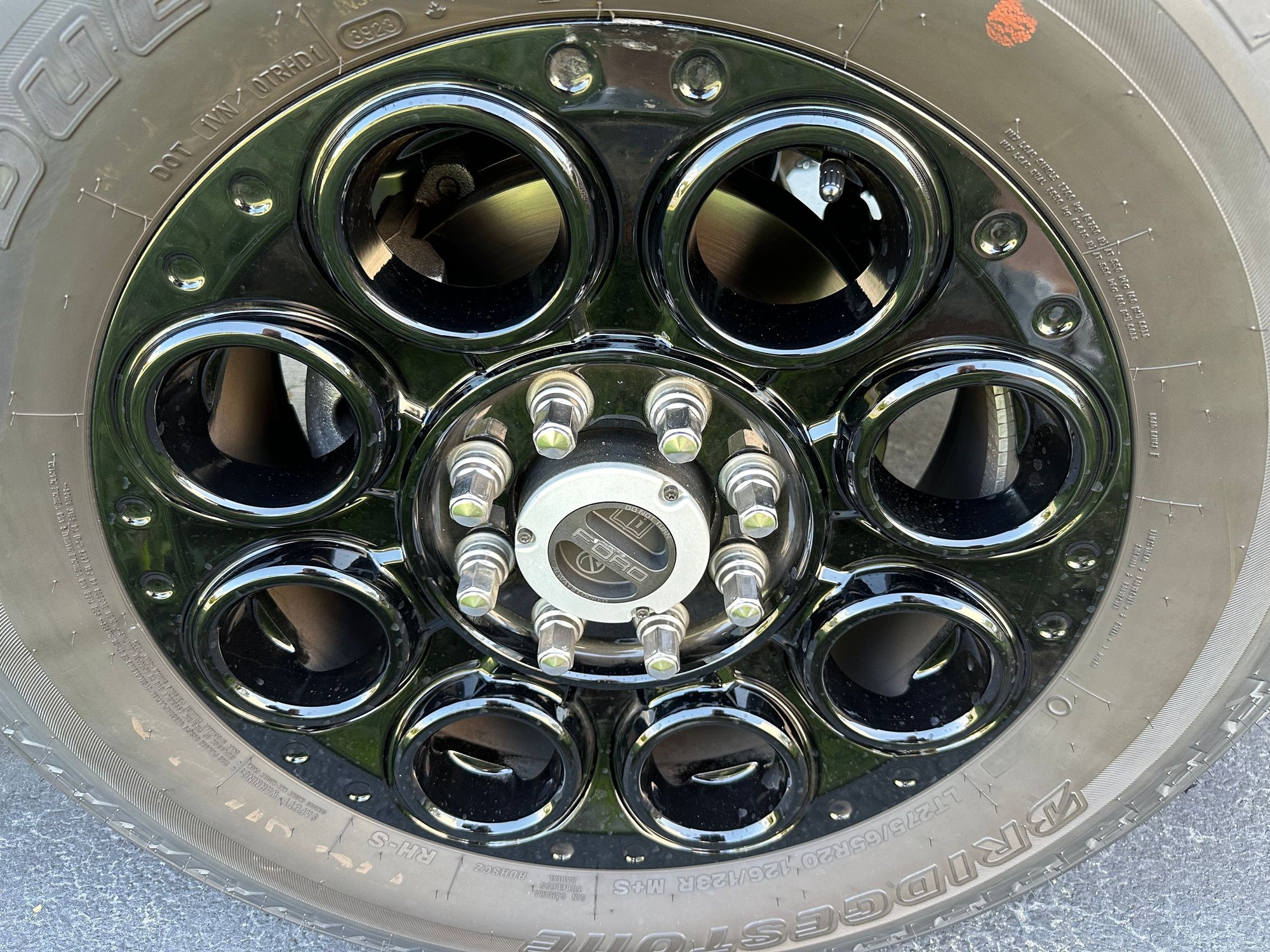

Get the Warn hubs. I already swapped them out on my 24 to ditch the dummy hub.
There are 2 part numbers which are exactly the same but about a $100 difference in price. Warn direct and Ford Performance which was a sticker over the Warn part number.
