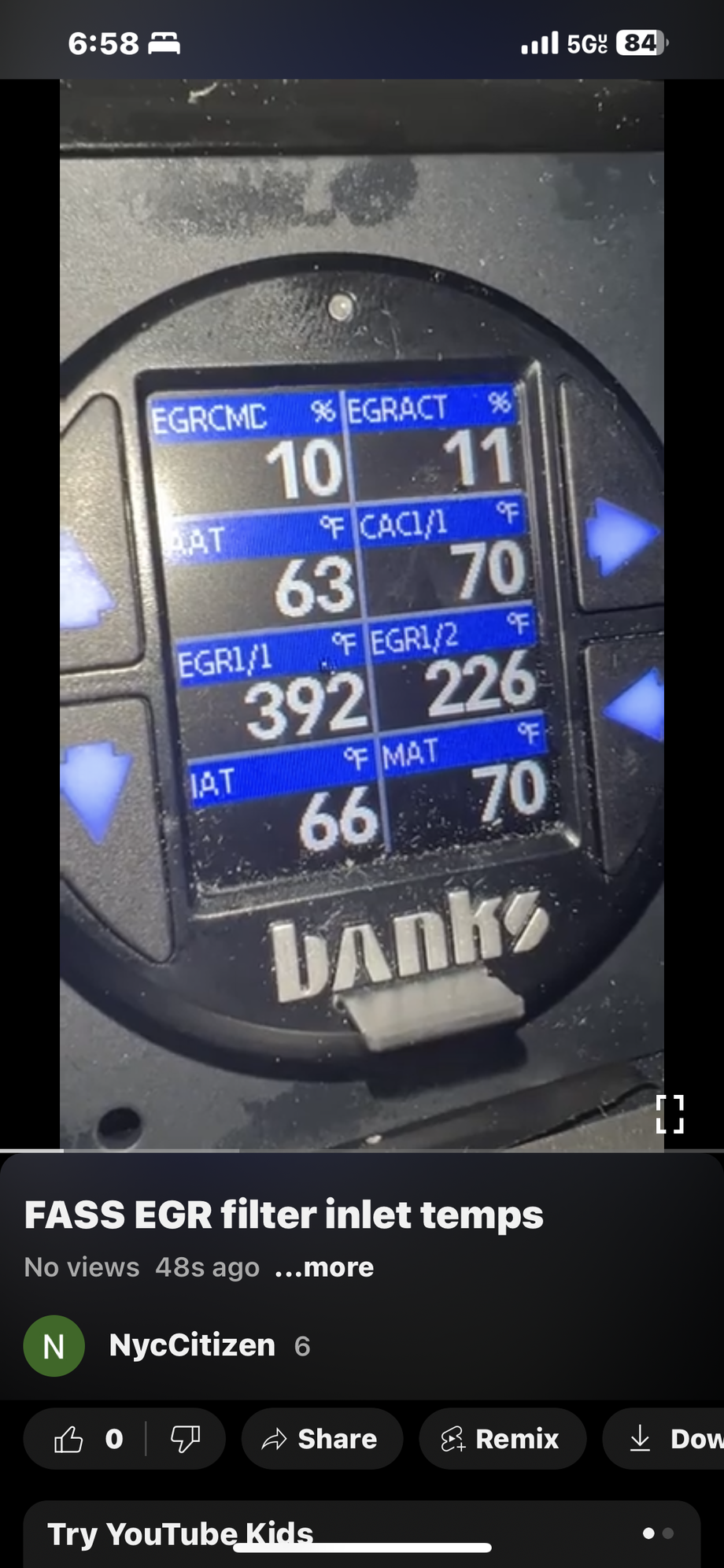

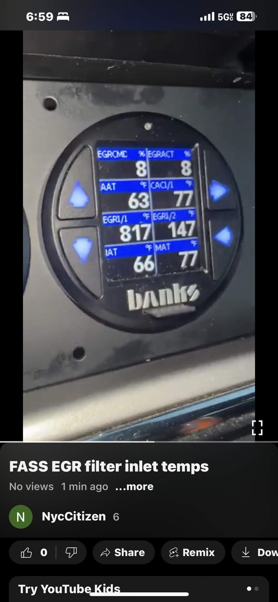

Originally Posted by Conner58
So where does the stuff in the filter go ?
I'm guessing it goes in the engine ?
temps in the filter exceed temps needed to passive regen …so the filter is in constant regeneration and burns off the soot.
With out this filter….the egr system is constantly injecting your intake with soot.
What does that do to underhood temps?
the filter is about 1” from the cooling fan.
my numbers indicated on the idash for IAT and manifold show now change.
IAT is before the EGR flow....I wonder what kind of temps are going into the intake with the erg/exhaust heat
IAT measures intake air after intercooler and before throttle body.
there is no change
