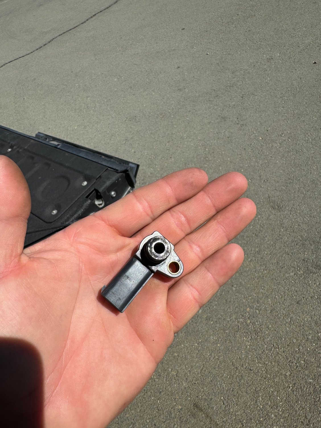

Dirty MAP sensor. Check yours now.
Quick and easy thing to do/clean to your 6.7s. Short story long, I saw an AD for S&Bs new map sensor spacer and bough it. Had it shipped to my AZ house and then installed a week or so later. Check photos. I’m not sure if I want to hear/feel a difference in sound and feel but I think I do. After I fired it up I swear it is idling quieter and after I drove it on the freeway my truck has never showed 16 current MPG while I was driving on the freeway. But now it does. I do have a lot of miles (182k) but it’s easy to check & clean. Would recommend!!

Originally Posted by Gwilkrrs
well thanks-
i dont even know what this is but at 150k you have peaked my curiosity
top of the big ****ty plastic intake piping
It's aluminum on the 2020 and newer trucks, fyi.
