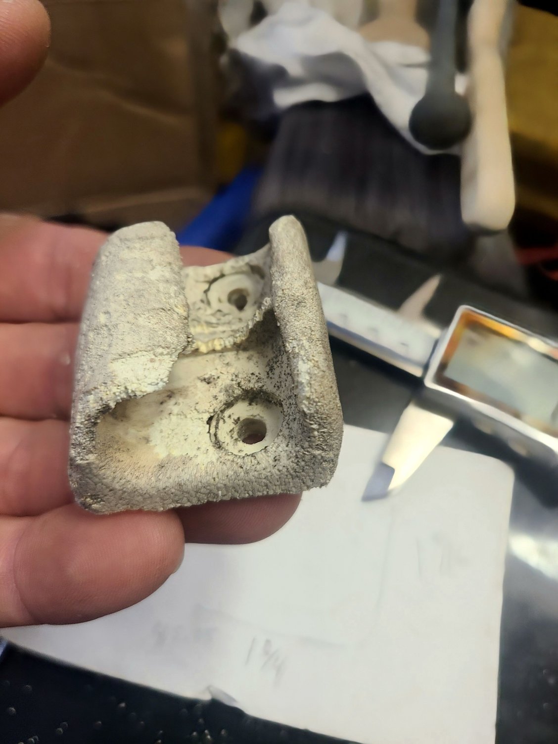

So as I am beginning my restoration journey I am finding out that some smaller parts are very reasonably priced but that the shipping cost sometimes is as much and often more than the parts. I began messing around with 3d printing a couple of years ago and was surprised not to find any posts involving 3d printing on this site. Am I missing it or is it just not a thing? I am certainly going to give it a try for some of the parts I need. Especially for those parts that I do not want to buy used as they will be just as old as the ones that I have that are crumbling when touched, i.e. the doom light cover, visor retainer etc.
If I am somehow missing it can someone point me in the direction of a 3d printed parts thread?
If there is none I am happy to start one if I begin printing parts. Of course the parts that I would print would mostly be interior parts and hacks. It does take time to design the parts before printing which is why I am looking to see if there is already people doing it because those parts are usually shared freely as long as they are not used to sell. I did check some of the common 3d printing sites and did not see any designed parts.
I may try to replicate my visor retainer clip this week and will update this post accordingly.

So I went to replicate the part in with CAD and decided since someone else had already made one I would pay the $4.00 to download it as it would have probably taken me a couple of hours to recreate in CAD. I printed the part which took 33 minutes and will give it a try when I get home today. Not including the cost of the design the total amount spent was a whopping $0.44! I am not looking to start a side business but am willing to share any design files that I create in the future as I can almost guarantee that I will be making other parts.

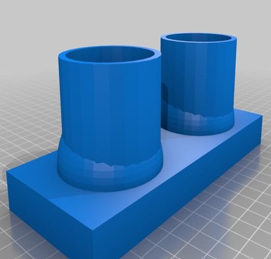

I designed and 3D printed AC duct adapters out of necessity. Being a beginner at CAD they are basic but work well. Below are a couple of posts related to the AC adapters and a link to the files on Thingiverse. The files have been downloaded (for free) over 350 times so hopefully have been of use to the community. The only other item I have 3D printed for my truck were fuel door bumpers out of TPU.
https://www.ford-trucks.com/forums/9...l#post18872592
https://www.ford-trucks.com/forums/1...t-ducting.html
https://www.thingiverse.com/thing:3887203

If my printer was set up for ABS I would be more likely to use it for car parts. Since I am printing only with PLA currently I wouldn't use it for that purpose. PLA would be okay for prototyping, but anything I planned to install permanently I wouldn't trust PLA, it delaminates too easily and you can't really sand it or expect paint to stick for very long. At least with ABS it will hold up a lot better, can be sanded and painted.

I definitely agree. I printed this part in PLA just to check the fit and because I don't have any white ABS on hand. I will definitely be using ABS for parts if nothing else because of the incredible heat in SC!
