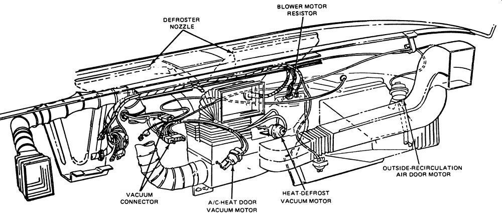

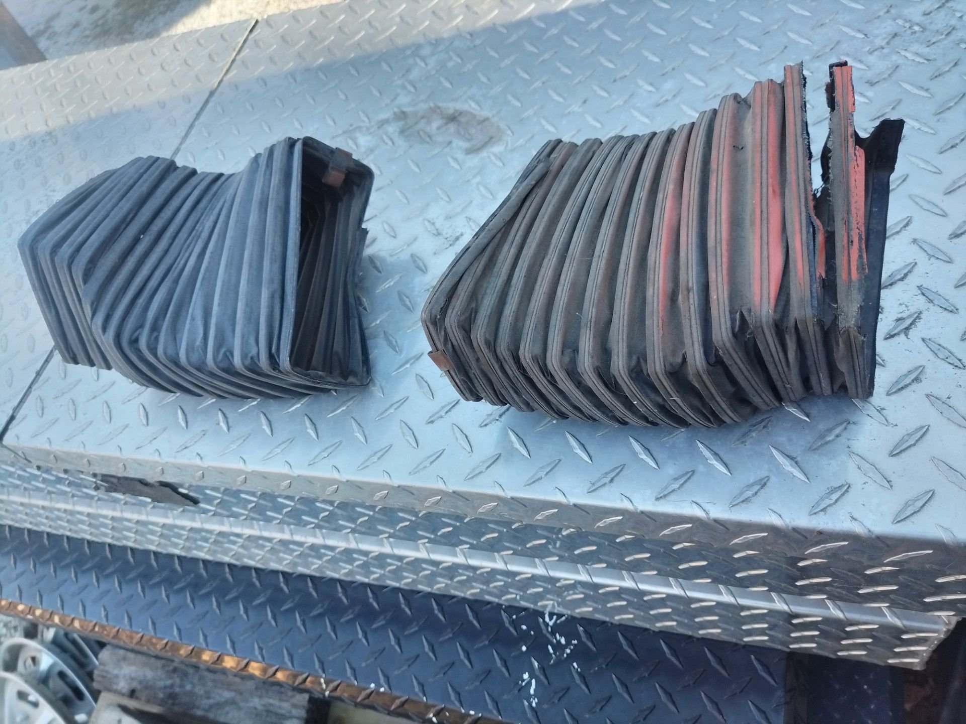

I have a 78 F150 with factory air. Problem is the flexible ducting located behind the 2 center dash vents has crumbled away, Does anyone know of a source for this flexible duct? I have my dash all opened up but can not find the replacement part.

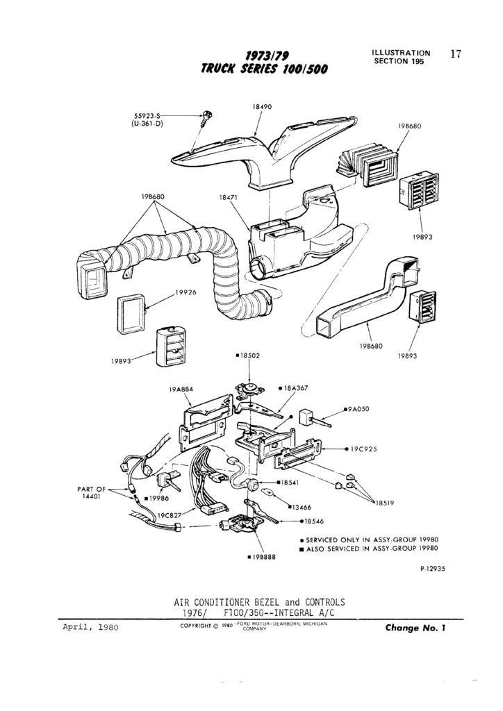

You just need 19B680 correct? If you can not find one in the links from Red Road, I am sure I have one or 2 on my parts stash. And I seem to remember one that is like new. Off to the parts shed to get eyes on it.

Yes! That is the duct I am looking for. Do you have one available?

So you ordered the actual duct or the 3D adapter? My 2 spares are not as good as I thought. Well one (L/H) is re-useable with a little taping. The other is if you are motivated to use a certain amount of duct tape. Speaking of duct tape, if you need the good stuff and some better than Gorilla tape, use T-Rex tape. Let us know how well you like the 3D set up and how well it works for you.
