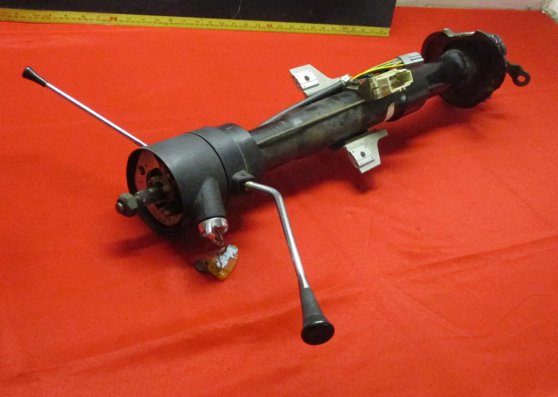

eBay is your friend for the location of parts that are difficult to see. Here's a complete column sitting on the bench:
https://www.ebay.com/itm/276655963298

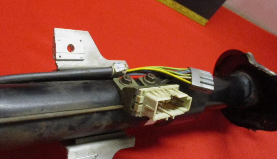

A purloined view of the column, with the switch at an angle in the middle. You can also see the control rod between the key cylinder and switch. Normally this control rod is hidden by the shroud on the column:
Here is a close-up of the switch and the two nuts securing it. The curved connector to the right is for the turn signals, not the ignition:
