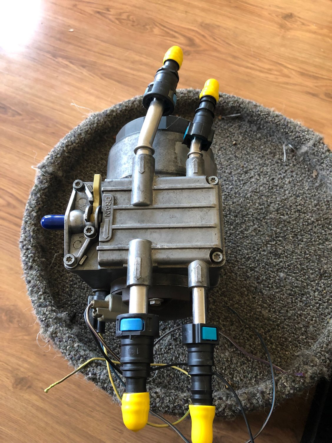

Fellow 6.4L Fans:
I am unable to turn the lever on the water separator valve to drain any water out of the unit. If I remove the sensor, won't its removal also allow the same thing and drain most all water from the unit? I realize it is located slightly higher than the drain, which may prevent a slight amount of water from being drained.....but getting most out is better than none........
Thanks in Advance, Guys!

Honestly your best bet here is to remove the whole fuel pump module and bring it to the bench and clean it really well, take the side off and you’ll find a massive snot thing where the WIF sensor is and the drain hole is. Generally if your getting WIF messages and draining it doesn’t help it’s because a pile of crap builds up and turns into a snot ball that confuses the sensor.
Motorcraft CG810 is the gasket set you’ll need.

You shouldn’t need any disconnect tools, the lines have blue release tabs that you push in (top and bottom) and just pull the line off.

Plan for a fuel bath as you can’t drain the fuel out of the fuel pump module or the fuel filter on the engine, the lines could syphon on you, I’ve heard it’s less likely the emptier the tank is. The lines should reseal, there is I believe 2 o-rings in each connector, not sure on size but they resealed for me the few times I’ve done this, be gentle to the lines so you don’t kink the plastic line part and possibly crack it.
Always try and clean the connectors out before you remove them, brake clean into the ends, twist the lines a bit back and forth, wiggle, push the blue buttons a few times to help loosen any stuck dirt, brake clean again then pull them off.
