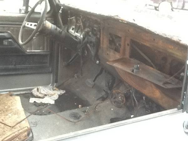

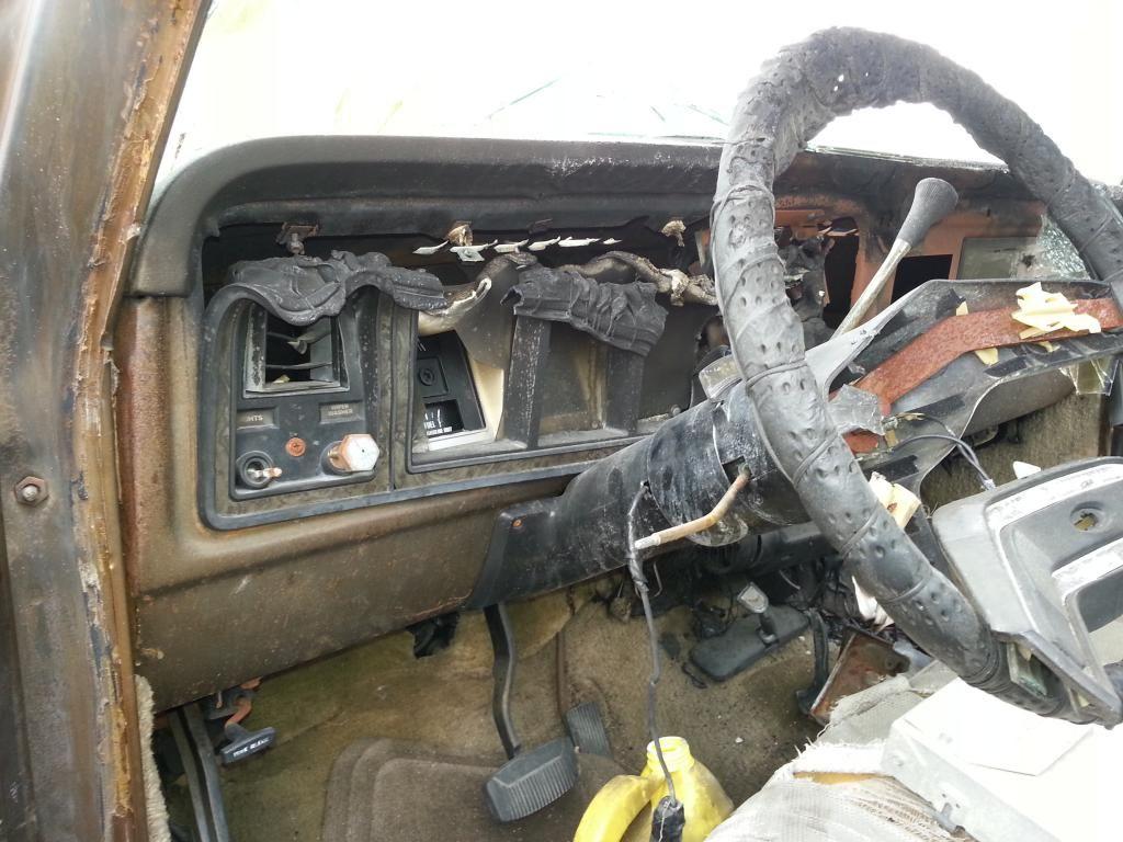

Before you get all those new parts put on, you might want to do some trouble shooting, so you do not burn up those new parts or your whole truck. Super hot wires, smelling insulation burning it a sign of a BIG problem that you need to address, sooner than later. You must have an intermittent contact of some bare (hot when power is applied) wires causing a dead short. Do you have any burnt fuses, any fuses that are wrapped in foil?
Could be a mice chewed something behind the dash, or under the hood. Something is rubbed on something else. Like hot exhaust manifold or exhaust pipe. I suggest that you get to looking up under the dash for signs of melted or burnt wires. If you can smell it, I think behind the dash is the best place to start.
Do I have your attention now?
