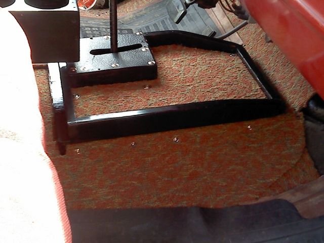

Then a very few years ago, I added a hump cover I made.
I'm pleased.

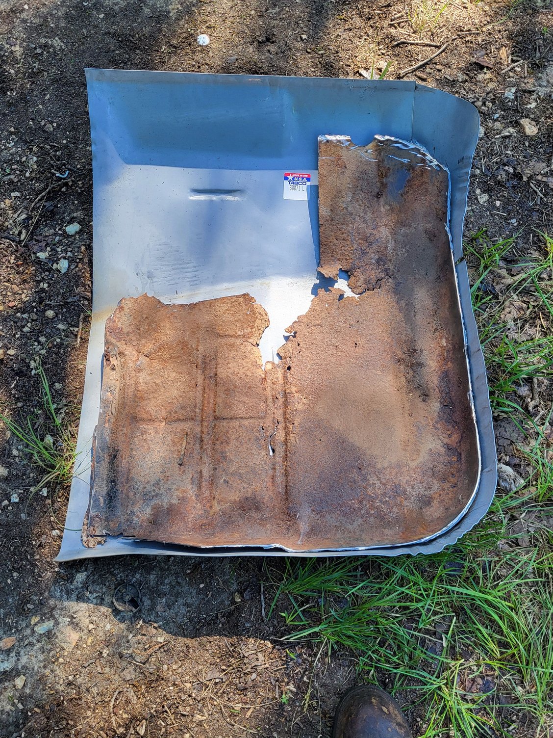

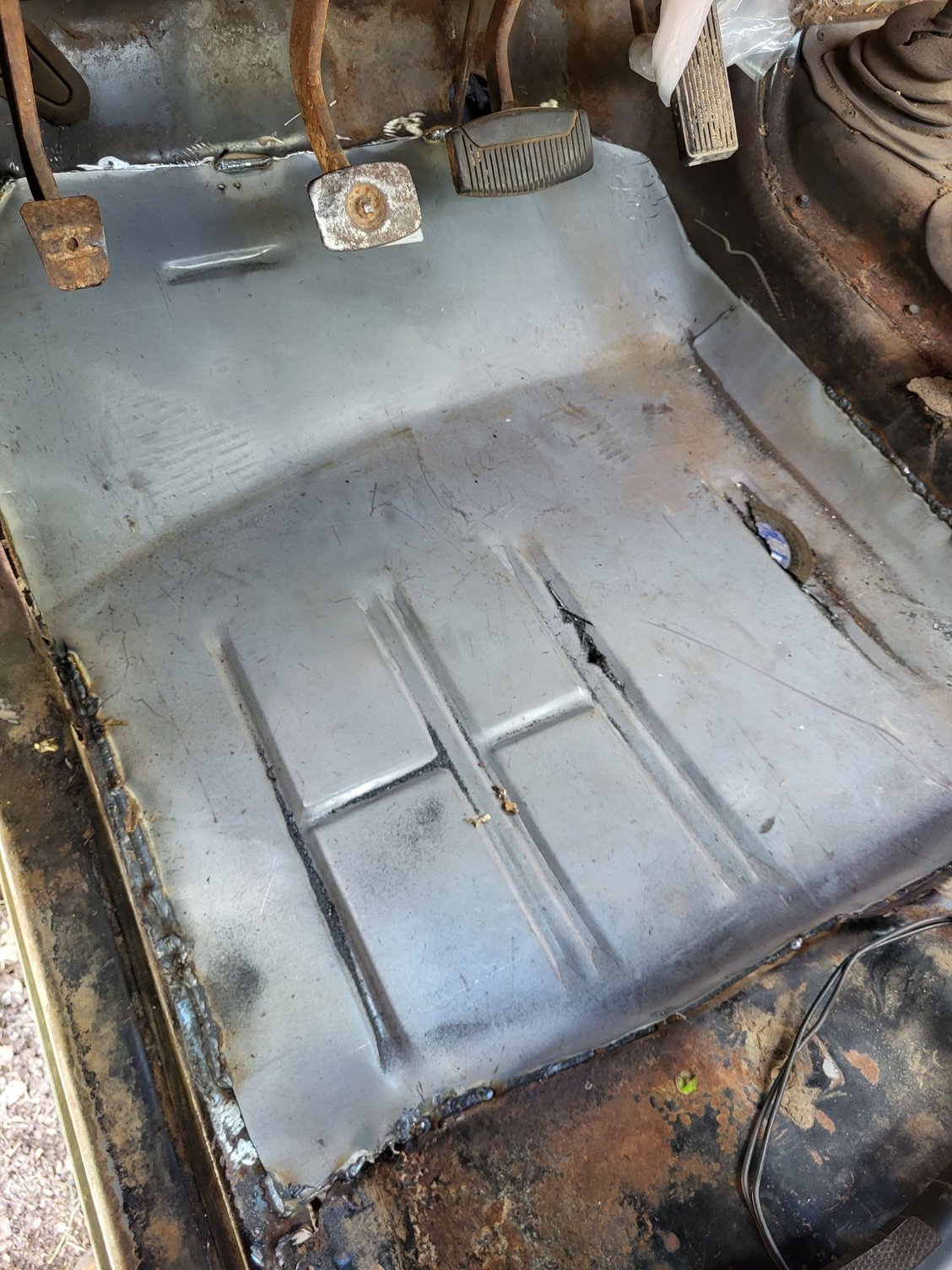

Did mine a few months ago, well mostly. Never finish welding the drivers side in completely, it's a solid 85% welded.
I did finish the passenger side though.
These are Tabco floor pans. I both recommend & don't recommend them. They fit great & are of thicker material that others (18ga) & used a fancier coating as well. But it was a several month wait to get them.
I also went with a butt joint for welding them in rather than a lap joint. Bigger pain to do, but also nowhere for moisture to hide.

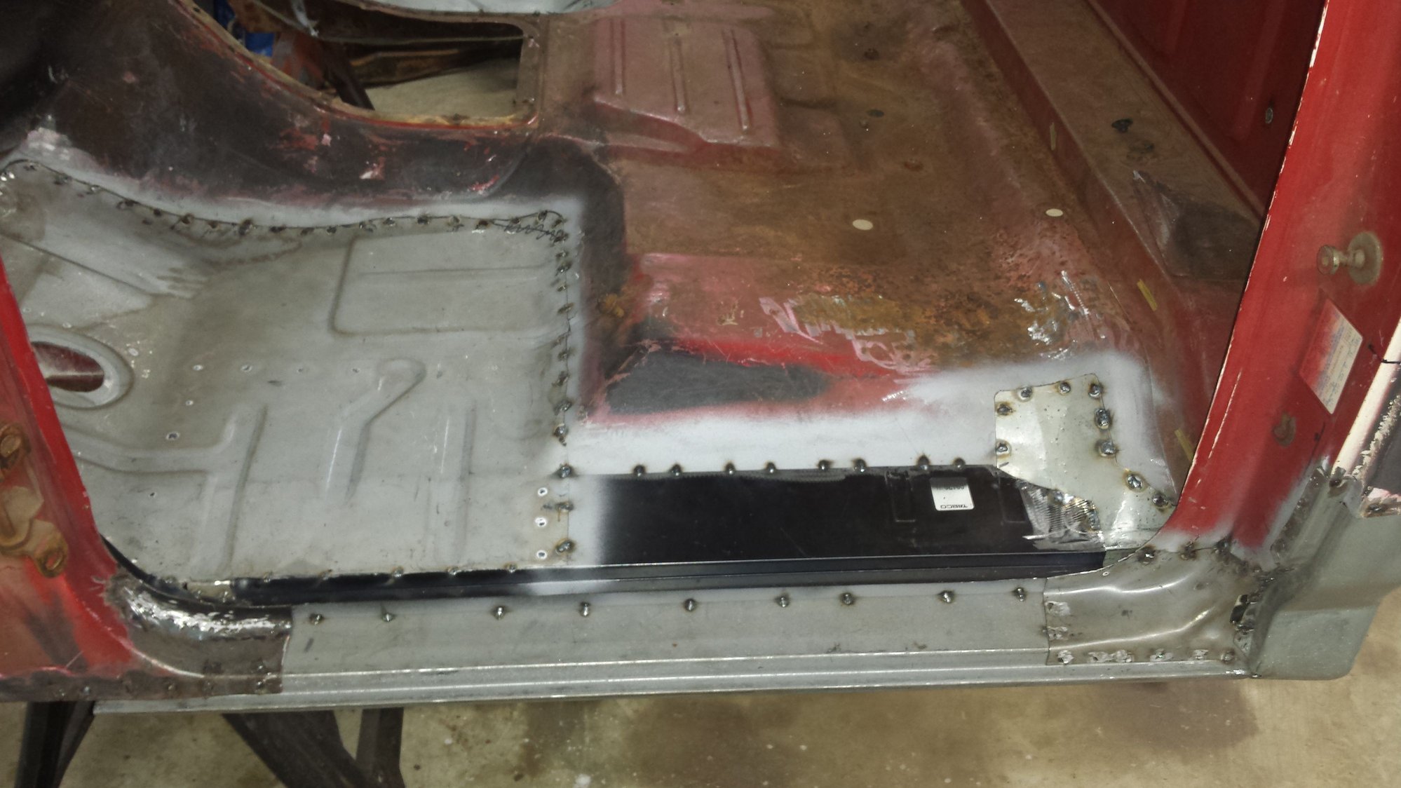

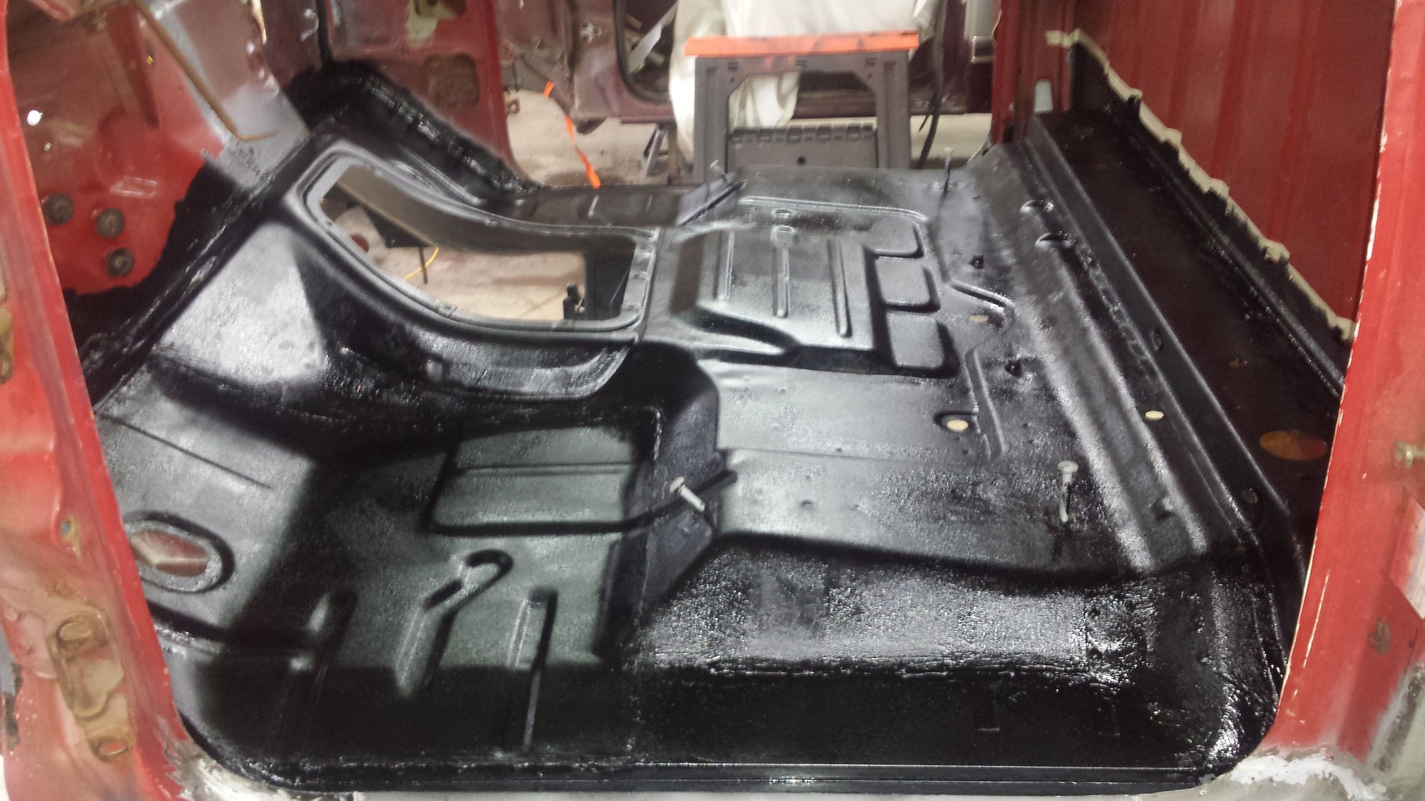

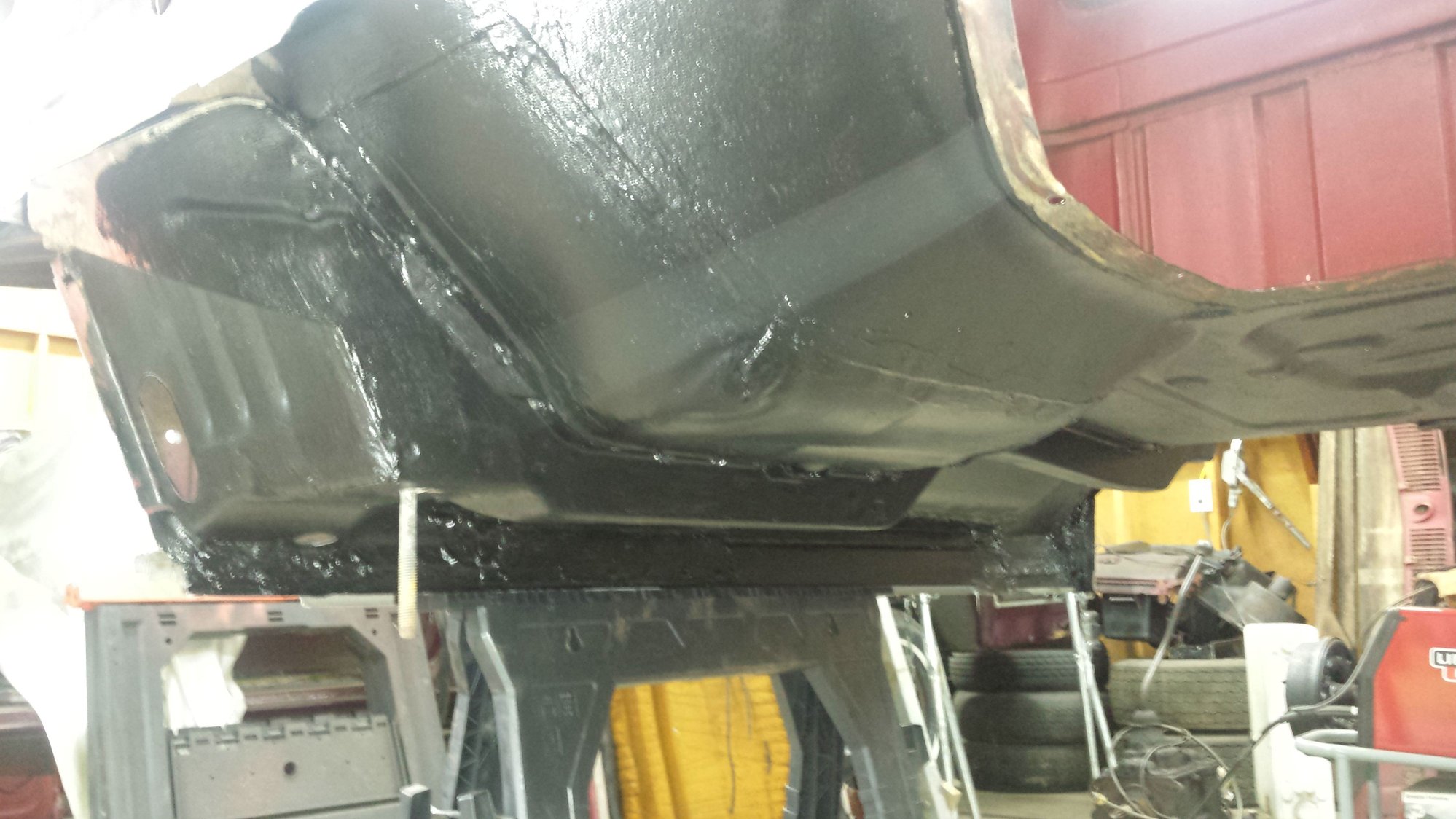

If you over lap, I punched holes around the out side to plug weld the patches in.
I then used 2 coats of seal sealer. First with a tube / caulk gun to force the sealer in between the panels top and bottom.
The 2nd coat was a brush on and again top & bottom.
Then I did 2 coats of roll on bed liner top & bottom.
If anything gets between the layers I should be long gone
Both sides were done the same way: floors, rockers, cab corners, rear door post to rocker tie in.
