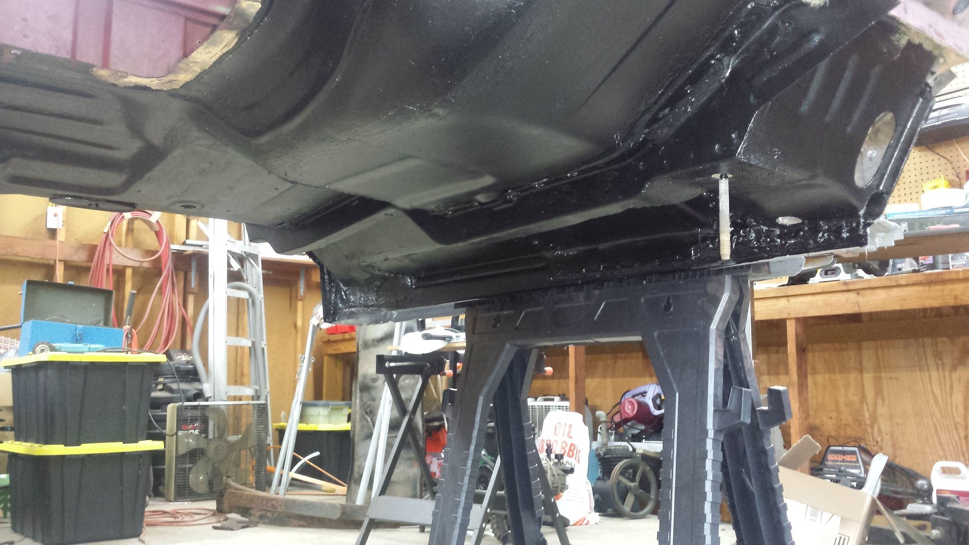

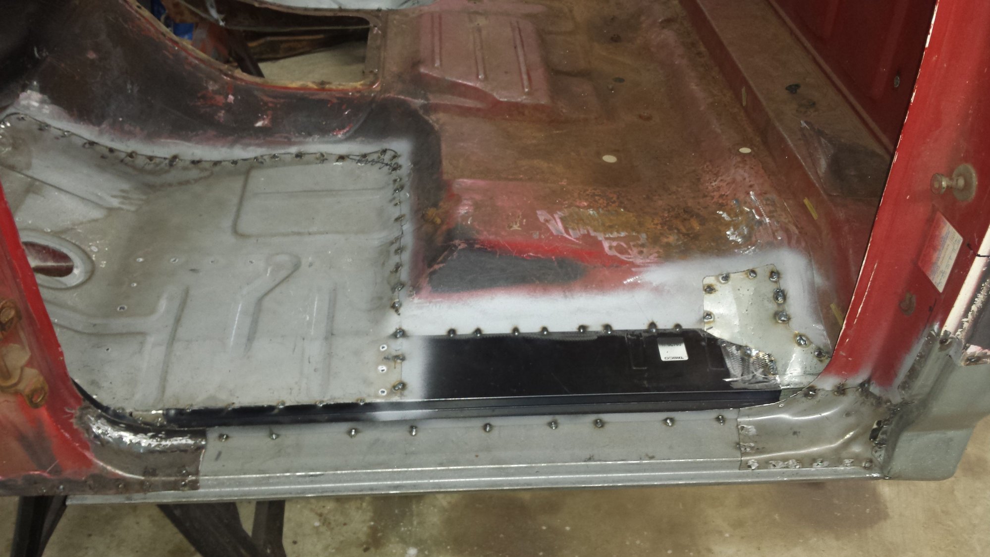

Here is the right side cab mount with the floor removed
I used a air hole punch to put holes around the outside of the panels and then plugged welded them to look like factory spot welds.

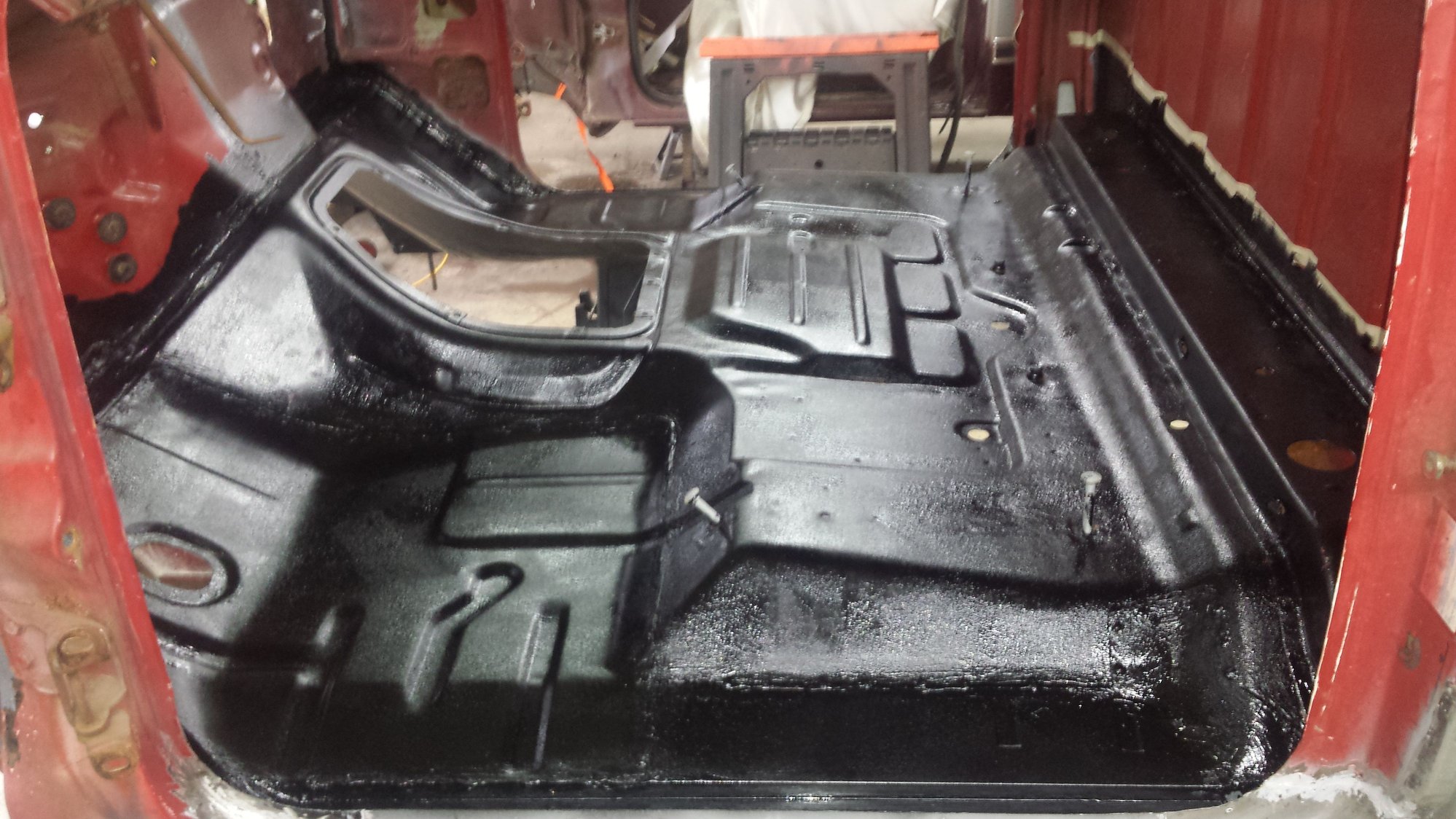

Yes I over lapped the floor as this truck is a driver and it was easier to weld.
I did 2 coats of seam sealer top & bottom then 2 coats of roll on bed liner top & bottom to make sure the over lap is sealed.
