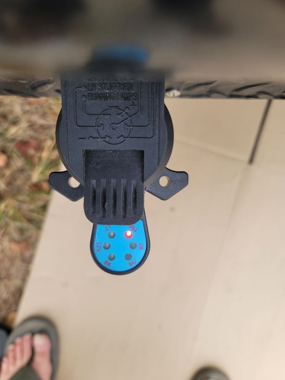

I have a 7-pin tester that I use for a quick test
Here it is showing TM or Running Lights - Trailer Marker they call it
and here the LT blinks, but none of the other pins work.
I have a Lisle Test Lamp probe to see if the other pins are live, they aren't.
