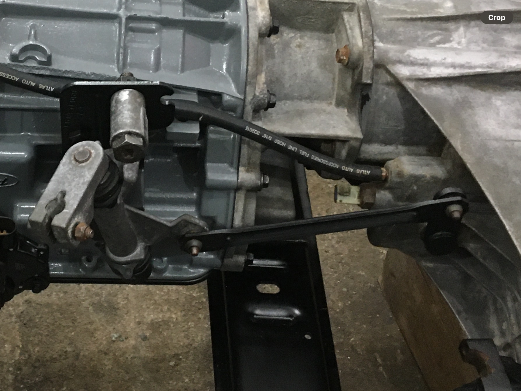

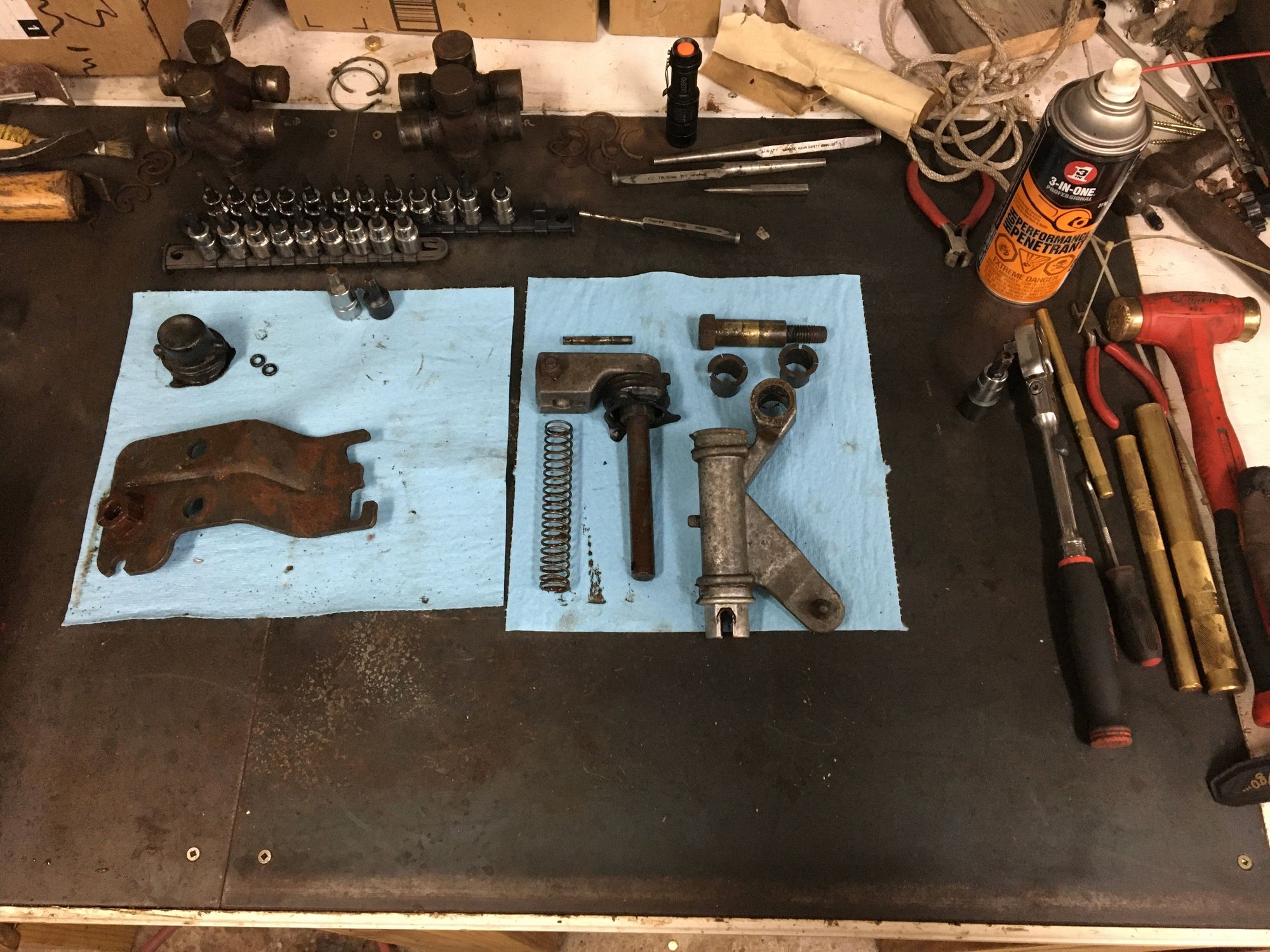

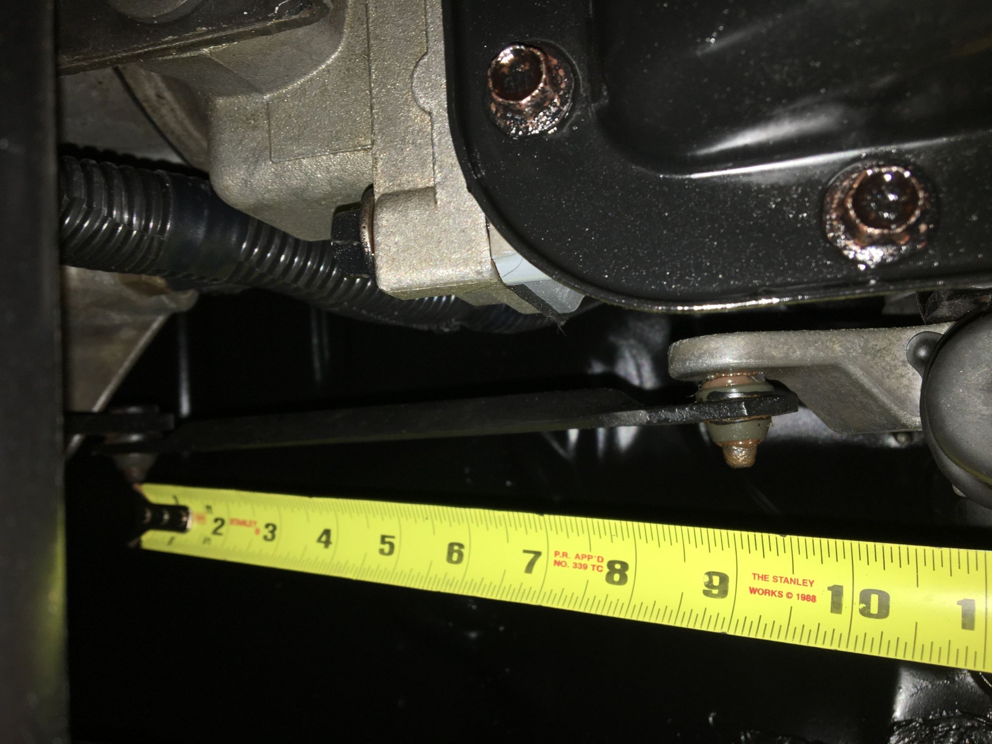

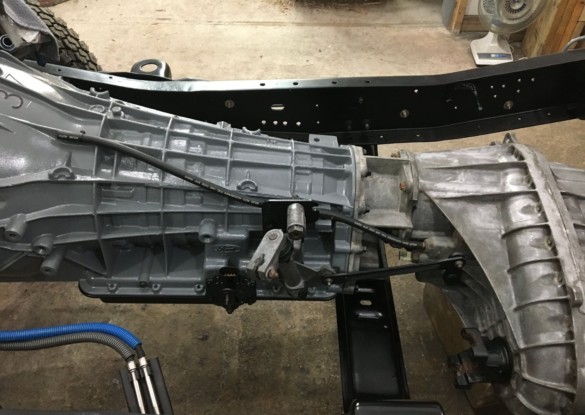

My 1996 351/E4OD is 9” eye to eye. That shift mechanism looks the same as my ‘96 as well.
You could still buy the plastic grommets for the linkage somewhere just a few yrs ago. I can’t remember where - torque king, or JBG.. in case you’re looking for one.
Couple pics in case it helps.
