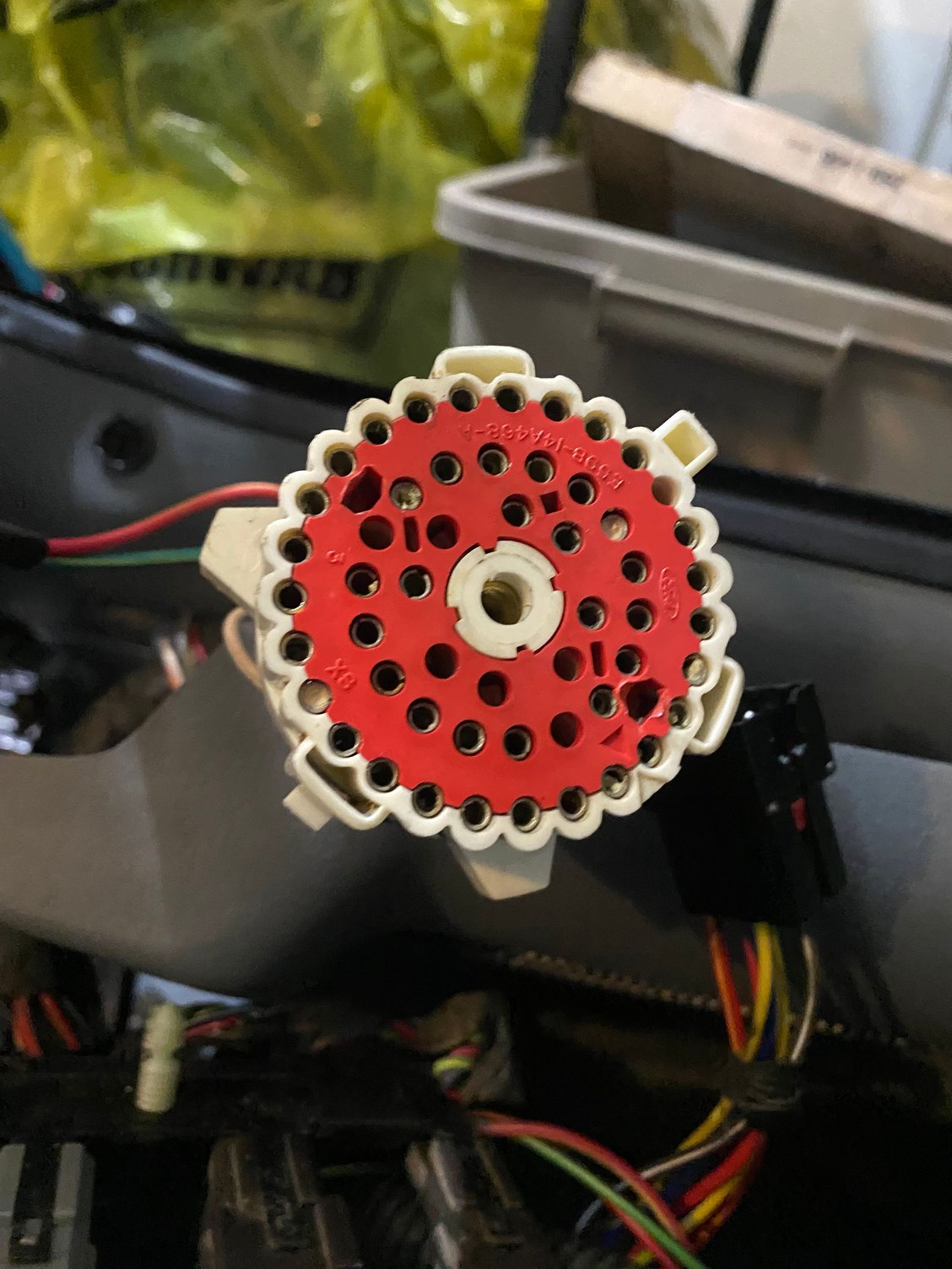

Hi guys,
Wondering how to repin the big firewall plug on my 91 truck? I pulled a dash out of a bronco to replace in my f250 and need to add the fuel tank selector switch and wiring from the old dash. How do you get the old wires out? Thanks!

Remove red retainer. This will give you access to the individual wire retainers. In order remove a wire release the retainer with a small pick or flat head and pull the wire. When you reassemble make sure all the wires are secure.
Exactly what I needed, thank you.
