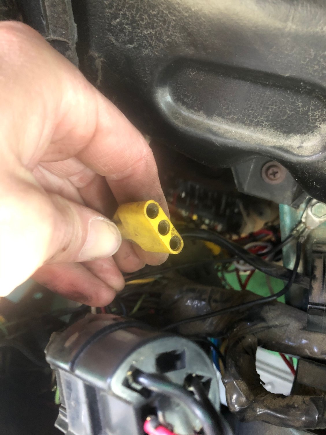

I was installing a new wiper switch in my 79 F150, and while I had the dash apart, I found this plug to nowhere which seemed to be coming from the factory wiring harness. Couldn’t find the male end, but everything seems to be working. Any ideas?

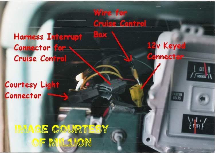

That is a 12v keyed power plug.

Got it, Thanks. Just for curiosity’s sake, what’s its purpose? Accessories?

Exactly. I used mine for my tachometer.

Same here, wired in for my tach, volt meter, (didn't want to go all the way to the battery) and I think something else as well.

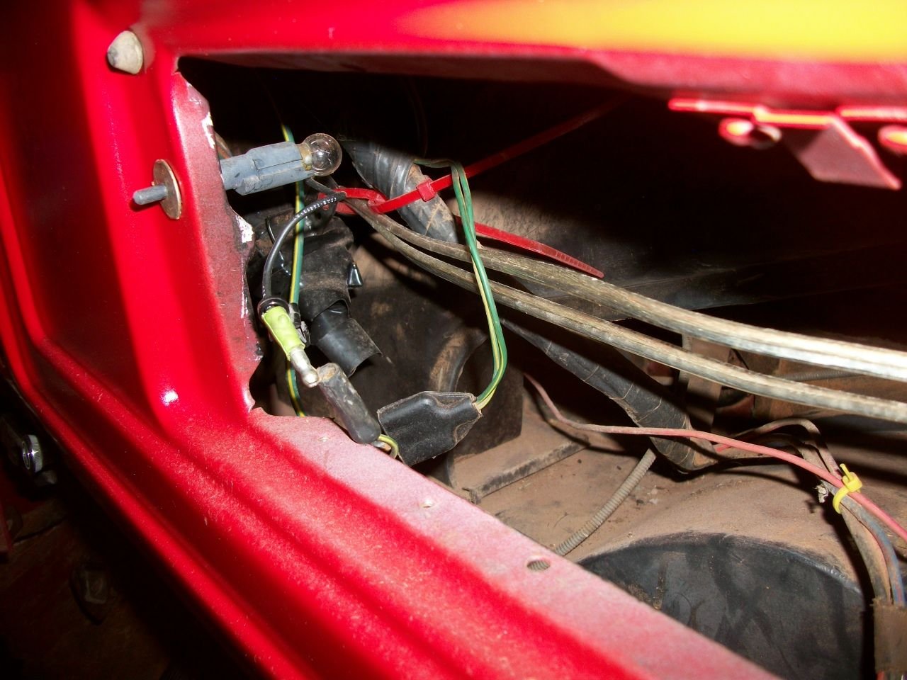

Yes there is one behind the glove box (black color) but it is constant 12v hot. Used for the glove box light, cig lighter. Which is a 1 male plug and a Y to the cig lighter.
