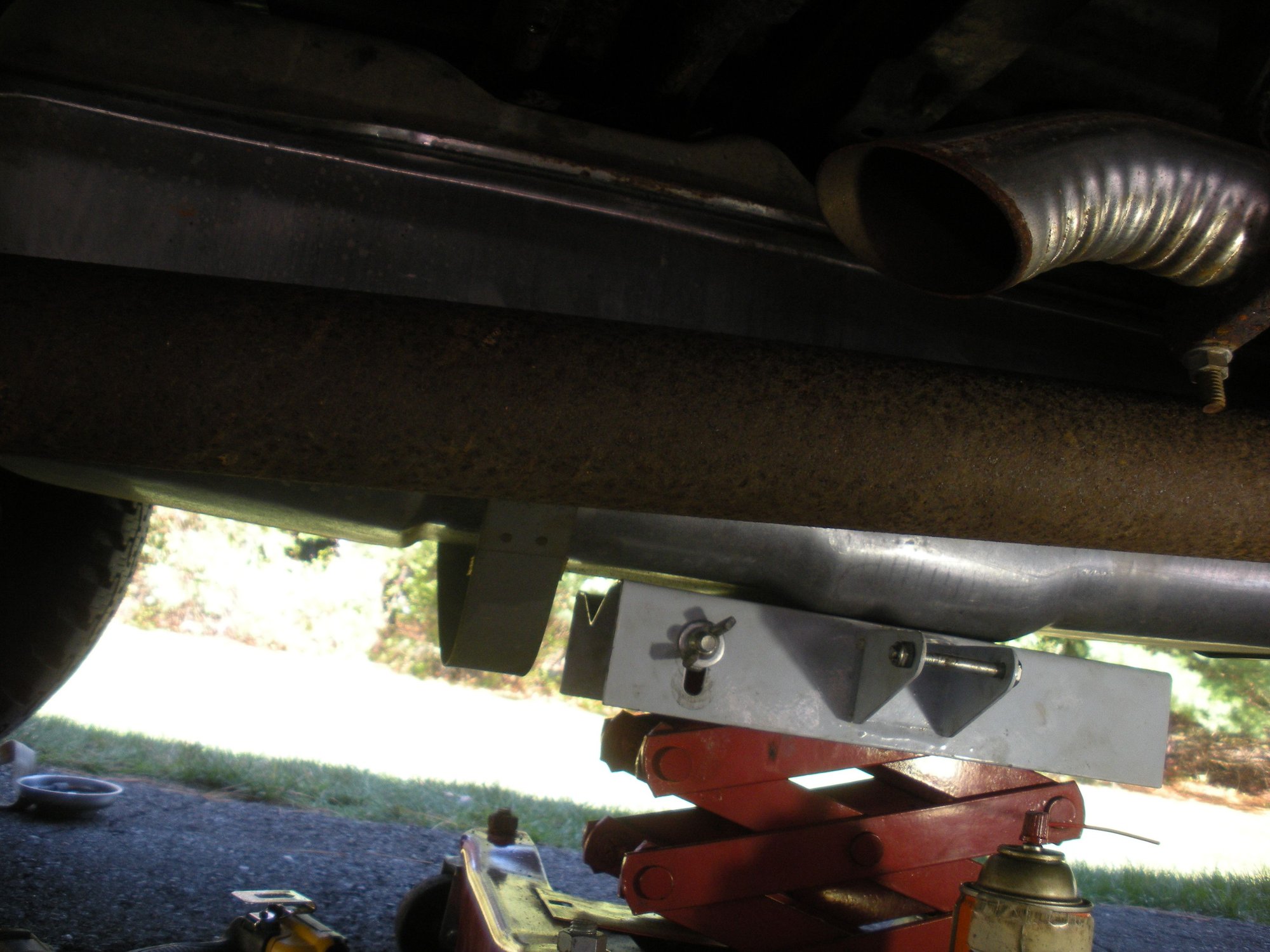

For help with the tank, I used my tranny jack from HF. I think it was like $30.00 when I bought it...many years ago.
