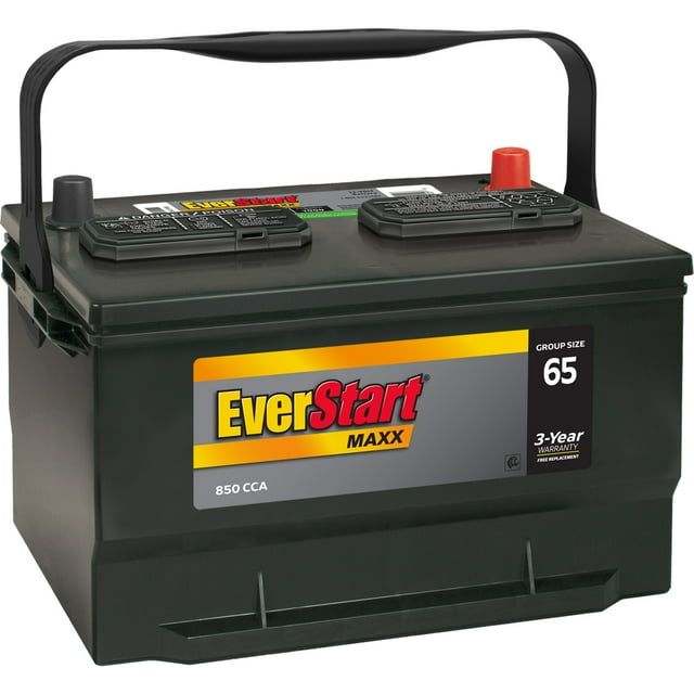

Its amazing how expensive batteries have become. I just replaced my two at the awesome cost of 450. 850 cca. They were long overdue. I am glad it didnt leave me stranded.
