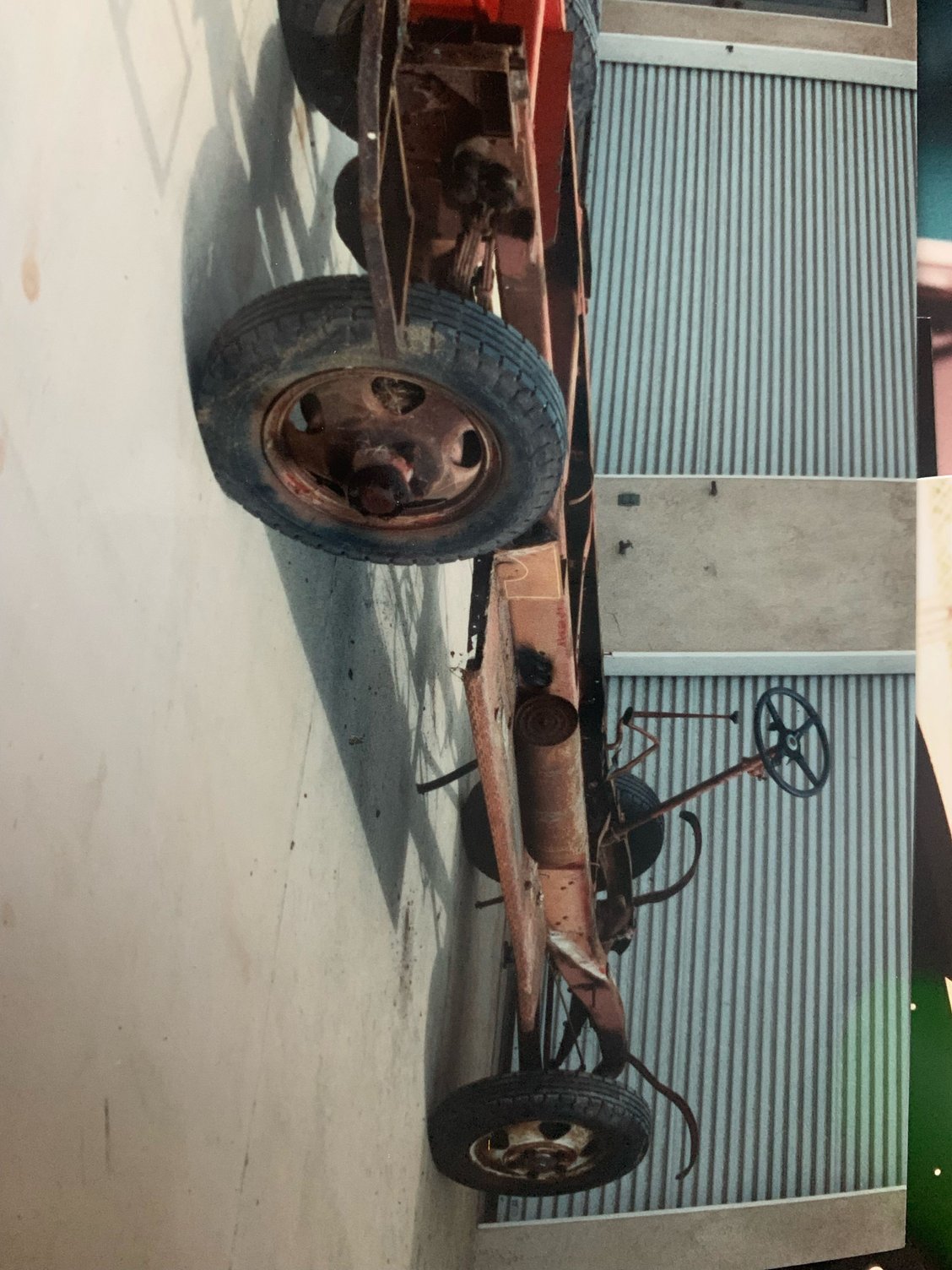

Welcome to FTE. Your 1932 BB looks to have been disassembled by the owner and likely now will be an ambitious restoration project. I too am trying to finish a project started by another owner. I can offer some help on its wheels but probably little else. Others here will help on the rest of the project. So, please explain why you need six wheels. Are the originals badly rusted, damaged, and unsaveable, or are you just wanting it to have safe modern wheels and new tires. If they aren’t damaged they can probably be kept in service. If damaged, finding OEM type replacements would take some searching but could over time be accomplished. If modern wheels and tires are the goal I think we can help there too with referrals to custom wheel builders. So please give us some guidance on what your goals are. Stu

hey Stu thank you for the insight. So the photo of the rolling chassis is 34 years old and since then the wheels have gone missing. The current owner of the vehicle has told me that if I am able to source the original wheels he will be willing to donate the vehicle back to my department. By finding the original wheels he says that we are willing to take the project seriously and is a show of good faith. Any help you may be able to provide is very very much appreciated.

Missing! That’s a hard problem to work around. So the first point to make is that I suspect you’ll have to gather replacements as they are found. Ford and Dodge trucks of the era had 20” wheels that had a 5 lug x 6 7/8” bolt pattern. This pattern was only used through 1933, maybe on some into 1934, meaning that more common later replacement wheels will be of no help. A few months ago a friend in WI contacted me asking about some of these wheels he bought at auction. I’ll email him after hitting send here to see if he still has them. All that I have now are the later 5 lug x 8” pattern so I’m no immediate direct help. I’d hope other forum members might speak up if they have wheels. I would also suggest joining the Ford Barn forum and Early Ford V8 Club forum and seeking help there. Last, wheels show up on CL commonly so check there as well. Stu

Daniel - I had a thought, which raises a question. Does the truck’s owner simply want to have the truck be able to roll, or does he want you to source a set of the correct wheels before letting go of it? If it is the latter then the search continues. If the former, you could as a stop gap find a military surplus supplier and buy a set of Power Wagon type wheels and tires. Military vehicles from WWII, Korea, and the following decades used 16” wheels having the 5 x 6 7/8” bolt pattern. These won’t clear your truck’s brake drums, but when mounted concave side out would at least allow the chassis to roll. Just a thought. Stu

That looks like a “honey hole” of spares. Even if the wheels on that truck cannot be used as original, their center discs can be remounted into new outer rims. I recently had a custom set of wheels built in this way by Custom and Commercial Wheel in Bloomington, CA. They did a very nice job and were priced fairly. Stu
