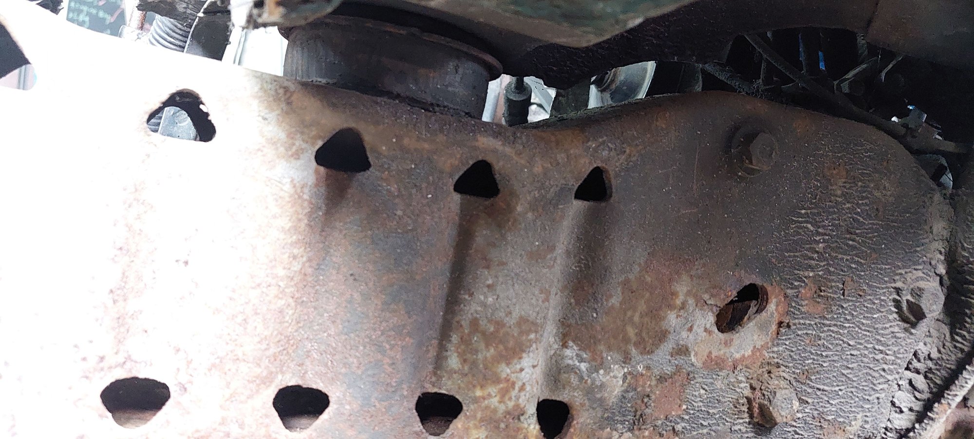

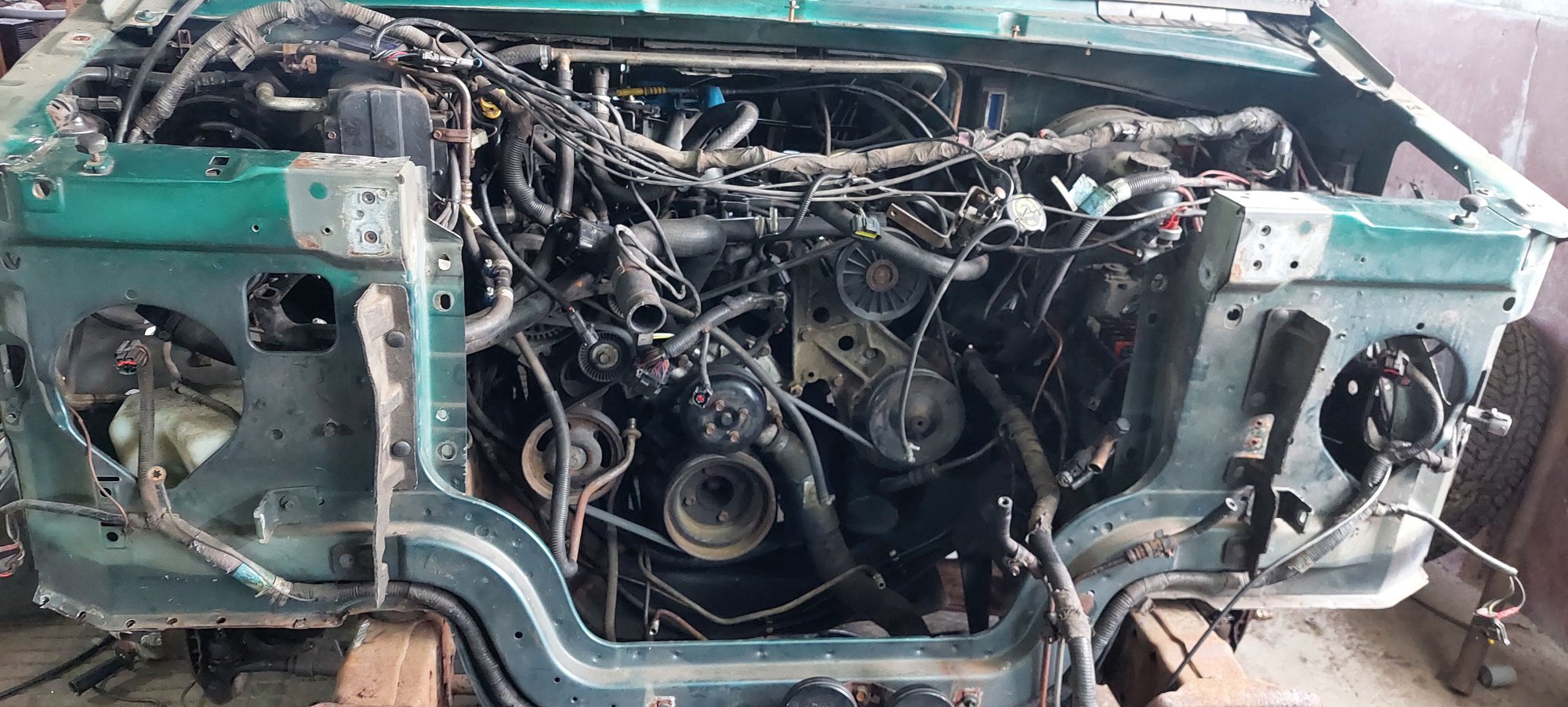

I made some pictures of the current situation and the core suport body mounts, hope they are viewable!
All of the body mounts are finally out now! Yippiee!
now its just a matter of disconnecting connectors, lines etc etc, making sure im not going to ruin anything while lifting off the body. If anyone has a list/step by step or any scrambled together ideas of what to delete or disconnect that would be very helpful.
Also, are there any specific points on the body i can lift it up from? And is it best to lift from the bottom or hoist from up top? I think lifting from bottom a little bit at a time is the safest, but pulling from up top seems more logical and easier to roll the chassis out from under there...

I would lift from the bottom. I can't see any way you don't create issues by lifting from the top somewhere. Get it on some big beams that allow the chassis to roll out and in, and make sure they don't want to fall over. I've seen folks do it with essentially super-duper extra wide sawhorses. Lift a little at a time until high enough then two boards under the body, then attach to sawhorse legs, then lower the body onto the sawhorses. This would need some extra triangulation on the sawhorses as well as a stable surface for all of it.
