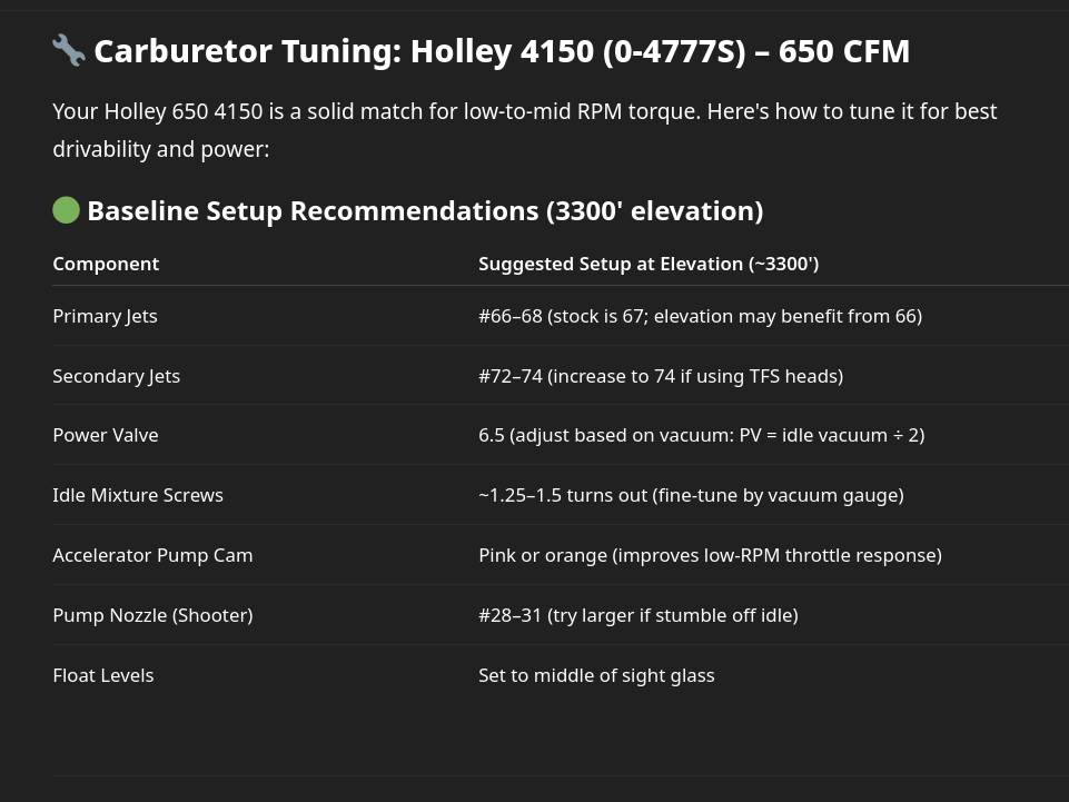

Originally Posted by KubotaOrange76
Interesting, flywheel hp seems low, can you ask "it" if its calculating sae gross?
@KubotaOrange76 I asked it about crank vs wheel HP when it gives estimated dyno readings, and was told it is estimated at crank numbers being provided.
Decided to re-run the numbers with a bigger cam and compare between rebuilt factory 2v heads and a set of trick-flow 195 heads with 72cc chambers. Tried to add a third comparison which would be my current build but hit my limit once again for creating the charts, was able to get some numbers though.
