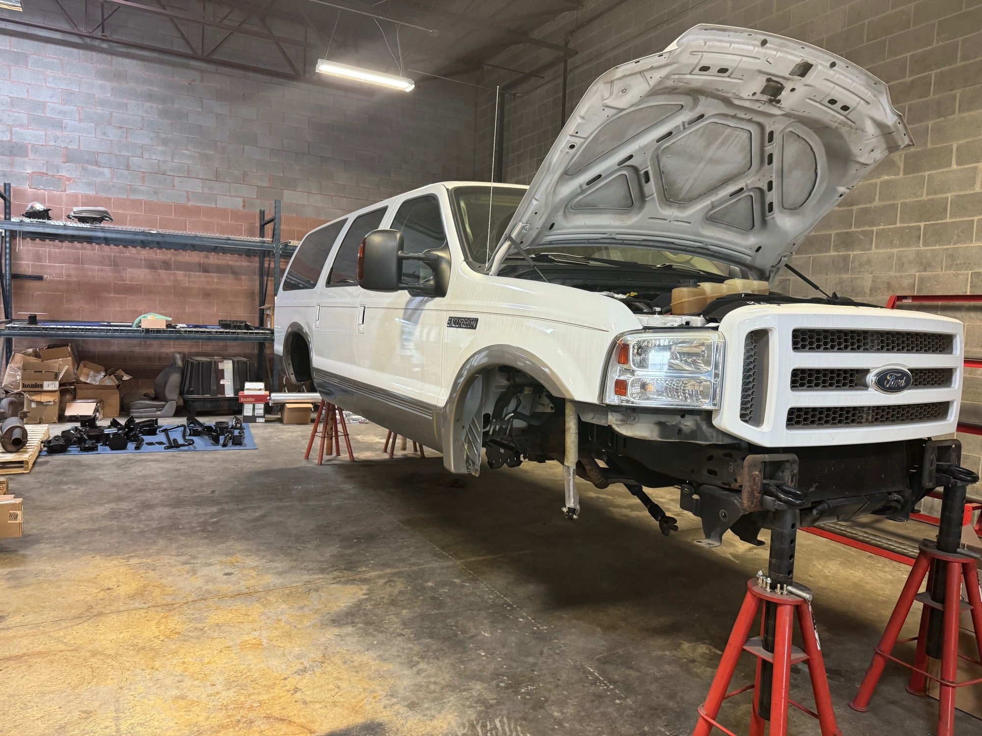

We all know a thread is worthless without a few pictures, so here’s the first of many more to come.

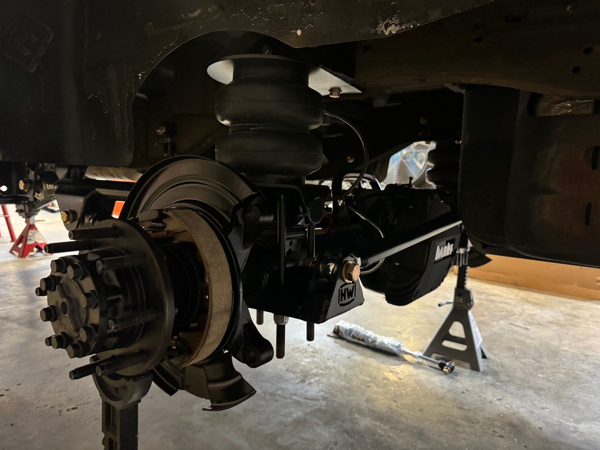

Old Jun 25, 2024 | 08:03 AM
I'mAllIn's Avatar
I'mAllIn
Joined: Jan 2010
Posts: 52
From: The 'Ham
Making progress. She'll be a roller later this week.

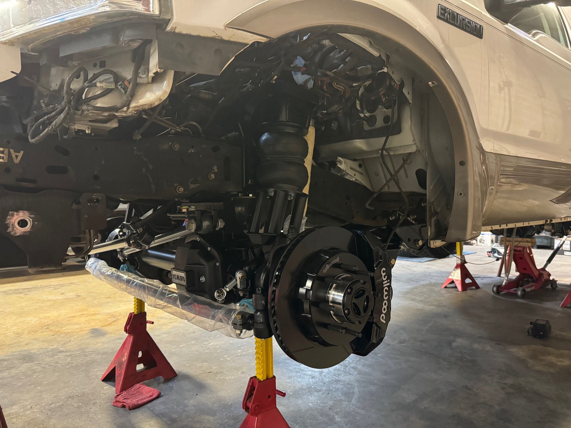

Old Jul 3, 2024 | 06:53 AM
I'mAllIn's Avatar
I'mAllIn
Joined: Jan 2010
Posts: 52
From: The 'Ham
Getting Closer
We should be rolling by the end of the week!
