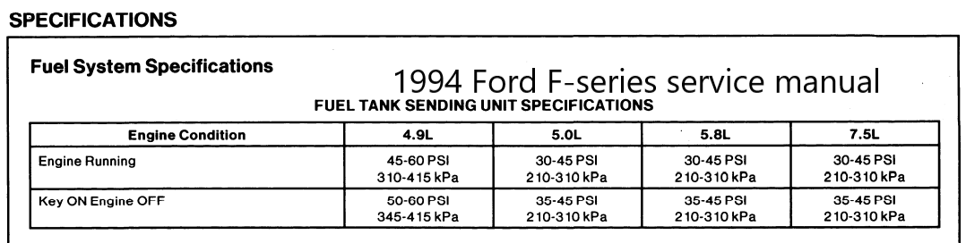

Your fuel pressure is too high IMO.

too high? From what I’m seeing it should be within 50-60 psi. If not please let me know what it should be

Your fuel pressure looks correct. Check your timing. It should be 8°btdc with the spout connector removed. And then remove your computer and open it up to look for leaking capacitors.

I thought 40-45 was normal?
