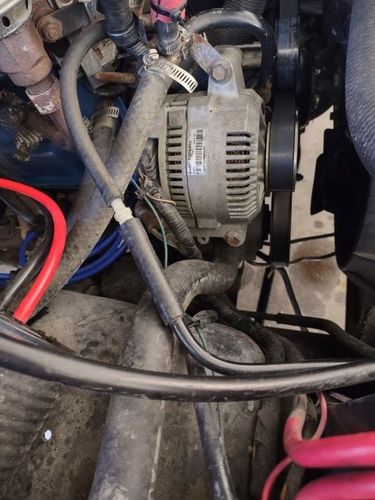

Do you have a pic of the current accessory drive? Around '93/4 the drive layout changed and I never recall the exact cut off.
My '88 302 has the Mustang style accessory drive, which is the '87-93 I guess. Anyway, I just ran the belt from the alt to the crank pulley. Length would not really help as I have an underdrive kit and a Saginaw. Stock was what, 91"? I think I had an 88" for a while then an 85", this is going back near 20 years of memory.

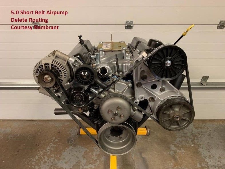

Here is a starting point:
Note: AC idler may not be same size as your compressor pulley.
You will have possibility of squeal at start up.
Additional tightening over that provided by tensioner can be increased with equal number of washers identical in size under alternator.

Hopefully these two pics will tell you what you need.

Scndsin: You have removed the air pump and I assume the related plumping. Must this be done or can I run the shorter belt with the pump in place?

You may be able to pull the pump pulley & run the short belt. but I've never seen it done.
